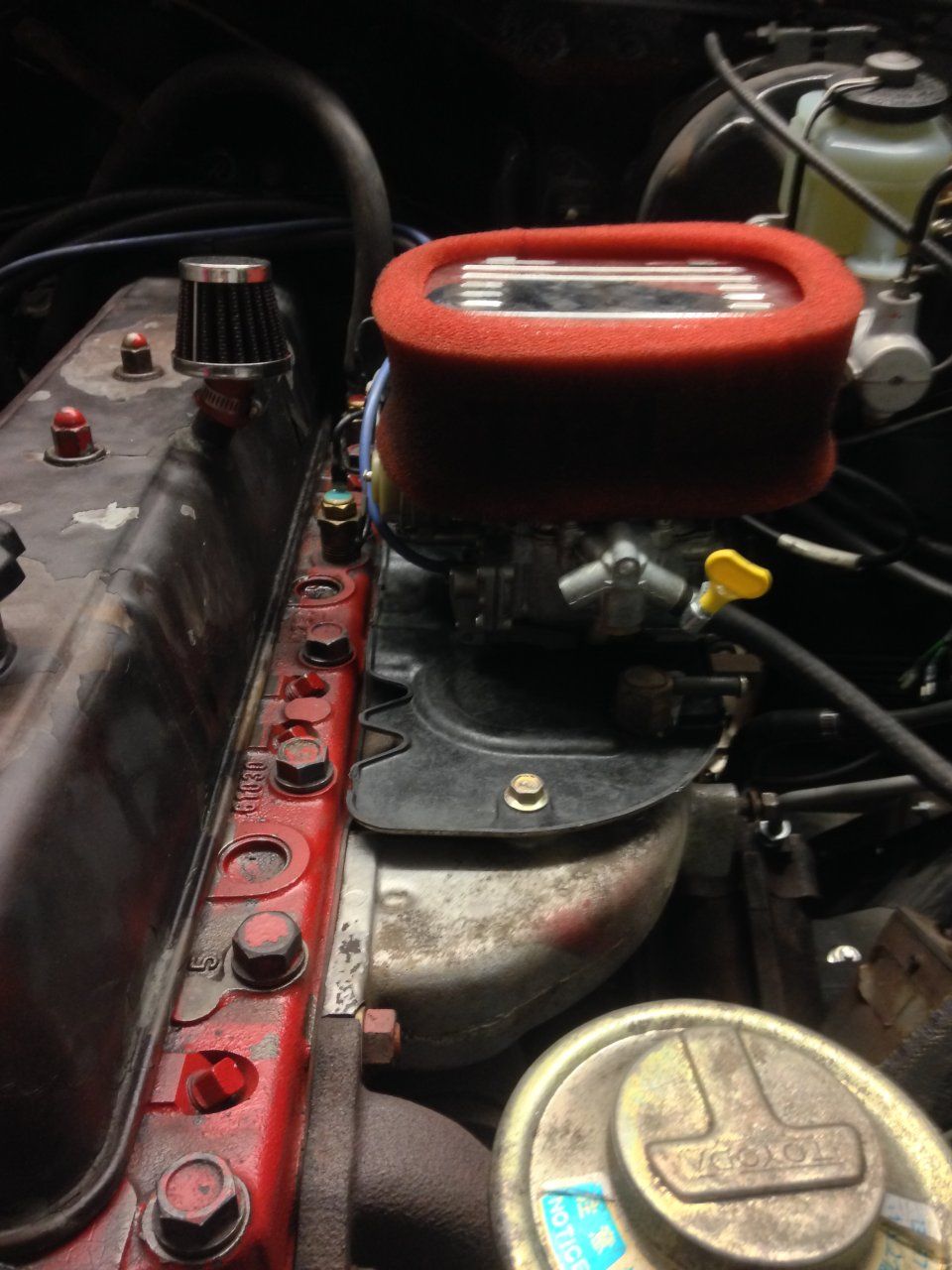

I have an import shop around the corner from me and while these guys don't specialize in FJ40s they have seen quite a few over the years. The owner thought it was fuel evaporating out of the Weber 38/38 I run. He said they have a small fuel bowl and heat from the manifold and header is making it evaporate.
He wanted me to wrap the header to abate heat.

fj4013. I think you are on the right track here as this would explain the relatively short thermal recovery time.
I run headers on my 79, stock carb with a carb heat shield. When I rebuilt my rig I added headers with the knowledge gleaned from these forums that it would add more heat in the engine compartment. I also added a o2 just downstream of the collector. What I learned from reading the o2 sensor as I drove was that I was running rich. As you described about the heat from the firewall being excessive I also found the same thing. But after much goofing around with timing and jets I got the mixture right and the heat was gone. In fact I had to wrap the headers at that point to keep the exhaust warm down to the o2. Hope you have long/skinny arms to wrap the the headers while they are on the rig. Also most people would tell you that wrapping the header unless they they are stainless will cause them to rust out quicker. Just saying if your assessment of excessive heat is the same as mine then your fuel is still burning in the header caused by either or both timing/rich jetting.

You’re probably correct in the electrical thing since there was a change. On the vapor lock issue, however, when one has an aftermarket carb, non-OEM fuel line routing, non-OEM fuel pump type, and modern fuel blends, Mr T’s Engineers are off the hook. My truck was living proof....
