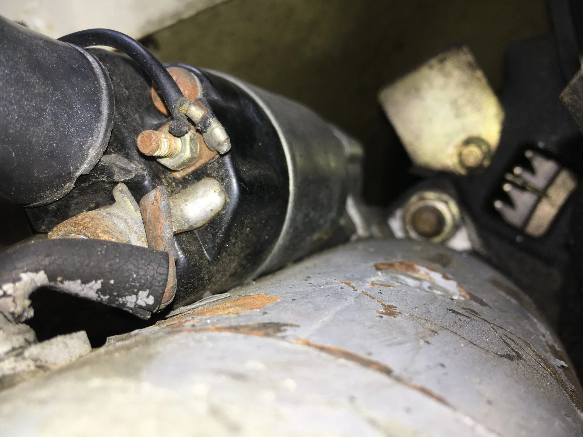

That wiring diagram helped. I totally missed that in the manual. I took some pictures of the starter. All connections "seem" fine but the black wire connecting to the solenoid is really difficult to actually see so I got as close as I could with my camera to take a picture and it looks like the black wire is slightly melted at the connection point and the internal wires are corroded slightly. Would this be the culprit?
Pretty sure that is the ground wire circled in red. Follow it to the frame and make sure it is clean and tight. What about the small wire and the one under the boot?
I tried following those but it's impossible unless I cut open the wrapper the PO used to consolidate wiring. They go into a junction which is wrapped as well and it splits off into 2 different directions and I cannot follow any wires. I have no idea where they lead to. I followed the diagram but again without being able to see the the wires I have no idea of where they lead.
Pretty sure the ground is on the passenger frame rail make sure it is tight and clean it will be the same size wire as on the starter. Pull back the rubber boot on the starter and check that wire, it is hot so dont ground it or it will spark. Did you check the small wire on the starter?
The starter solenoid should have 2 small wires coming out of it. 1 goes to the ignition switch, the other goes to the igniter or the coil. The wrong solenoid will cause problems. My friend had a 78 FJ40 he replaced the starter with a non Toyota part it had a typical 1 wire solenoid. His cruiser would not run. We finally replaced the solenoid with a 2 wire one and the truck started up and ran great.
