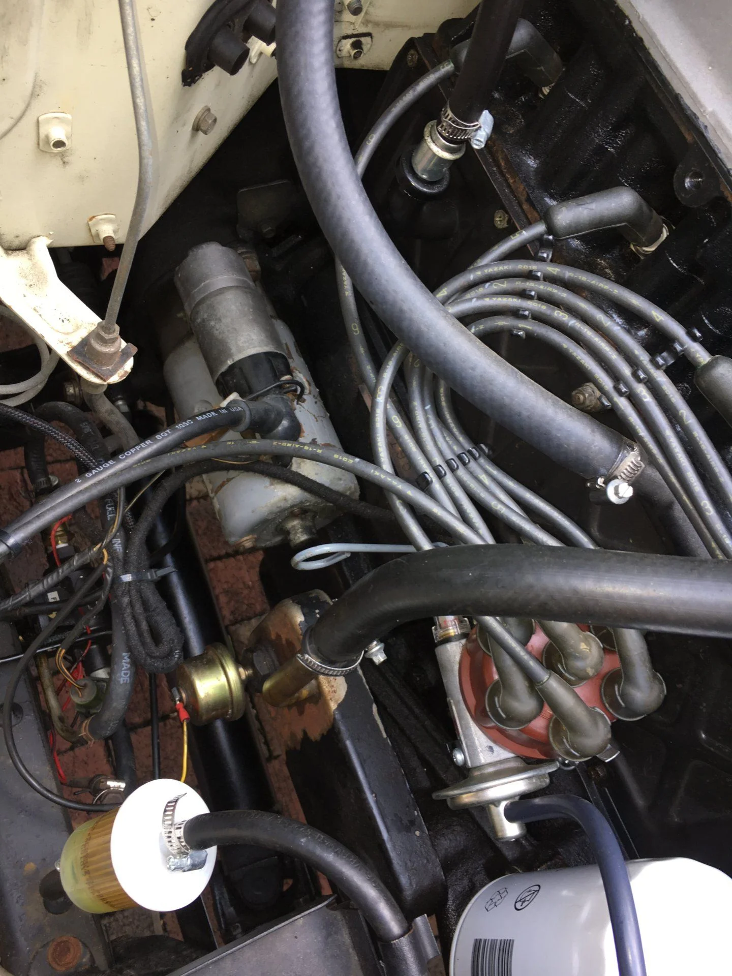

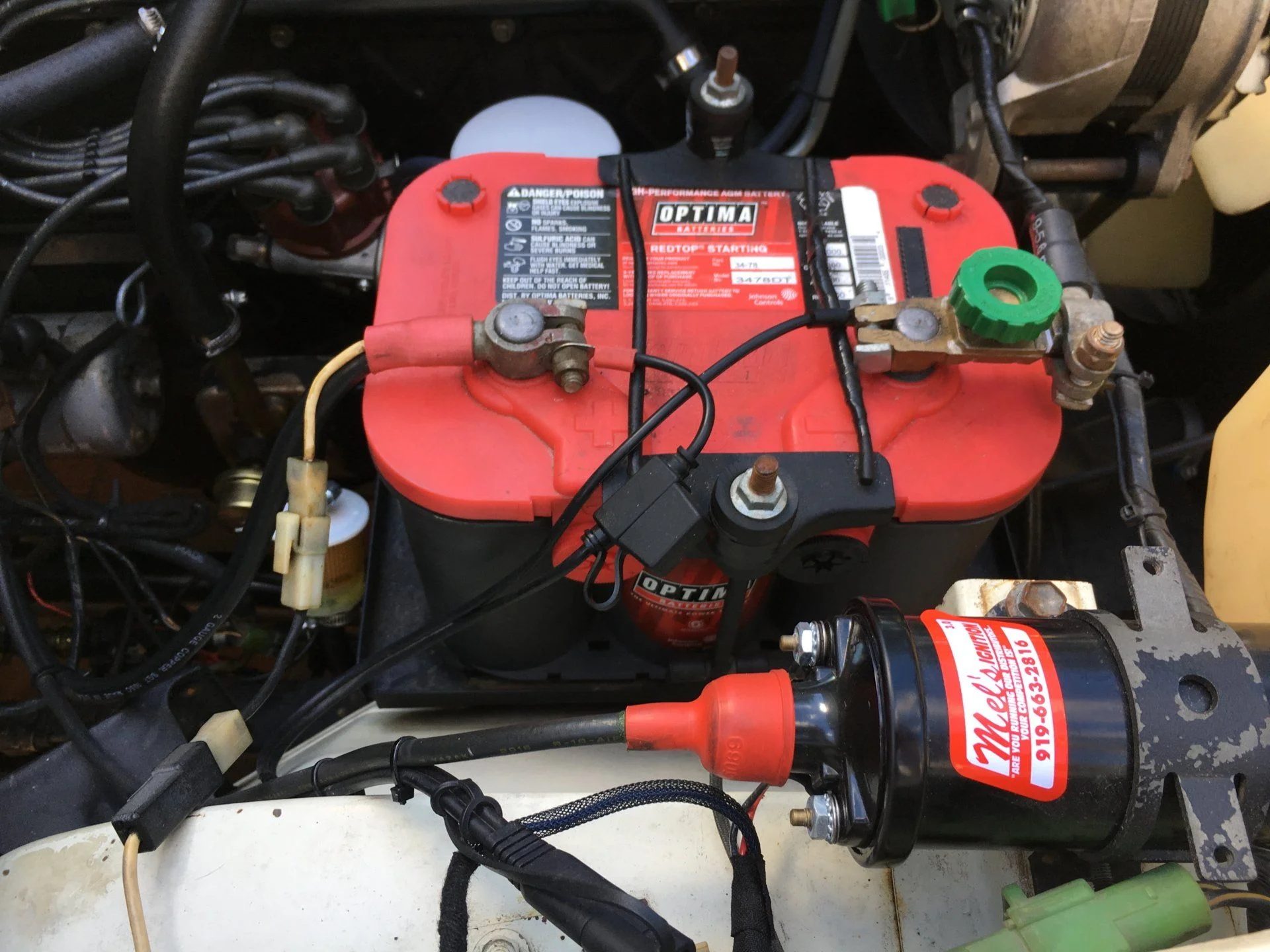

It's hard to know what is wired to my coil as all of the wires are bundled and wrapped in a protective tape beginning at the starter then going to a junction and splitting off in 2 directions. It is impossible for me to follow the wires without cutting open the protective wrapping. Impossible to see in the pics below too. I guess I should open up that protective wrapper and see where all these wires lead.
What type of ignition system do you have?
View attachment 1783687 View attachment 1783688

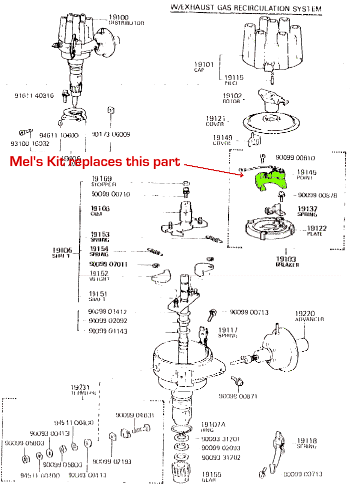

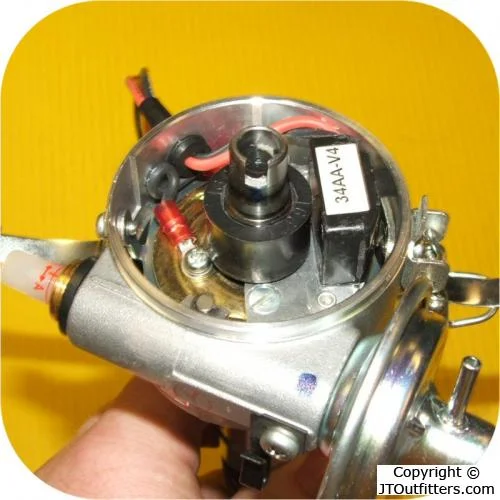

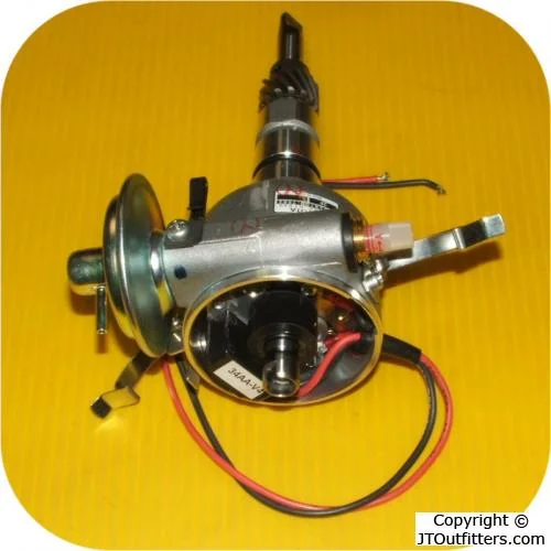

This is the exact dizzy and ignition system I have:
Complete Mel's Electronic Non-USA Distributor - JTOutfitters
EDIT: The ignition system is a Pertronix that JT Outfitters makes a modification to. Here is the schematic of what mod they make:
Mel's Electronic Ignition Conversion Kit - JTOutfitters

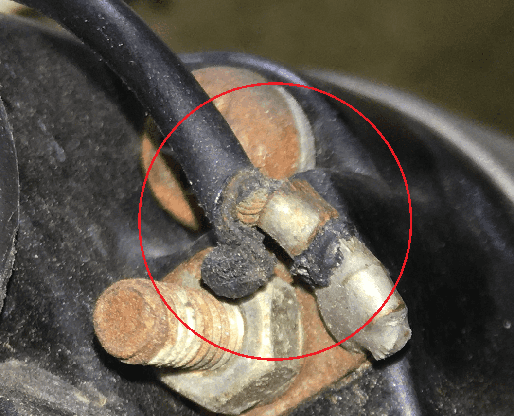

How close does the Ignition Coil wire with the bad insulation on your starter's Pull In Coil come to that other bolt head in the picture? Is it possible it is grounding out on the other case bolt which might be ground? That would kill the voltage to your coil, and might explain why your engine shuts down. If it looks like it could touch, you might want to clean up that insulation issue and see if your problem goes away.
This wire? I cannot actually get close enough to see visually because of the awkward angle it is located and how deep in the engine bay it is but I can feel it is very close to touching. That photo is from me reaching all the way down at a really weird angle and getting a decent picture. Now that you mention it looks as if the curve in the wire is actually caused by the bolt under it pushing against the wire.
It looks to me as if it has melted away over time. You can see in the pic where it is curled up from heat versus cracking from age.
Pretty sure that is the ground wire circled in red. Follow it to the frame and make sure it is clean and tight. What about the small wire and the one under the boot?
No, that is NOT ground. That wire is Battery Voltage when the Starter's Pull in Coil is energized by the ignition switch. It connects to the coil and helps to energize the coil quickly during starts depending on which ignition system you have.
Yes, that is the suspect wire connection. Given the possibility it can short out, I suspect you are grounding out your ignition coil to the Starter's case thus killing your ignition power to the Dissy. That would explain why it shuts down, and why the wire looks melted. The only remaining issue is why does it take time to happen after it heats up, unless thermal expansion is how the wire and bolt head touch, or get close enough to arc.
You might want to fix that and see if it resolves your issue. Also research your Non-USA Dissy's electrical schematic and determine if that coil wire is needed or not. My 2F book says for USA only, so if you are running a non-USA Dissy, maybe it isn't needed and is the source of your problem. Just DON'T connect it to ground. That wire is energized while the starter is engaged. When running, it is a potential coil short path to ground with the bad insulation connection.
It would also make sense to trace that wire to see where it actually goes. If it goes to the "+" terminal of your coil, then that is a potential short path after startup.
Thermal expansion would completely explain it. If they are that close to each other all I need is some engine heat to make it expand just enough to arc.
