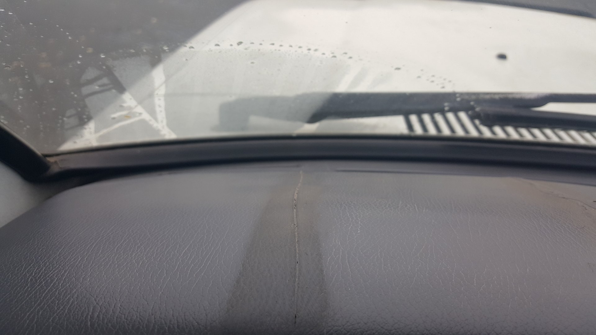

@LINUS what kind of caulk did you use? Name and color or link? This ghetto fix sounds right up my alley :o
@LINUS what kind of caulk did you use? Name and color or link? This ghetto fix sounds right up my alley :eek:
So......
My local Ace knows me & I walked ~4 paint samples out before I got what I think was GE (yes, General Electric brand) - tube sealant was the fancy toothpaste cap / cone style & was gold & blue ~4oz tube.
Small town shyt - I literally went to HS with the local Ace owner & he knows me - plus I sold the 450 before I ever bought the 40th AE I traded in close to 4yrs back. ( so say 2015 )
It was a dark tan color....latex caulk is super easy there in colors.
If any of you shop a small town shop, tell them you want to walk a couple colors out & decide.
Sorry no easy Lamazon link, but your local Ace Hardware has what I did & looked enough you never would notice if I didn’t point it out.
rtv gray works
I just searched for marine vinyl on amazon. 95 to 97 dash would be more difficult I would think.
Yep, some of the angles on the 95-97 dash look complicated for an amateur which is why i opted to just pony up the cash for a new one from Mr. T.
My 94 looks straightforward and is the same as what @White Stripe showed earlier in the thread.
Mine spent 27 years in the baking heat and as far as i know there was never a sunshield in use. Then in January i head out to Roswell for work and experience uber cold temps -12°C. Windows wouldn't go up, hood wouldn't stay up, tail wouldn't stay up and my dash cracked. Cold weather sucks....:(

I recovered mine myself. It had very mild cracks. It's marine vinyl so should stand up to the sun.
It's been installed a year now and still looks the same. Watched some youtube on it, bought the materials, and took my time. I think it only cost like 150.00 in materials.
Hi ! I've just ordered a used dash from yahoo japan auction, i am planning to refursbish that Dash then swap mine. Is that vinyl Grade Faux-leather ? Do you have a link to the product you had purchased ?
Its just marine grade vinyl that they use on boat seats/cockpit. Its supposed to be made for sun exposure. I used whatever Amazon had that had good reviews.

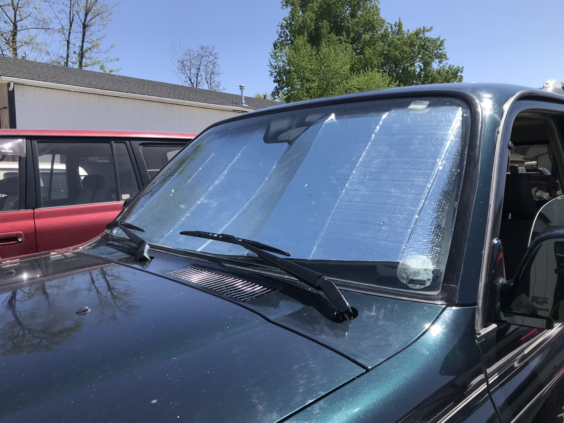

With winter coming this thread is just in time. The dash pads can also crack due to cold weather. Mine cracked several years ago after we had a week of somewhat cold weather (lows in the teens). For years I applied 303 Protectant at the beginning of summer but in the end, age won out.
I installed the Escape Gear dash cover last year and absolutely love it. I thought the pockets would be useless but we actually stuff them with gear on every camping trip. Highly recommended and you don't have to stare at the cracked dash.
