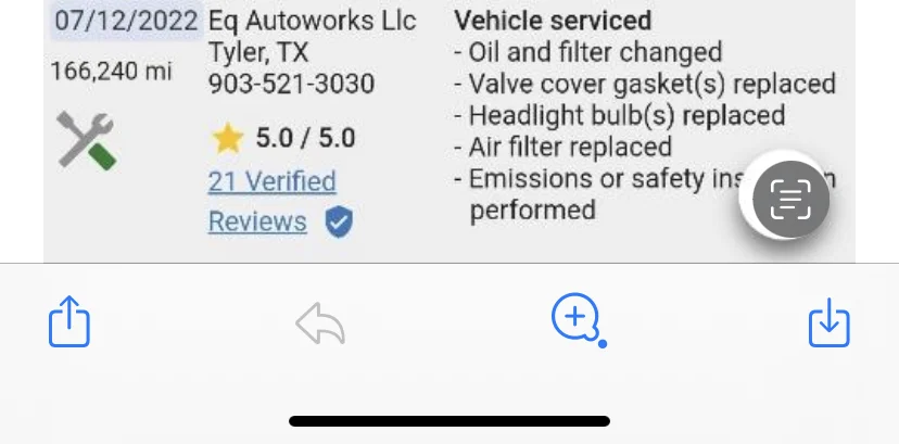

The above is the work that was done by EQ in mid July 22. The below is what I got after I took it to Toyota for a PPE. It was what I got about 3k miles and 5 months after the EQ work was done. Could this have happened in 5 months/3k miles?
Yeah, I know the stealership is ridiculous on parts and labor cost. But the fact that a Toyota Master Tech missed all of the stuff listed by the PPE, after the service they did, I'm convinced they couldn't have missed all the issues and that the seller hid things.
Can a Toyota Master Tech miss all of this other stuff based on the service they did? I guess that's my question.
based on the date it should have, or was at least on schedule. Do you think the shop missed it, or that the seller concealed it?

the carfax only recorded the service item done by the time, most likely the PO might deny quite a lot of service items at the time, esp. if he/she decided to sell the car soon.
also if you ask recommended service items, the shop tends to give you quite a lot of items to service, some time it is not based on the inspection but based on your truck age. I dont think your inspection shop was even bothered to open the valve cover to check the status nor they saw leakage over there. they just thought it *should* change at this age of the vehicle.

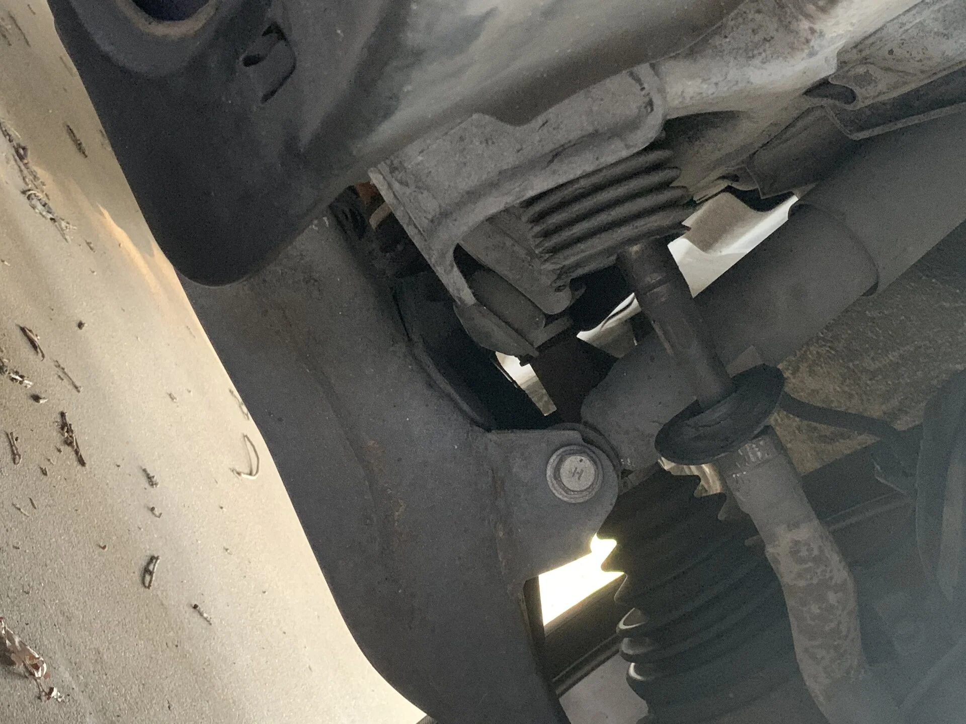

no worries, a lot of those services look to be a bit high on the price. i would want to know why they were looking to replace the rack, it looks like new boots were installed and the old ones werent removed. 2900 for vcg is an absolutely asinine price for the job, unless their actually replacing the valve covers themselves. i would go and get a second opinion with those prices

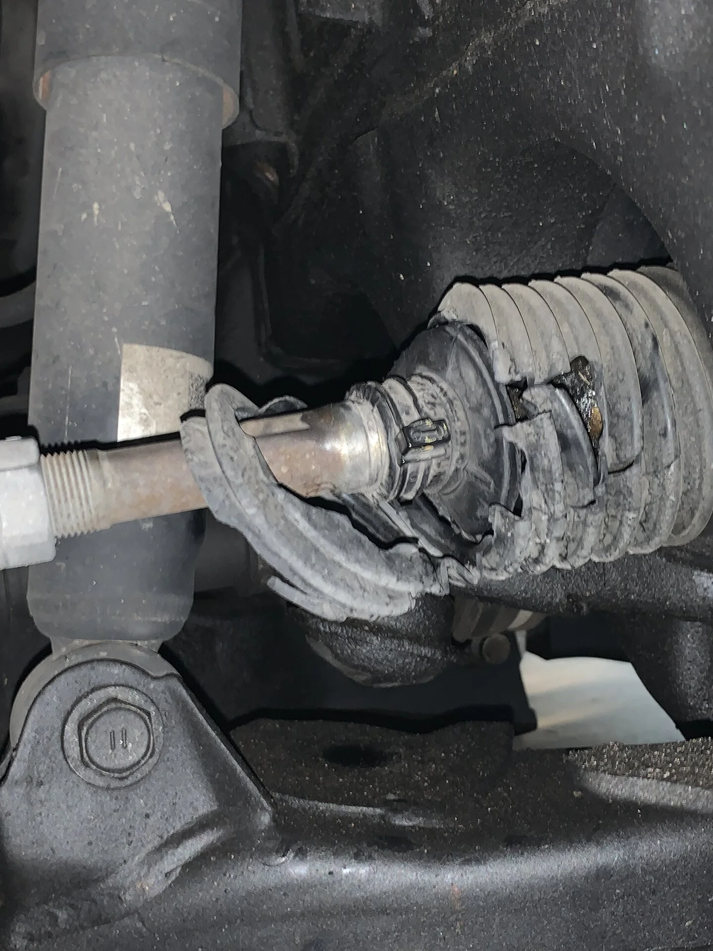

Pretty sure they wanted to replace the rack because of the bellows being torn in pieces, the PS fluid leak, and not knowing if there were problems with the inner/outer tie-rods.
boots, lines and tie rod ends can all be replaced no need for a rack replacement. if its actually leaking from the rack around the pinion or the lines that are on the rack then that would warrant a replacement

The previous work performed by EQ may have been quoted for more repairs but limited to whatever the PO approved them to do-

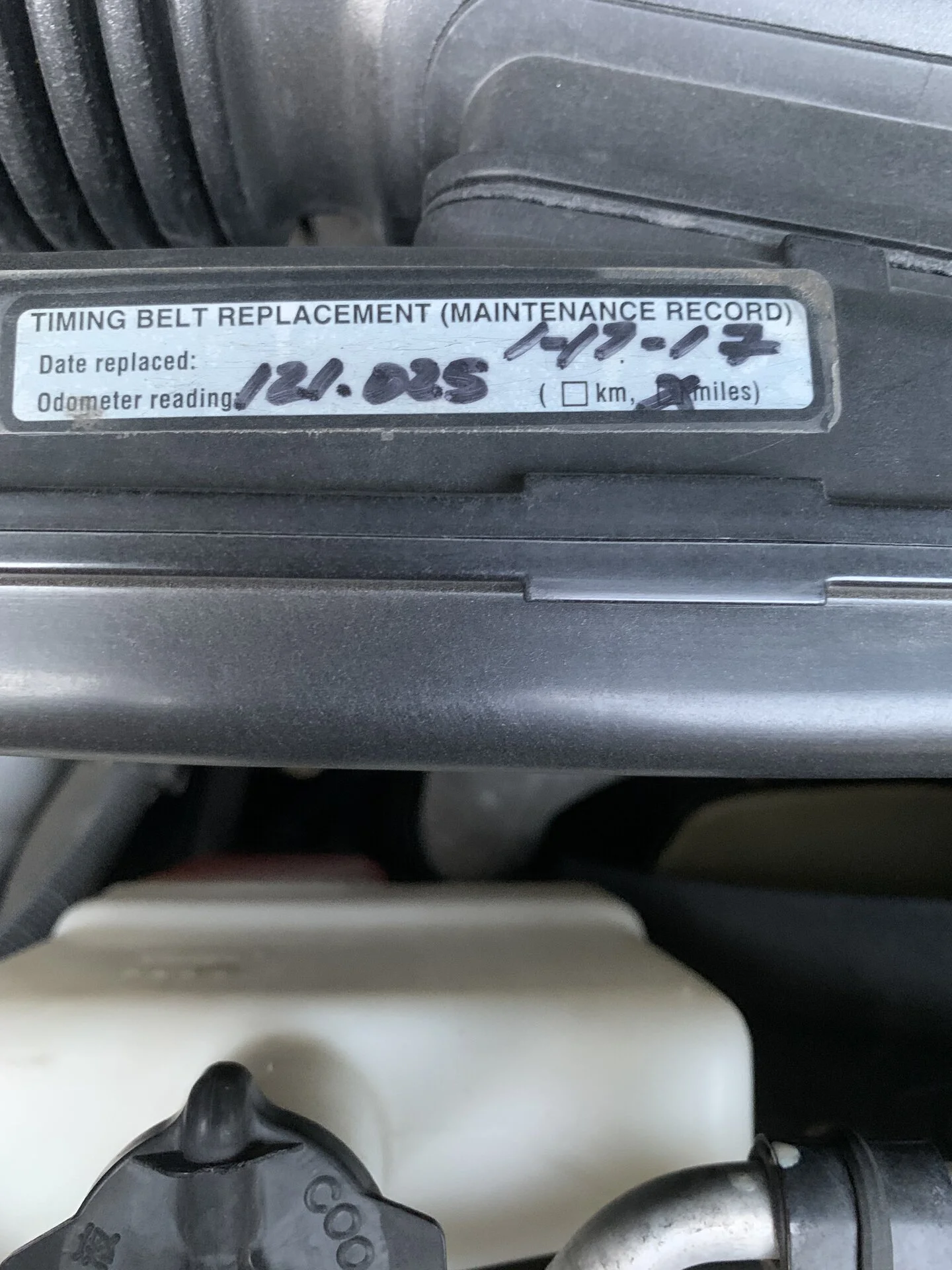

I also don’t think many people familiar with this engine would spend their own money to replace a 6 year old 50k timing belt.
