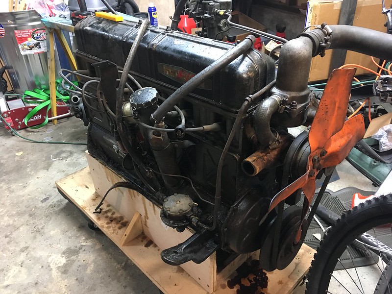

Well that I cannot say for sure. One engine is from 1964, the other 1966. Only have a sample size of 2, but they were both the same. :)
1966 engine
1964 engine:
1966 engine
1964 engine:

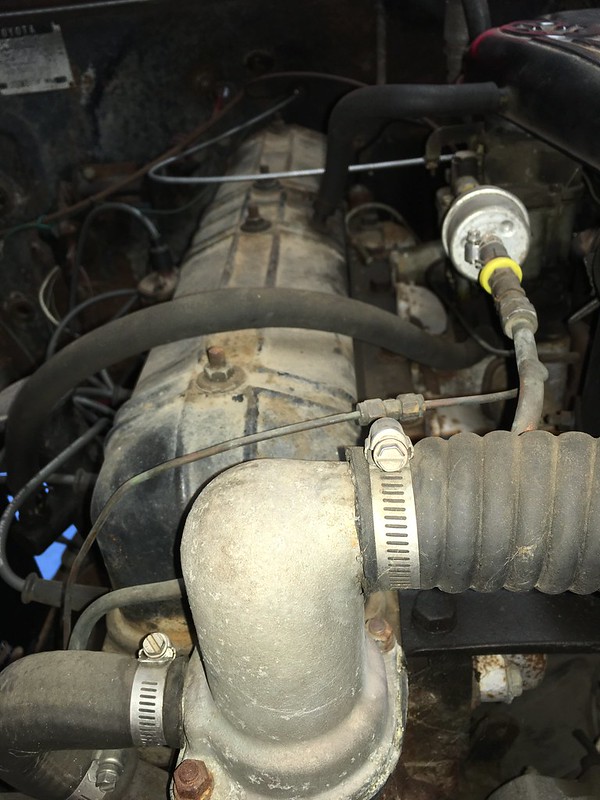

My 4/73 F155 had the capped nuts. However, they had been tightened down so many times to try and cure the leaking cork that a couple had actually started to crack the cap part off. I would be leery of a short capped nut, unless used in a double nut settup, probably not enough thread to get the gasket tight. The fix was an early 2F aluminum cover and its matching nuts sold to me by Merl in Salida in 1997.
