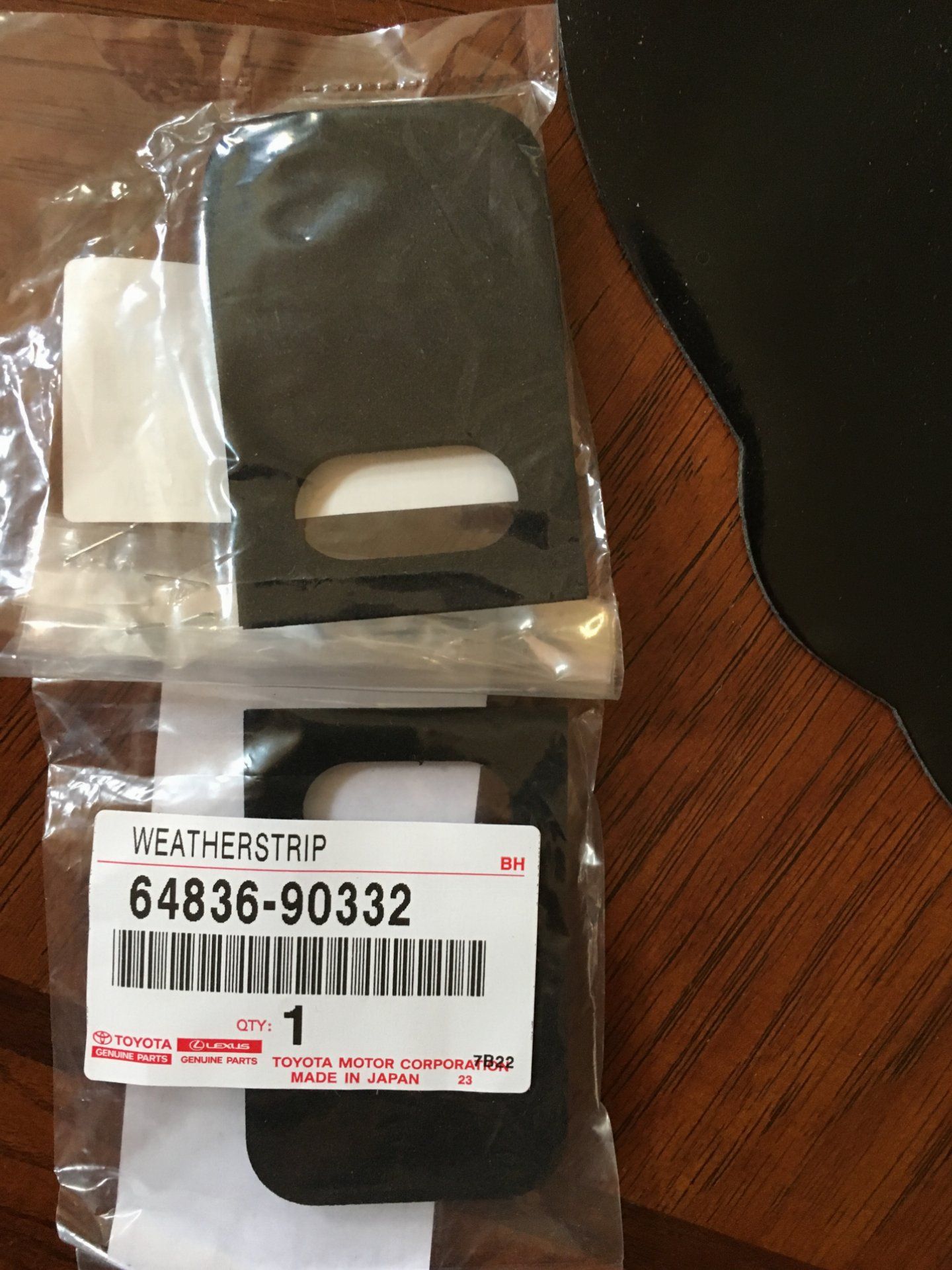

These pieces supposedly mount between the fiberglass top and the front corners where top of windshield frame meets side bows above doors-is that correct? Can someone post up a pic of where these should go?? Putting on top for first time. Thanks!

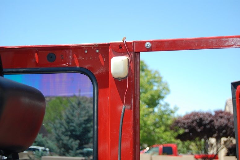

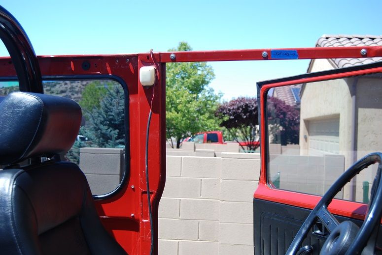

Ok so I have most of hardtop on except fiberglass top. My question is what is the correct routing for the wire running from the dome light? Does it run thru the bows above the door or up above the frame for the fiberglass top??? I have some pics...............

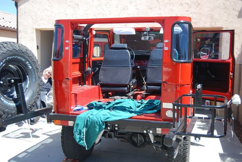

Ready for fiberglass top
Looking good! I would suggest making sure all the top threads are chased, and cleaned out. Maybe even a dab of anti seize for the next guy. I would leave the side and door frame bolts a little loose to give some freedom when lining up the fiberglass roof. Get everything started before you torque them down.

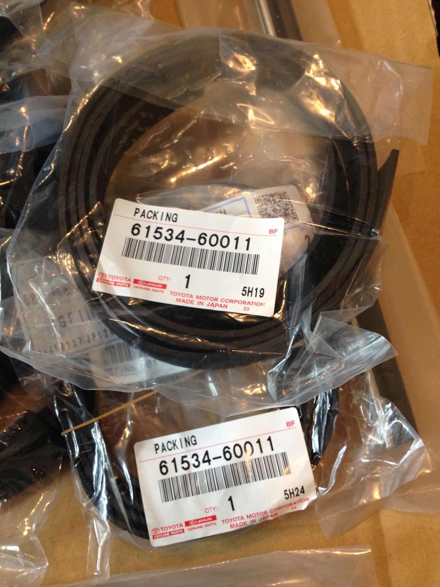

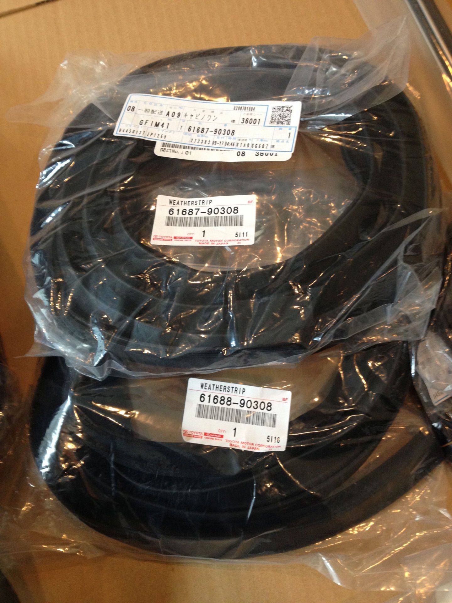

@emac yes already chased threads and am planning on the never seize as well. Toughest part so far was getting top rear bow between sides to line up holes for the bolts that screw down into the tops of both side panels........................New OEM gaskets everywhere. A few wrinkles in my headliner, once they are out from baking in the sun I will install the Cruiser Corps headliner as per @overton
Incidentally my rig rides nicer with the extra top weight on;)
