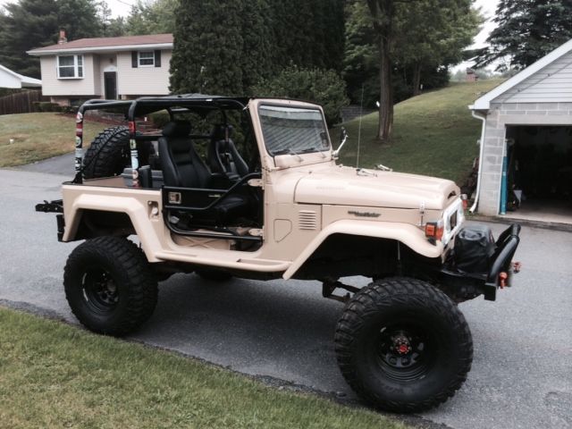

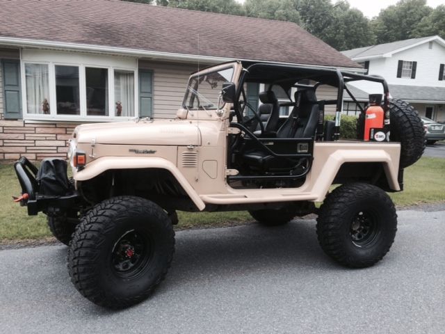

Factory hardtop-to-top of tub seals are one piece. Of course they're pricey. The ones from CCOT are two piece and what I use. I like 'em a lot, they stay in place when the top is off. I've used them both and prefer CCOT's. You can see the piece that goes on the top of the lip on the attached photos.

@jim land that is incredibly helpful, and thanks SO much; very nice rig you have there BTW!!!
Ok got it, so next question. I plan on using OEM wherever possible, but know not all are available; so, who do you like for seals?? BTW thanks for the pics that really helps!

OEM is two pieces at least was when these were new. One on the lip that was very much like the one used on the top of the windshield. Wasn't designed to stay on when the top was off. The other piece was flat and covered area the top bolted down.
So it sounds like if I use OEM seal there I only need one? But two if aftermarket? Or will all OEM there are two different seals on that rail?

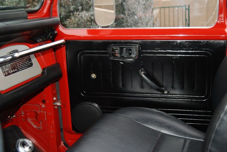

Doors first.................
Door pins from Cruiser Corps were too short but the white donuts were perfect; decided to go with these from cruiserparts.net
Front Door Limiter Bolt Set 1/75-1984 FJ40/FJ45 [G-16] - $8.99 : CruiserParts.net, Toyota Landcruiser Parts
For my '77, there are two seals on the tub rail.
Right: 61534-60011 (flat part) & 61687-90301 (top edge)
Left: 61534-60011 (flat part) & 61688-90301 (top edge)
