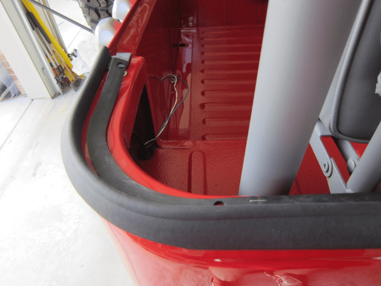

I have no doors on rig right now so they may go on first for a bit-then can follow that sequence when it all goes on. It is confusing to me how many seals go between top of tub and sides. SOR shows two seals run along that rail on both sides???? The Toyota fische shows one on each side, anyone have an opinion on this?
There are 2 pieces. See pic below.
So cruisercorps shows an inner side panel seal and side panel seal, so in other words two seals along the top of each upper rail on the tub? Is this correct? I am getting all new seals for this install.
Ok got it, so next question. I plan on using OEM wherever possible, but know not all are available; so, who do you like for seals?? BTW thanks for the pics that really helps!
