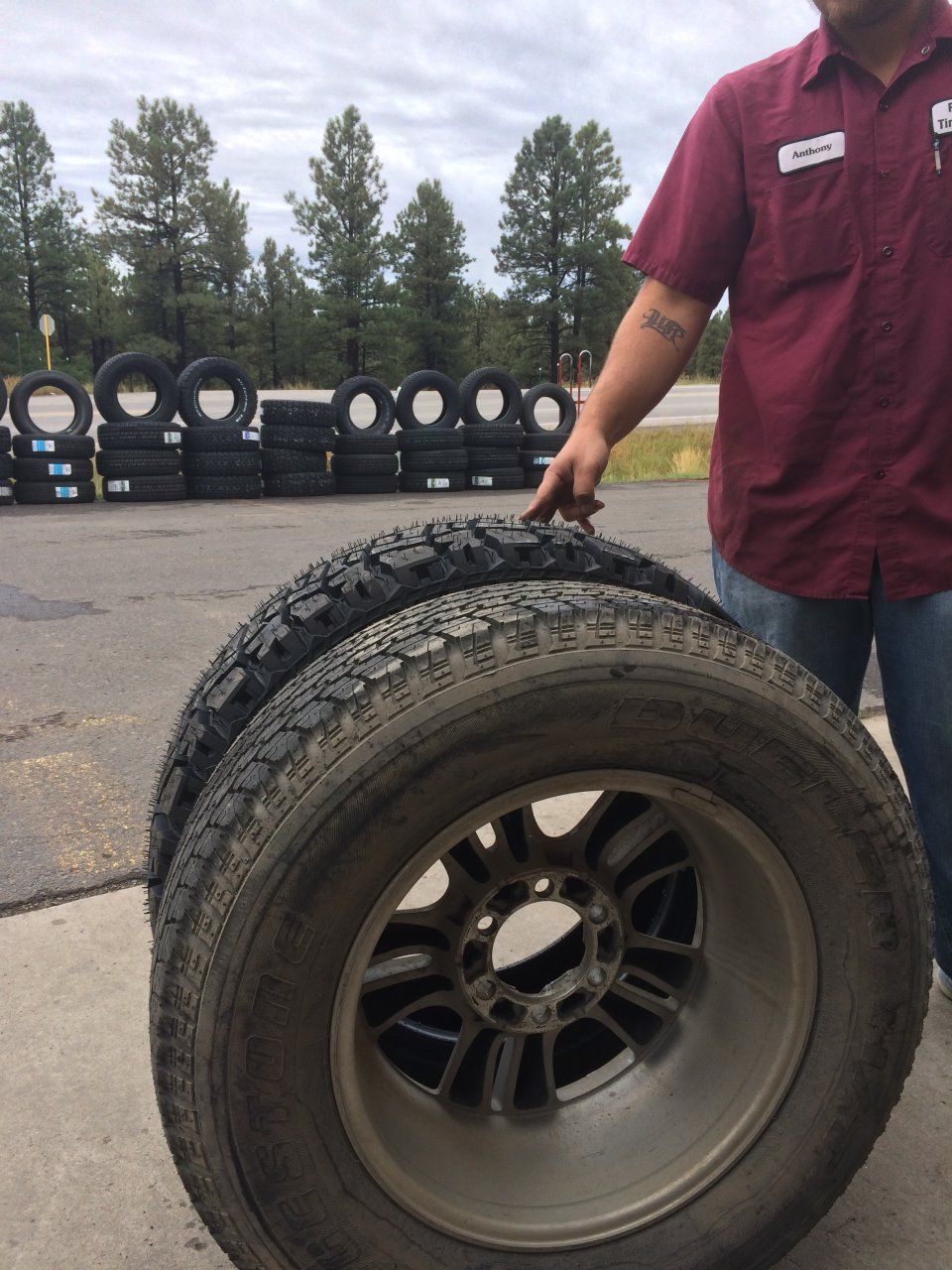

tires will be ordered Monday or Tuesday, decide to get either Cooper ST Maxx or Dick Cepek Fun County (had FCII on a 87 Toyota pickup and loved them & tire rack has a great price on them) in a 265/70/17. Both tires are 3ply side wall and 10 ply tread and both are made by Cooper Tires. Both are a bit large for a 265/70/17 measuring out at 32" tall and 10.7" wide. thought about the 255/75/17 (31.7"x10.2) or 255/80/17 (33" x 10.2") and those are still an option if I get the Cooper's, but there is not a big difference in sizes.

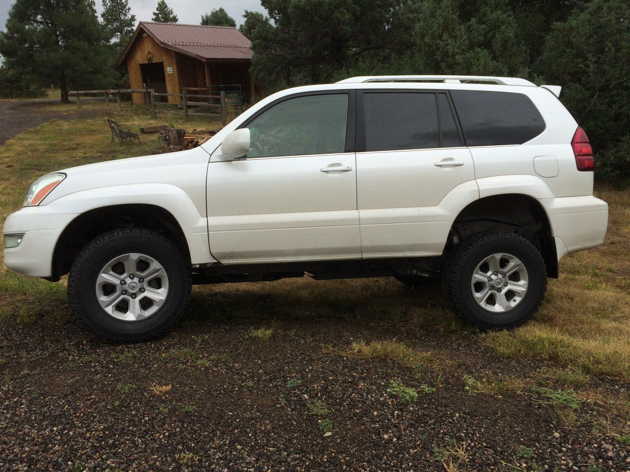

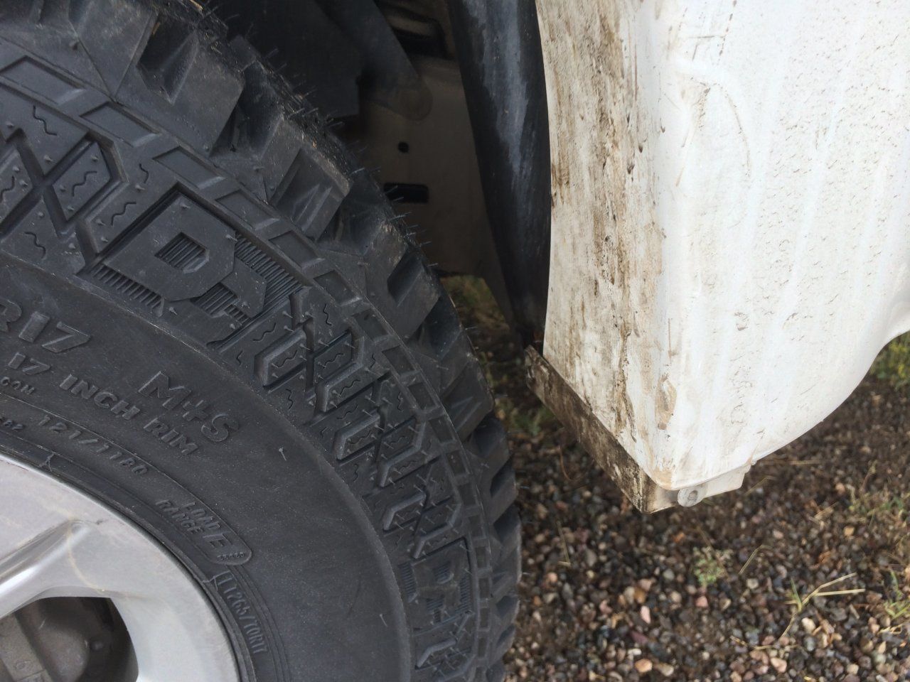

Tires going on, a little bigger than the 265/70/17 on there and they do rub the running boards
Both tires are 265/70/17
Removing the running boards are easy, the hard part is the 10 clips on each side, the trick is to get behind the part you see and push in from both sides and pull. I broke 3 and after finding the trick, no more broke.

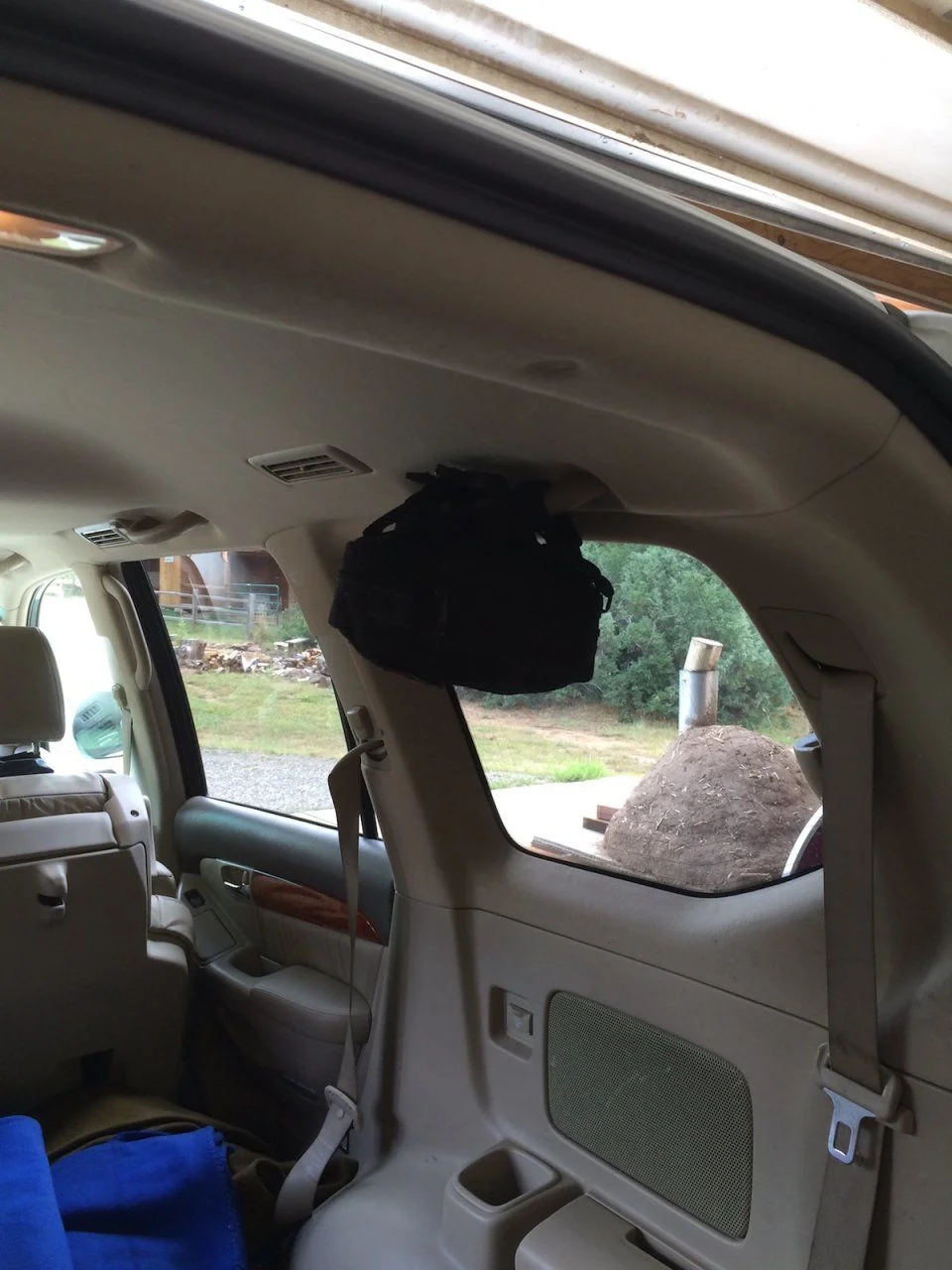

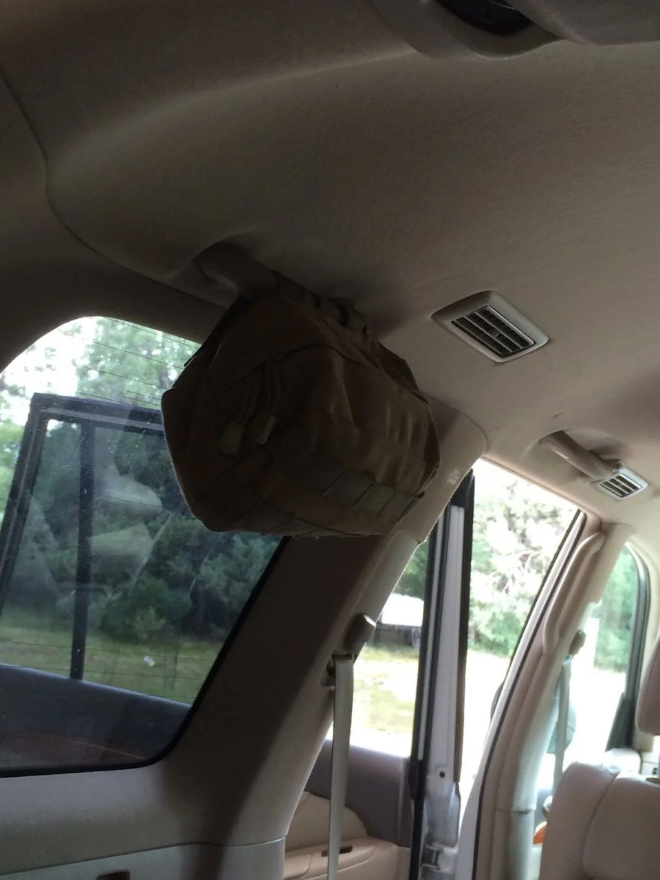

mounted a first aid kit and tire repair kit to the rear grab handles

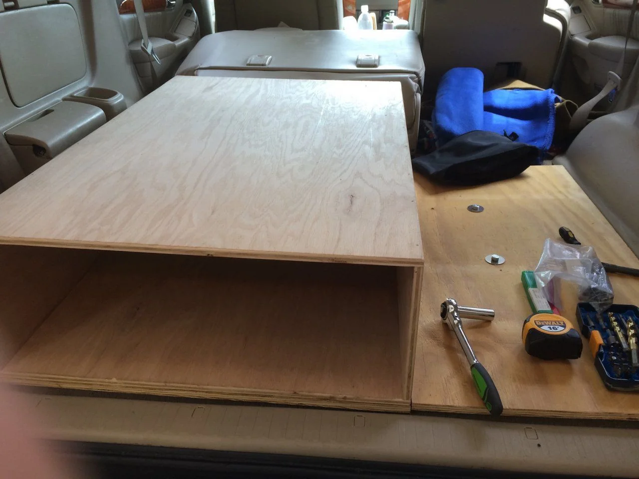

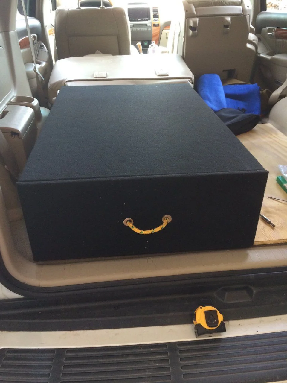

also mounted my left rear draw and covered it with a cloth material
