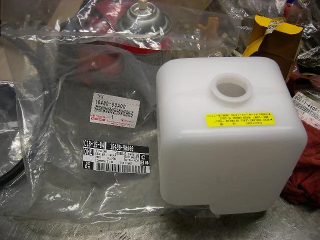

The new OEM pieces and part numbers:

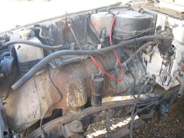

This shot shows my limited space for overflow in the Pig...

I cannot see why it would not work/fit in your application as the 60 series bottle is smaller than what you currently are using for an overflow container.
60/62 same part for tank/bracket....
The cap will need a longer hose....no big deal

i just got my setup from Toyota today.. the bottle size is 5.5"x4.5" x6.5"tall .. hopefully that makes sense..

So is the 5.5" side the side that mounts on the bracket?
