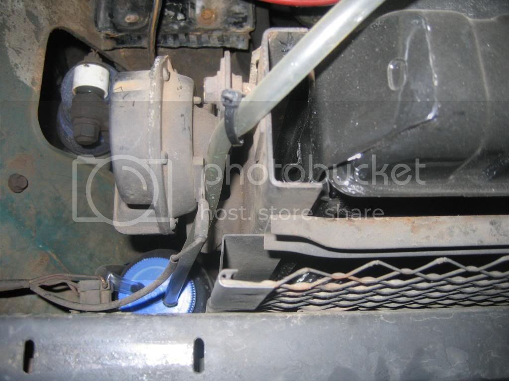

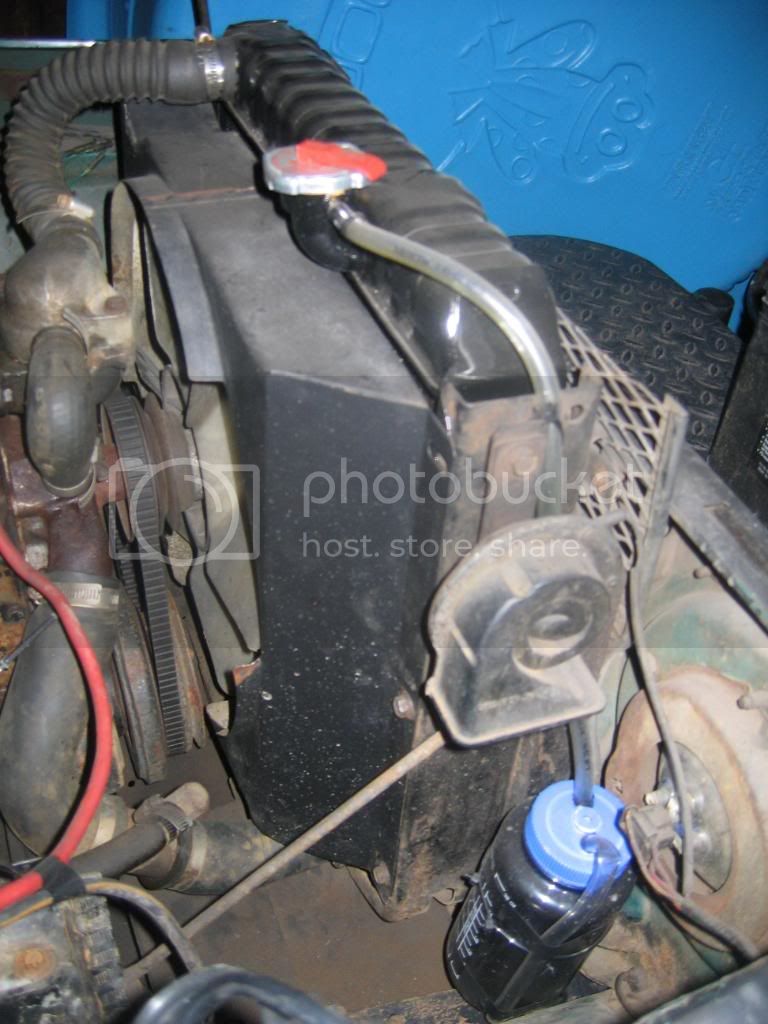

I used a quart nalgene bottle w/ holes drilled in the cap. It adds mad style
LMAO ROLF :lol::lol::lol: Dude, you gotta post up a pic of that.

Didn't have the same mounting holes to line up the bracket right, so I drilled. I think it should work fine.
