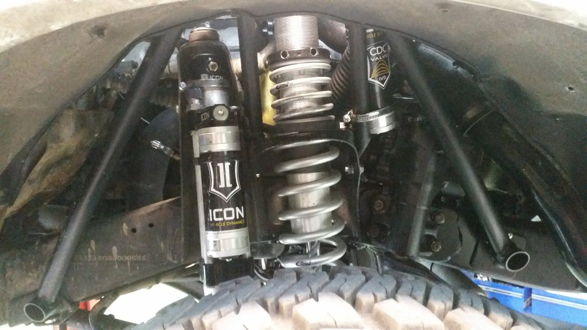

this is the setup I'm drooling over. Stage6 Slinky with coilovers/bypasses.
