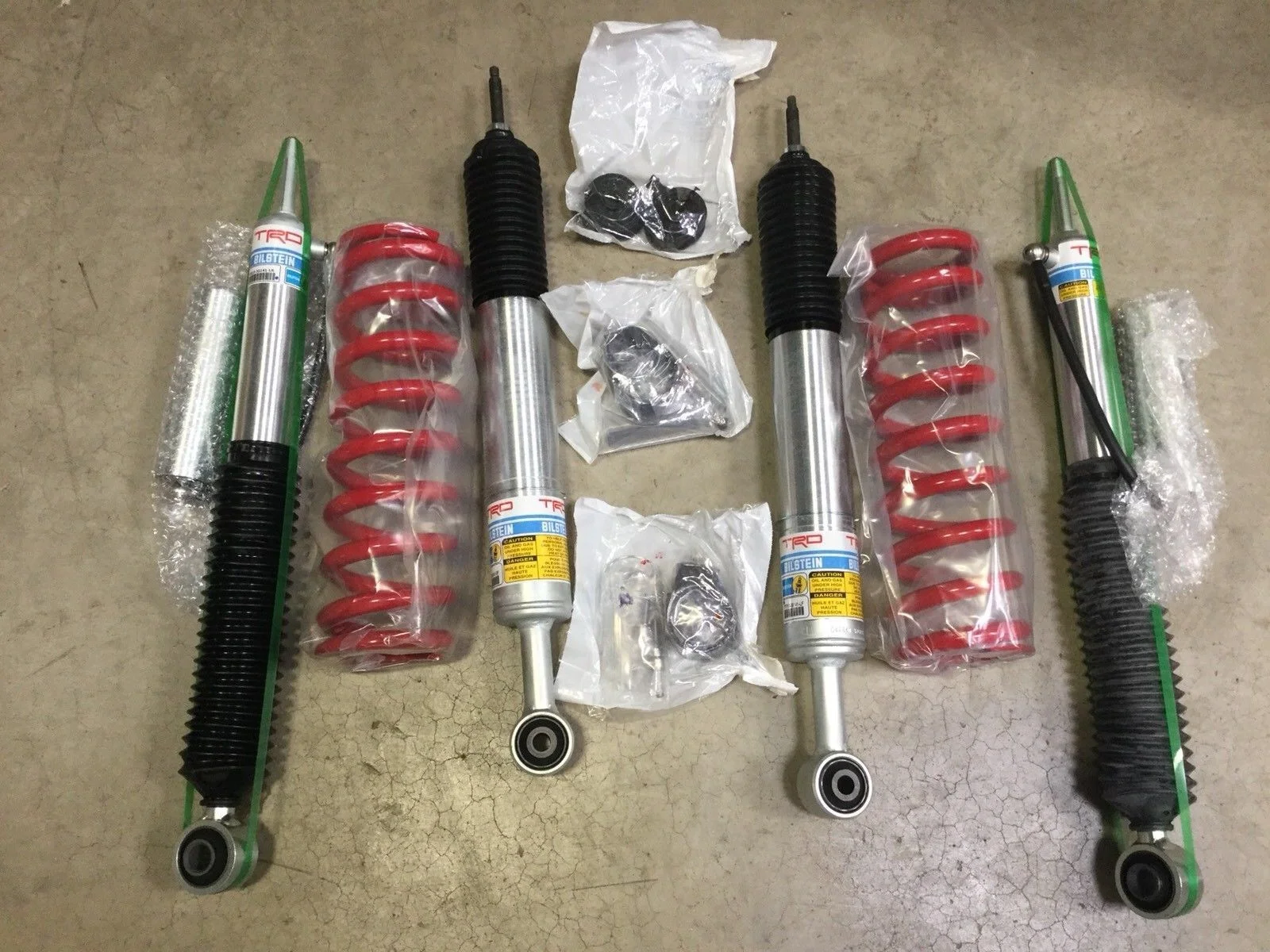

@HomersCanyonero apologies, more of a general statement on my part. You mentioned the partial 6112 kit in an earlier post and I was just adding to that if someone or @DRANGED wanted to go with the complete setup.
The kit is a complete front and rear for a good price.

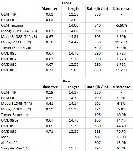

I’m in the process of doing a complete swap from my FJC to the GX. 885s up front w/ swaybar relocate and Discos, MT progressive in rear with OME 60071L for extended travel. Bought the GX for a bargain because of airbag failures so figured why not.
You get all that for $573? That's a steal! Are you sure? The Bilstein 6112 kit with just the front shocks and front springs is $643 on Amazon.
What's the model and specs on the rear shocks? All you need is rear springs and the conversion kit to get that done and those two other things are like $400 if you get basic stuff.
Damn! that's a great price. YOu can get a whole suspension upgrade and coil conversion for under $1000! Yikes.
