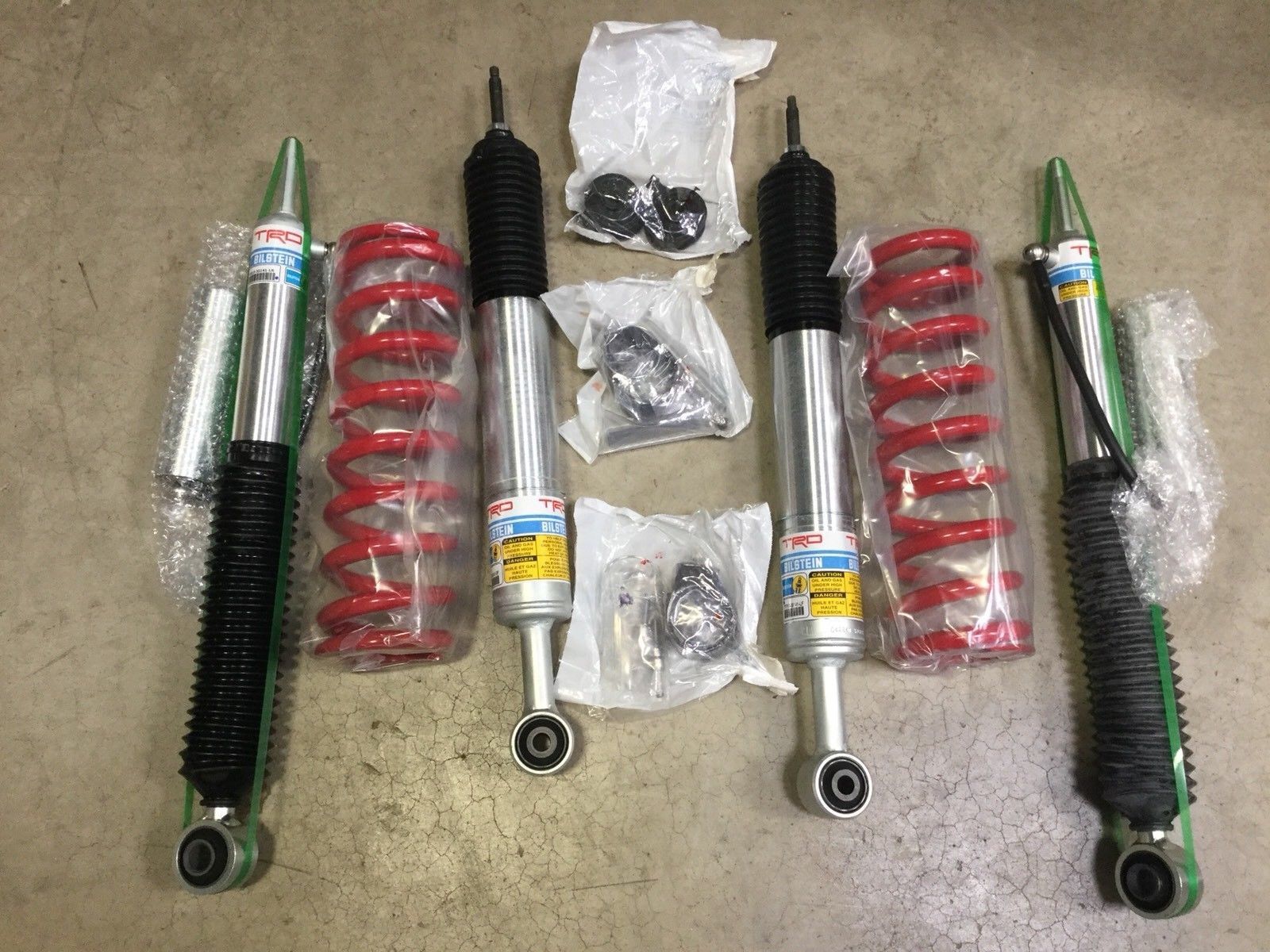

The rears are Billstein remote resi’s (5160s)

That's a great entry-level price for rear and front shocks plus front coils. If you want to keep your air bags, then that's all you need to refresh your suspension for $573.

Front are 6112s with the TTUE coils. I’m not sure of the spring rate of those but would be comparable to the stock FJC spring rate. Only difference was that the TTUEs sat level from the show room.
They only ran this setup on the 14 TTUEs

Your photo, is that the $600 kit from you a? Shocks front and rear, front lift coils amd no rear springs, plus are those remote reservoir rear??
It was. The kit was used on the 4Runner TRD PROS and the 14 FJC Trail Teams Ultimate addition.
The kit included hardware. Front coils (Red that leveled the trucks) 6112 shocks and 5160 rear remote reservoirs.

My phone has a mind of its own and double posting but yes, you’d need the other bits to get it converted. And good point, if the airbags are fine everything should bolt up. You need to do a little finessing to the front lower shock mount as these are a little larger. They will work though.
@HomersCanyonero Thought you might like this. Just came across the complete TTUE kit for sale by Toyota for $573. Pretty reasonable actually. Although there were some front coil failures reported from the TTUE folks. It’s a beefy kit and sits about an 1” higher than normal stock w/ the 6112s and 5160s

I’m lifted about 2.5” in the front with the 6112s FJ cruiser kit’s shocks and coils. It’s adjustable so you can select the lift up front.
The TRD branded Bilsteins are not height adjustable.

Yeah, Homer. I was talking about the TRD FJ Bilstiens that were linked earlier, not the 6112 adjustables for an FJ. The TRD branded Bilsteins are not adjustable like the 6112s are.
