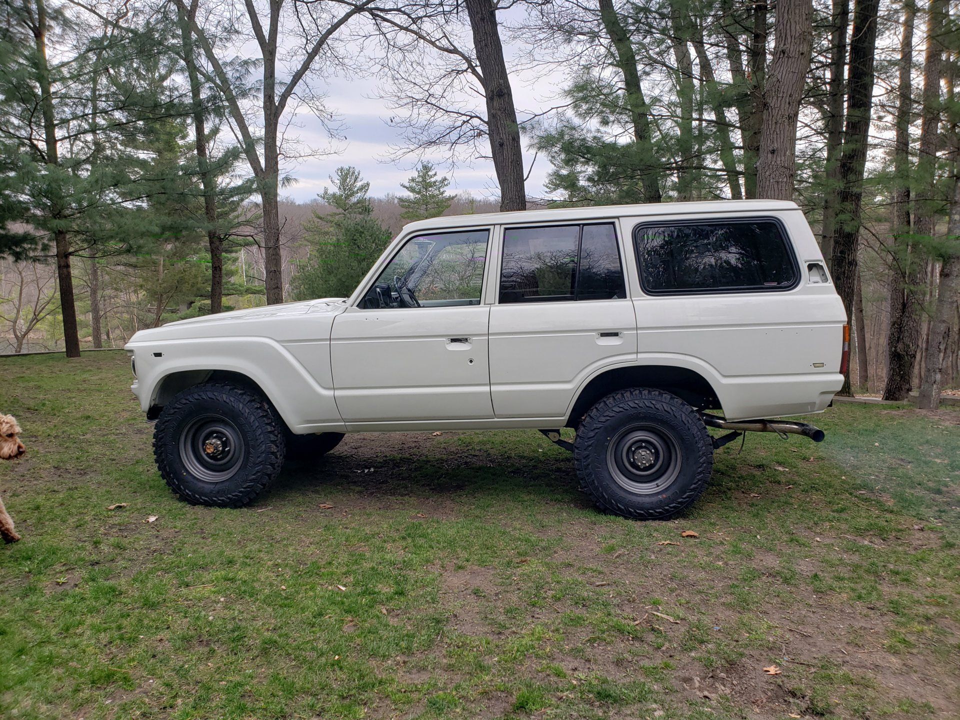

Bad Ass Pat. I like the open caps on the rear as well. just seems right :).
I'm kinda glad the rear cap won't cover the ff hubs. Front caps look pretty cool on there
Those look great. I’m glad you picked those yokos!
I'm looking forward to how they hold up. "Made in Japan" is appropriate I think.
Pat @SipLife is asking if the rear hub cap opening is the same as the front to accommodate the FF axle.
It is. It is just a front cap on the rear.
I do have to mod the caps to fit on the Wheel Vintiques wheel. I will cover that as soon as I finish doing the work.
I think they look amazing! Love the tire choice as well
I'll mirror comments that the caps revealing the FF rear looks amazing...
I was figuring that fronts would work exactly like that.
