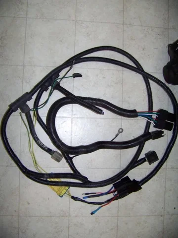

Man I wish I could find someone that is a bodyman that needs wiring done, as I love to do wiring [I hate electrical tape and loose wires], My gm wiper to fj40 and my front light harness.lol Both with corresponding relay's.

Man I wish I could find someone that is a bodyman that needs wiring done, as I love to do wiring , My gm wiper to fj40 and my front light harness.lol Both with corresponding relay's.
