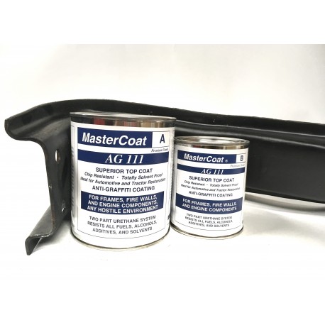

I've used 4 or 5 different systems from all the major players.....this is our go-to. It works amazingly well.
Clean the frame with a pressure washer....get off any flaking rust. Frame needs to be clean and dry.
Use Mastercoat Rust Sealer(silver)......brush on 2 good coats.
Follow up with their satin black topcoat:
Follow their directions for sure. We use a combo of brushes, rollers, foam brushes and usually a sock or rag that we drag thru the frame to help get it everywhere. If we are going over paint or very smooth metal, we'll rough it up with some sandpaper.
Provides and insanely durable surface that looks great. You'll be impressed. And for sure you don't want to get it on you....you'll be wearing it for a while :)
