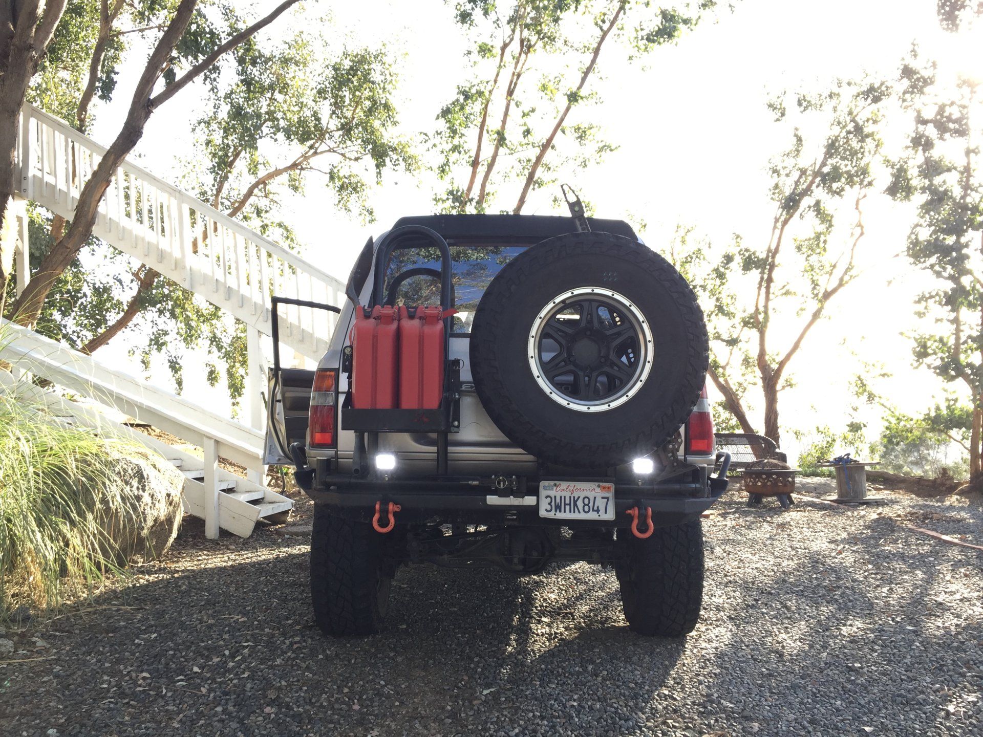

Accomplished the tasks I set out for myself today. Since I don’t have factory lockers the empty dash slot made a good spot for the dual voltmeter. After that was complete I wired in another relay and ran the wiring for the rear flood lights. All in a days work (com’n congress :rolleyes:).

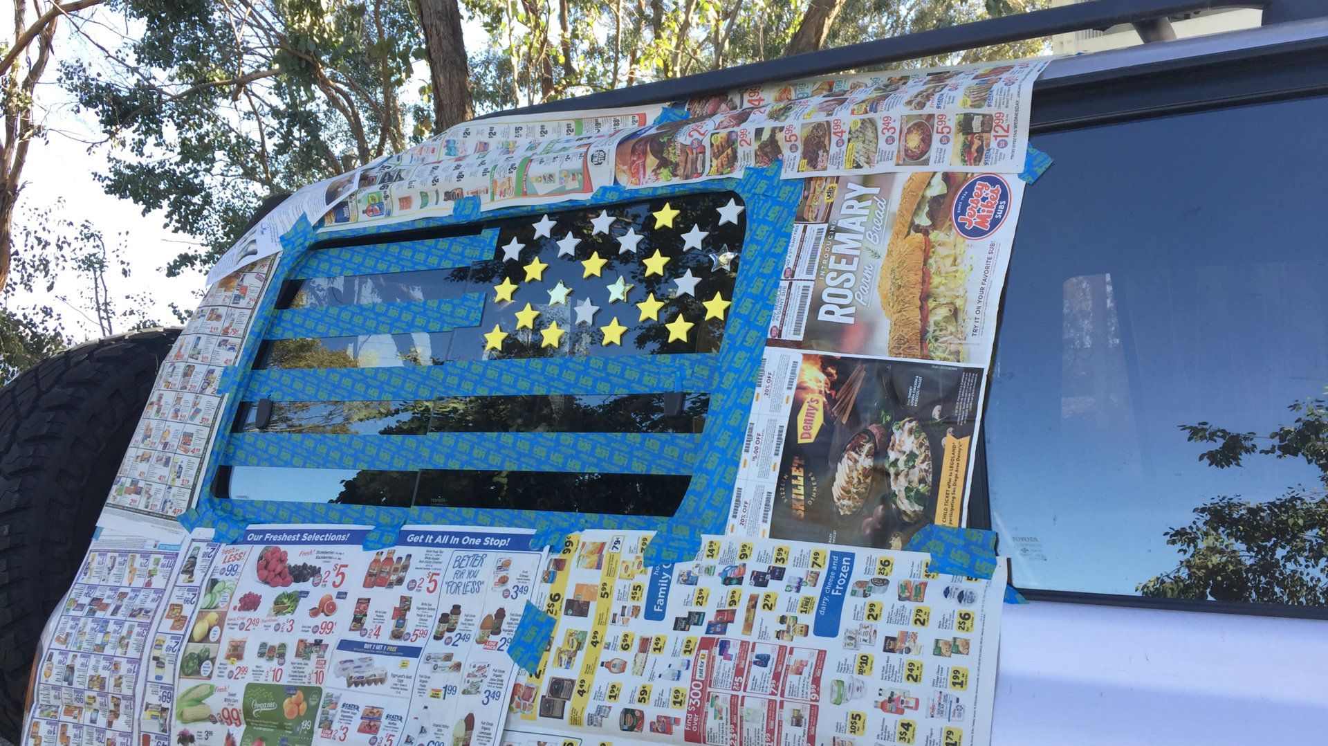

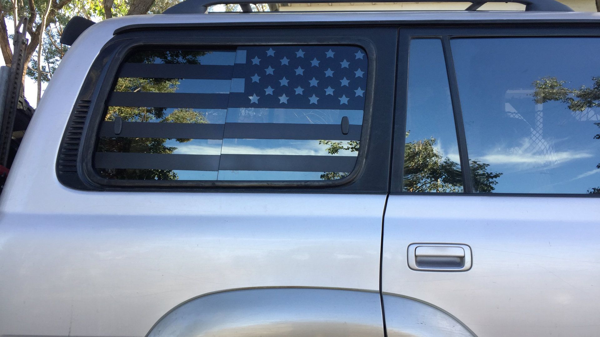

A little arts and crafts this morning. I had seen a flag decal on a the rear quarter panel of a 4Runner a while back and really liked it. You can find them for sale on eBay for $30-40. $40 for a sticker is a little ridiculous in my mind, so I blew it off. Then when walking through the store last week I saw a package of foam star stickers and got the idea to make my own.
And besides, those that know me know that my patriotism goes much further than a sticker.

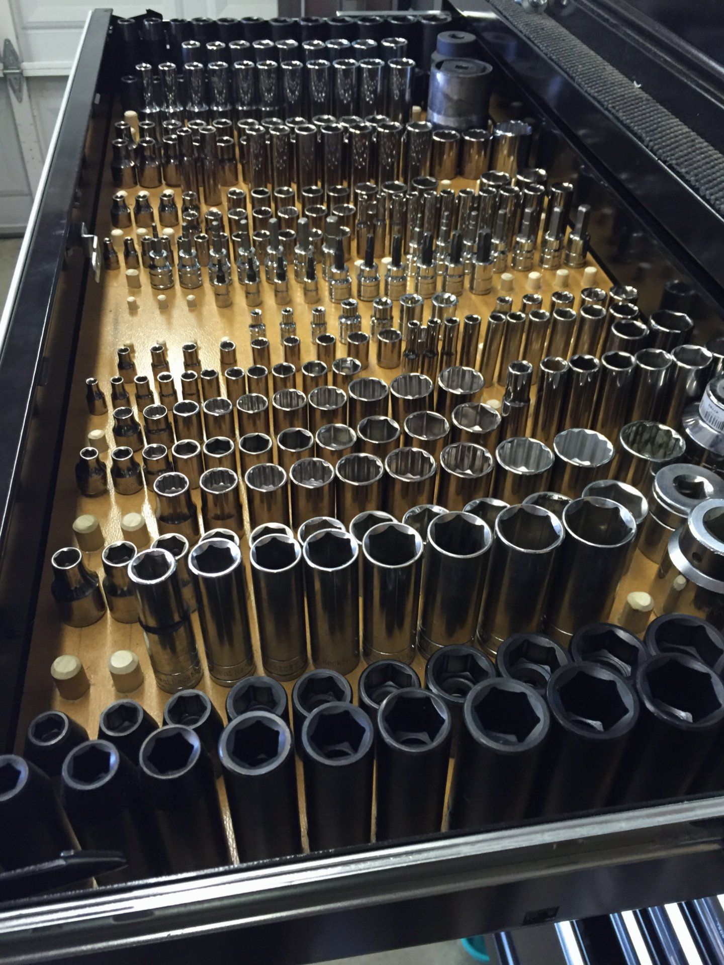

I made the insert specifically to fit my sockets as I found the store trays to waste too much space.
Wooden dowels; 1/4, 3/8, and 1/2. The 3/4” live in a different drawer. I measured the inside of the drawer and cut a piece of 1/2” MDF to fit. Set all the sockets up on the board and created quadrants per group e.g. 1/2” metric on one side, SAE on the other. Then 3/8, 1/4 in the middle. Due to the varying sizes after I had everything in rows I marked the middle of each socket to each perpendicular line. Straight edged all the grids to get my cross marks then drilled out each hole to 1/8”. Then drilled out each hole to the size of the dowel.
And if that doesn’t sound tedious enough, I then cut up 48” wooden rods to create each dowel, sanding both ends of each one (at least I have a bench top belt sander). The hole to dowel tolerance is very tight and each one was press fit with a mallet, no glue.
It was a good rainy day project.
This isn't the clearest picture from when I made it but it gives a good idea of the layout.
