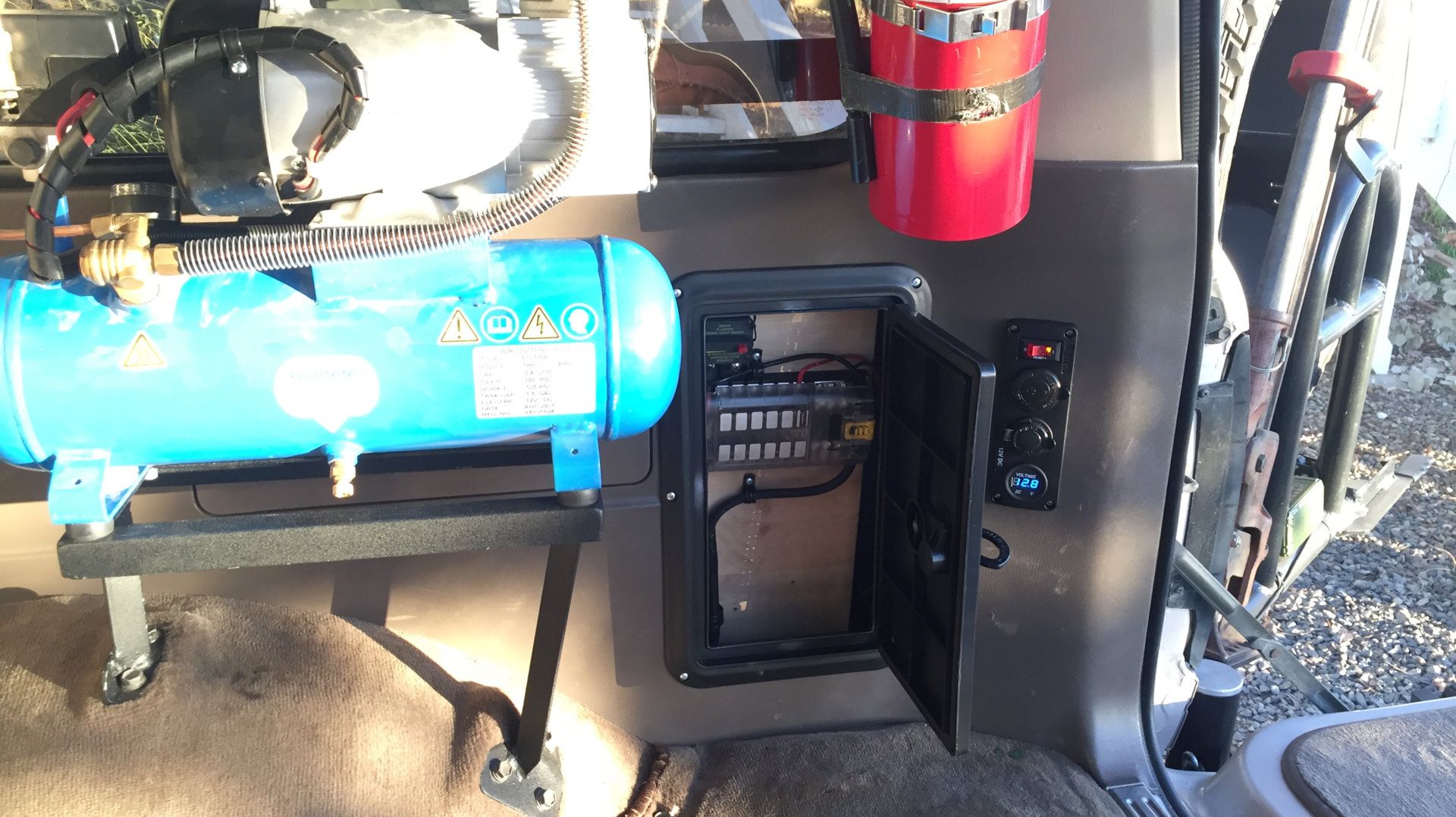

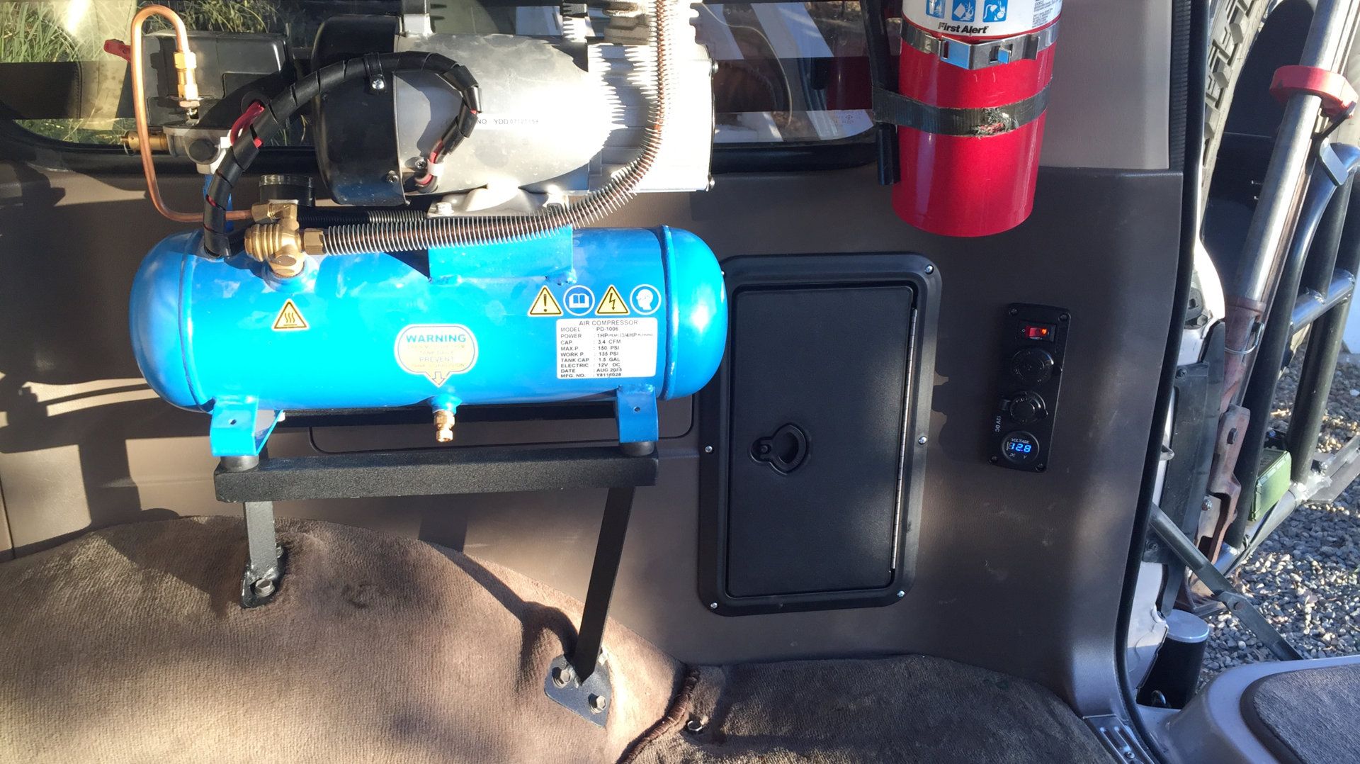

After testing a few different setups I’ve settled on this marine hatch for access to the quarter panel fuse block. I also installed the aux port, USB, and another voltmeter just to monitor the house battery while sleeping in the truck.
https://www.amazon.com/gp/aw/d/B017NA9RS0?tag=ihco-20

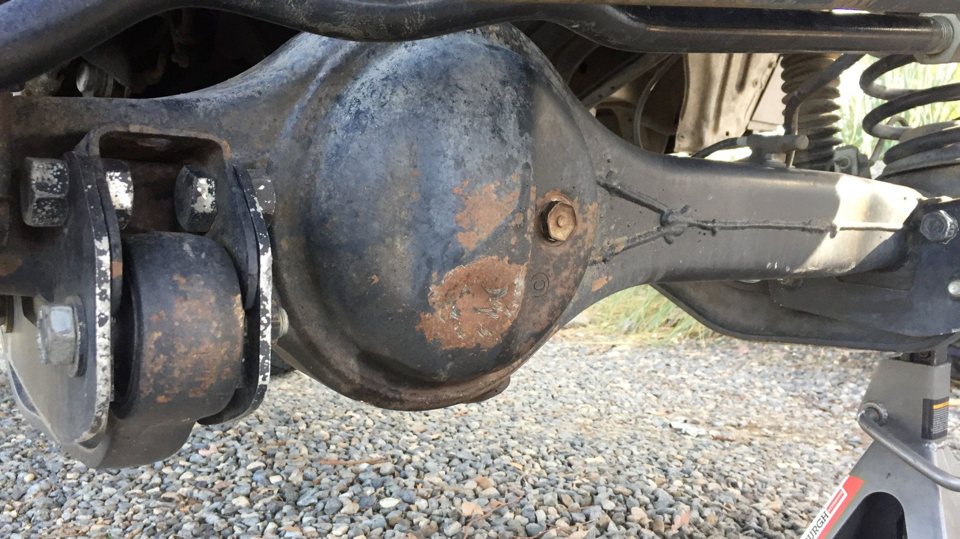

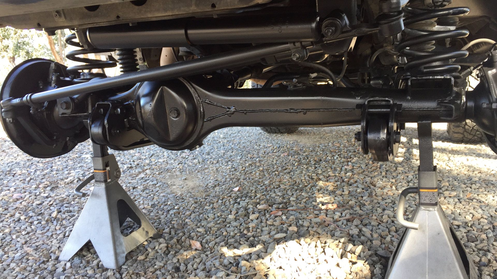

Doing some light cleaning this morning. I rebuilt the knuckles last week so I didn’t have that much grease that needed to be cleaned off. I sprayed everything with simple green, let us soak for about 10 minutes and rinsed off with the hose. Then hit everything with a wire brush, wiped clean with acetone, then painted.
I also ordered some front diff armor as I smacked mine pretty good on my last trip.
View attachment 1636165 View attachment 1636164 View attachment 1636163
your jackstands on gravel makes me nervous! be careful I once had a major accident this way......
