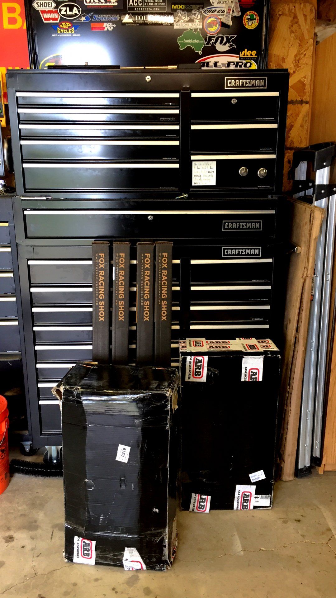

Presents!
Got my new shocks and springs this afternoon. I'll make sure to get some comparison pictures of the springs when I take the old ones off.
That was fast and WOW...nice!!!
