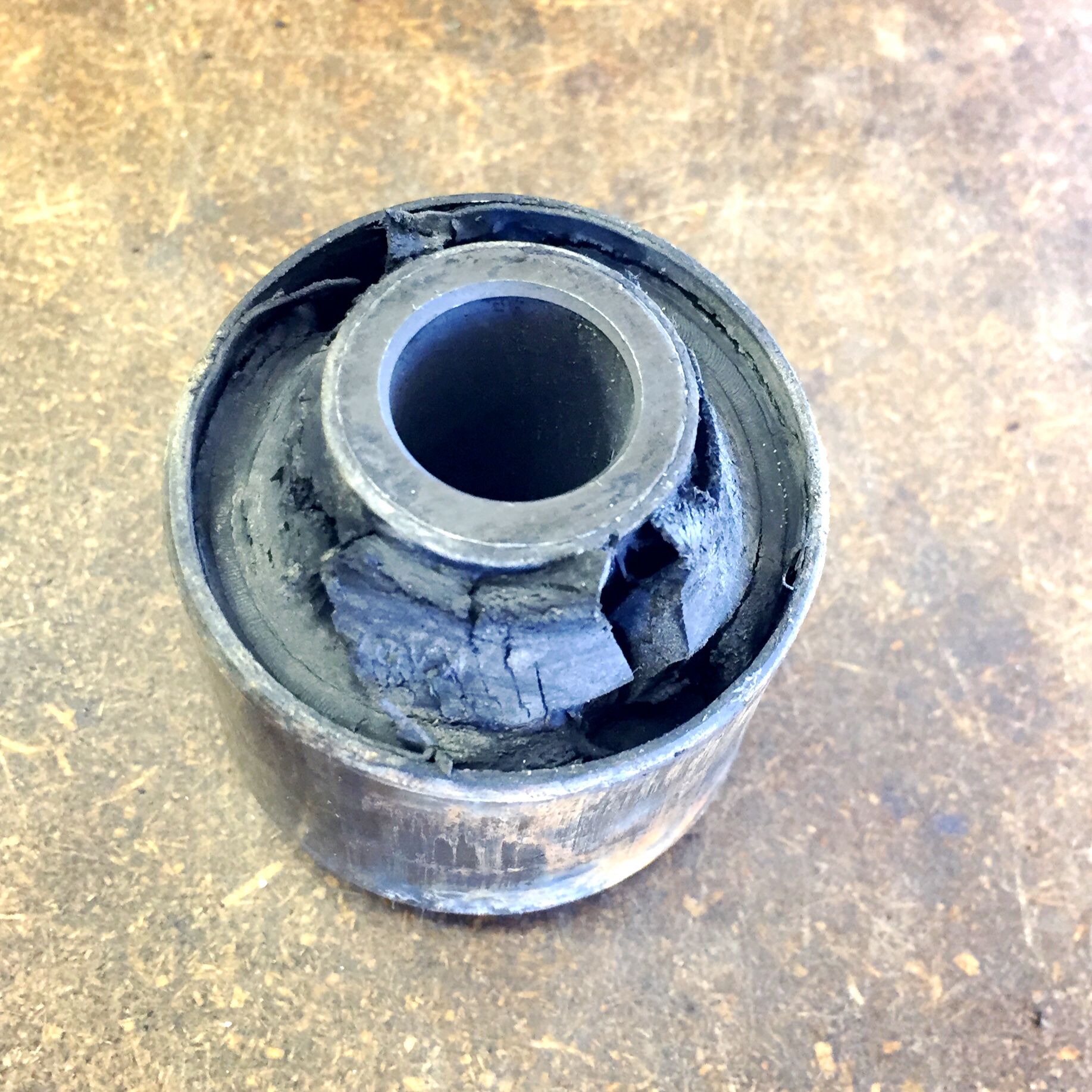

:bang: Destroyed another set of radius arm bushings. Went ahead and replaced all six again with OEM since I had the arms off. This one was by far the worst, driver side frame mount.
  • Like
Reactions: KTP
Is that a photo of an oem bushing??? Say it isn't so!
It was an OEM that I bought online. Perhaps it was a copy/counterfeit or the molding guy had too much sake the night before. It's about a year old, 30k miles, and lots of desert wheeling. I was pretty surprised it disintegrated the way it did. The others didn't look nearly like this one.
I put bushings from troyota in mine about one year ago. I don't drive it as many likes as you but plenty if twisting on rocky trails and mine are fine.

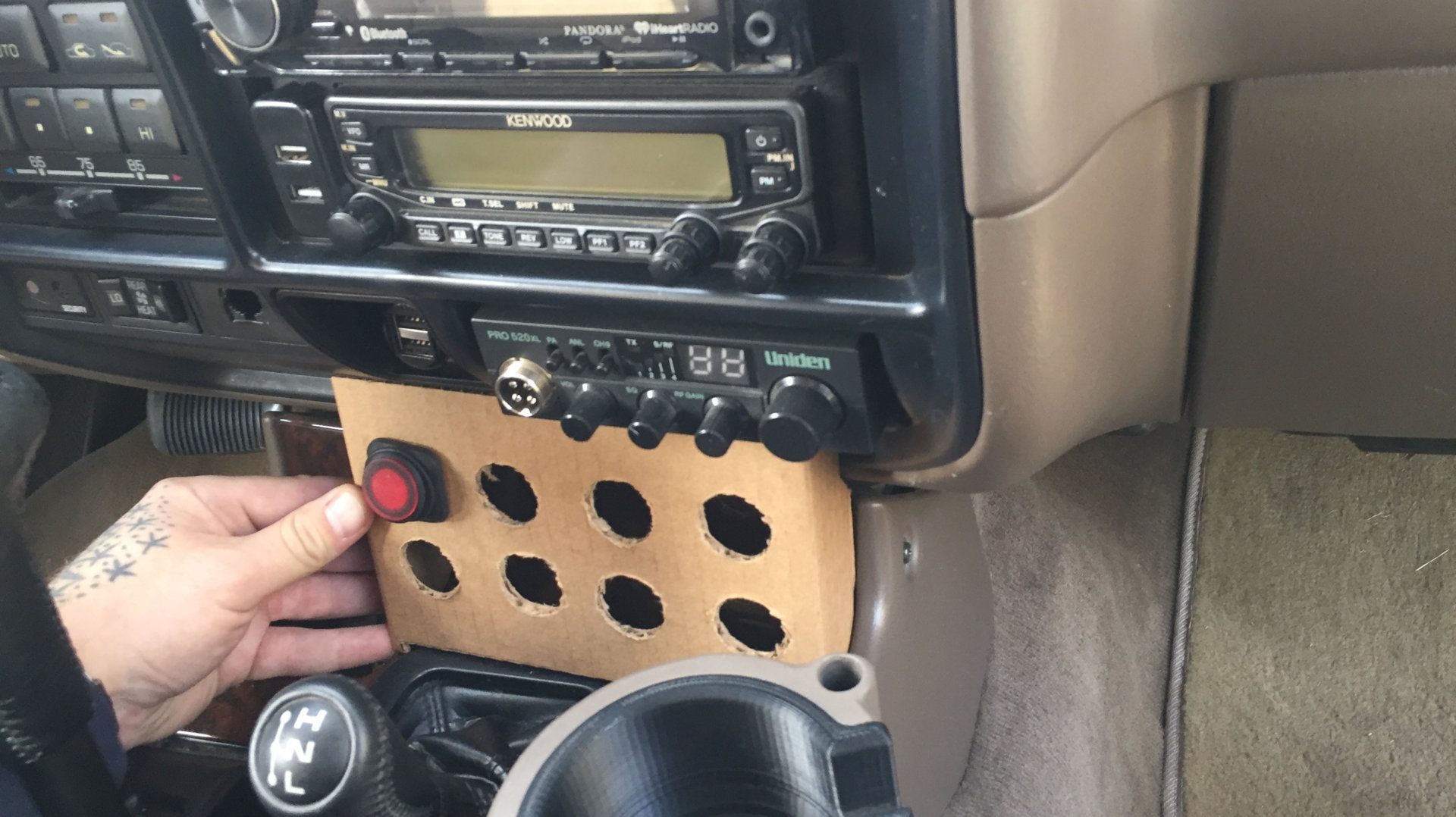

Brainstorming :hmm:
What do you think of this???
Switch Pros - Home
Dave has them at his shop. Just an idea.
Switch Pros - Home
For the one time low price of just $499:eek:. My cardboard was free from Amazon :rofl:. I’m actually going to try and mock it up with some 16ga. If that goes well I’ll probably just tech screw it in and call it good. But I will have a template we could transfer to aluminum or SS if wanted.
