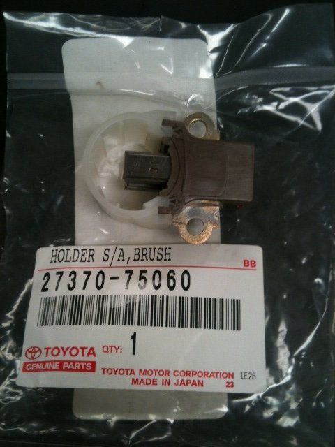

Door #3: $15 for just the alternator brushes
I am frugal so I chose Door #3. The following is the procedure for saving $685.

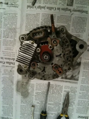

1) Remove the three bolts on top + the grounding tab screw
2) Lift the cover and this is what you see. This pic has the new brushes in it.

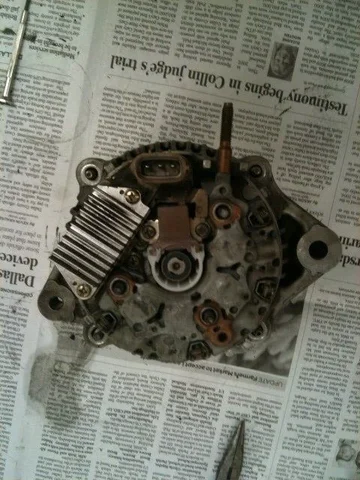

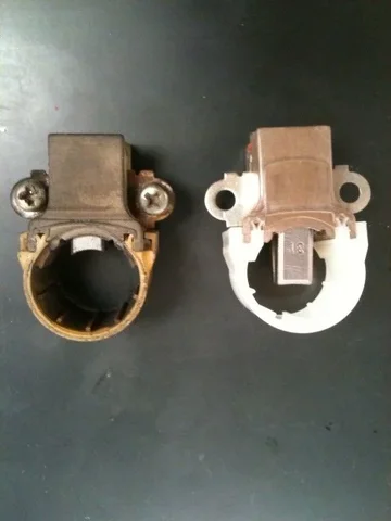

3) When you unscrew the old brushes there will be a red gasket staring at you. This is as far as you need to go. I went further and unscrewed and cleaned the heat sink as well because my OCD wouldn't let me leave it dirty.
