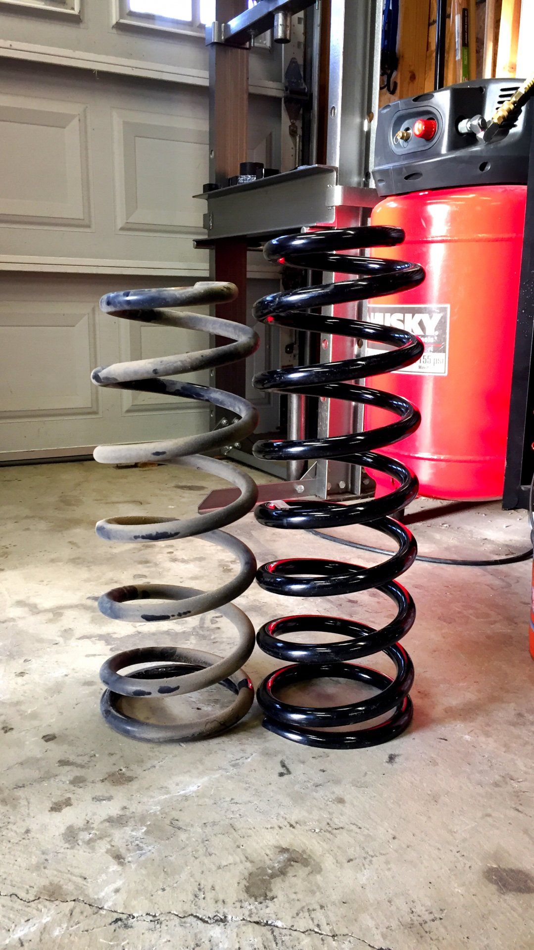

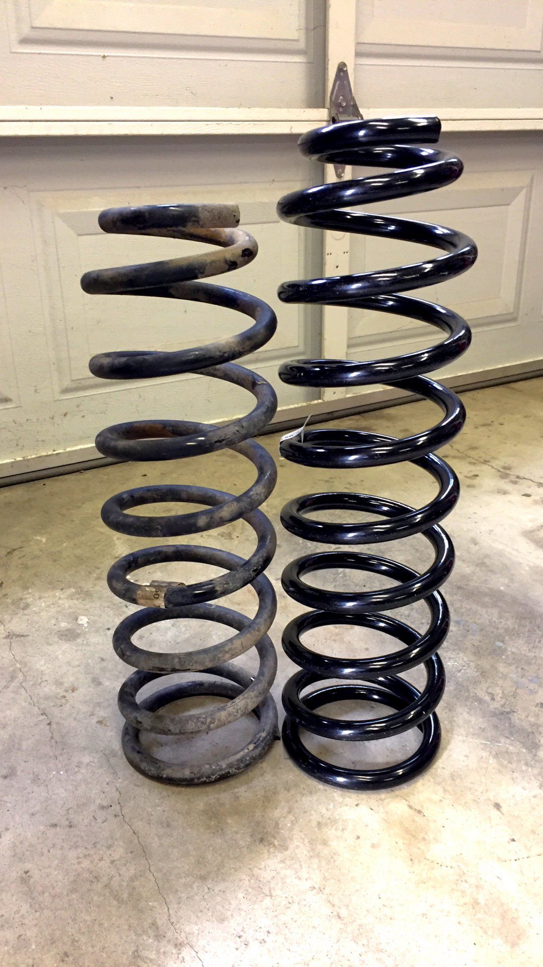

Here's some pictures of the springs as promised.
This is the OME 850 next to the 3051.
863 compared to 3052

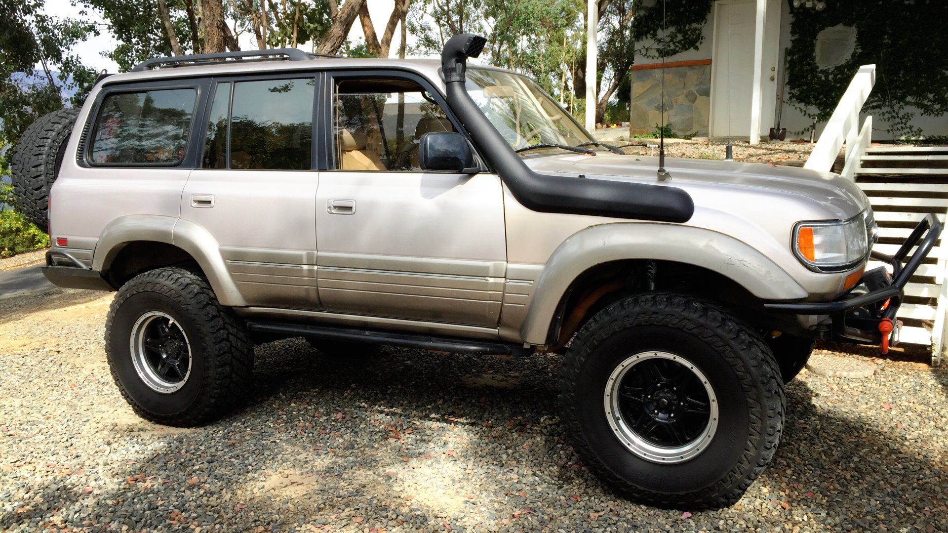

So far I am very pleased with the stance. Distances measured from center of hubs to the bottom of the fender flare are:
Front - 25"
Rear - 26"

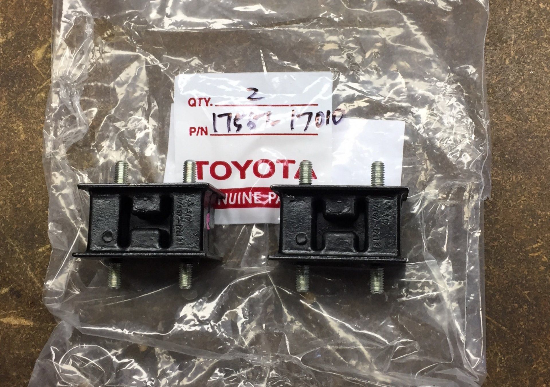

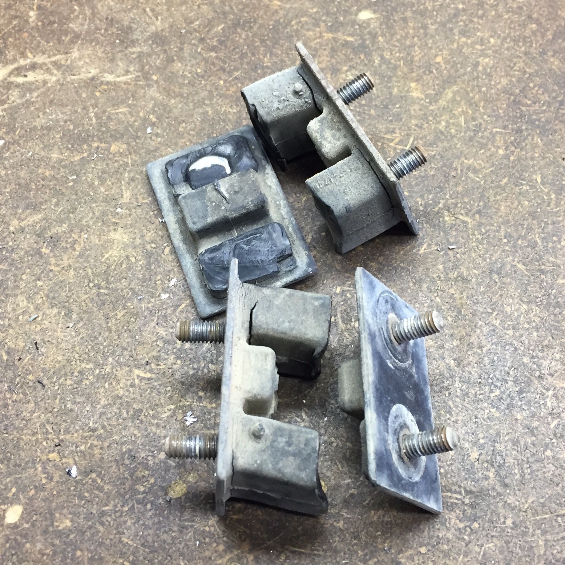

I also took some time today to replaced the exhaust hanger cushions before and after the muffler.
I didn't take a picture but I made some addition 1/8" spacers to go between the new cushions and the mounts to raise the exhaust 1/4". This doesn't sound like much however; the front outrigger of my passenger slider is so close to the catalytic converter flange that it makes contact when starting the truck or when the motor is under load.
