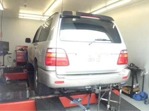

Base Dyno scheduled for Friday AM.

Baseline done.
Install DT, run 5 days then dyno
Install EMS, run 5 days then Dyno
Publish cutback results
Install mid pipes, run 5 days then dyno
Publish results.
