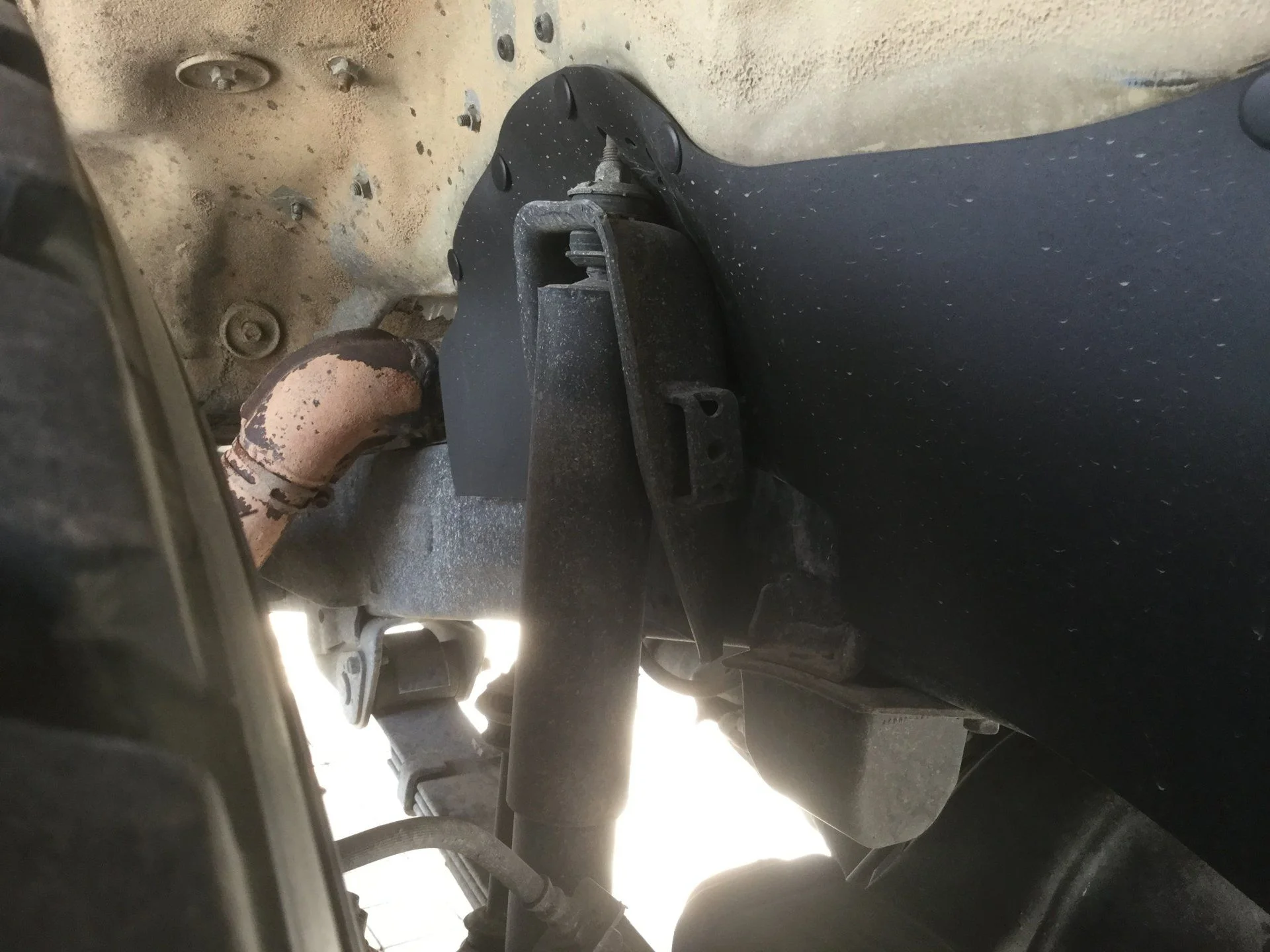

@John Young, the top of the shock is supposed to go through either those holes or the slot and the shock comes in front of the skirt. I'll see if I have a photo to post. You basically pierce it at that point and work out in both directions.......not that it won't work the way you have it but I think it keeps the shock from rubbing through the skirt.
Edit: Already there. Look closely at the photo in post 91 and you will see what I'm talking about.
Thank you WDE. I'm having a little trouble visualizing even with the help of the photo in post 91 and I want to give the photos to the guys at the garage. Next time you are with your truck would you mind taking a couple more photos please?

It will be hard to take off at this point and I'm not sure it can be done without taking it off but imagine sliding the skirt behind the shock and then inserting the fasteners. If you start with the fasteners on either side of the shock you will see that the top of the shock will need to go through the hole/slot in the skirt. I can see my entire shock behind the tire except for the top inch or two of the stem.

@John Young See if this photo gives you some clarity.

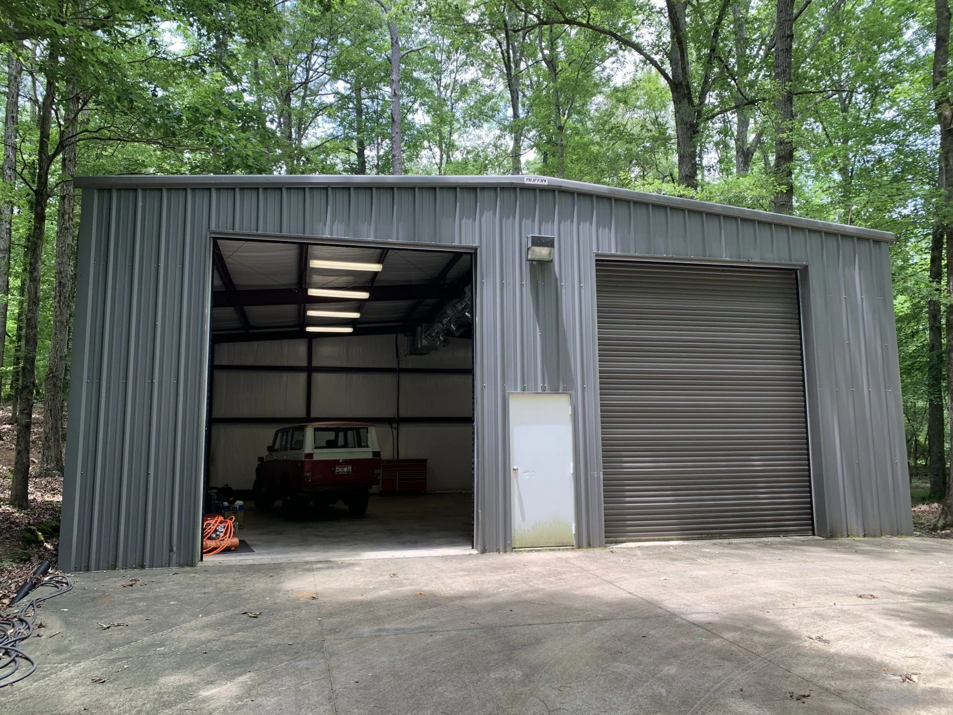

On a whim a few weeks ago we looked at a few acres with a house already built. Well, long story short, we couldn’t believe the quality of the house construction and quickly decided the layout would work well. It’s a bit larger than we might have built but I suppose that’s not the worst problem to have.
As a bonus, the Beast will have a new home as well.
Congrats! What a great shop!

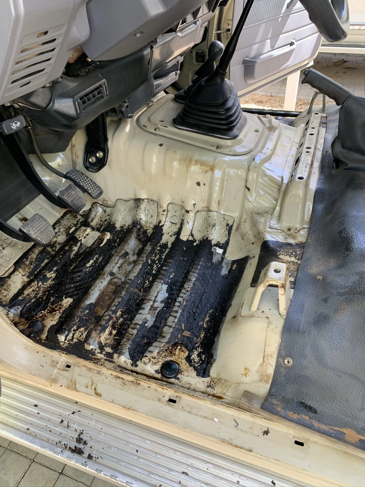

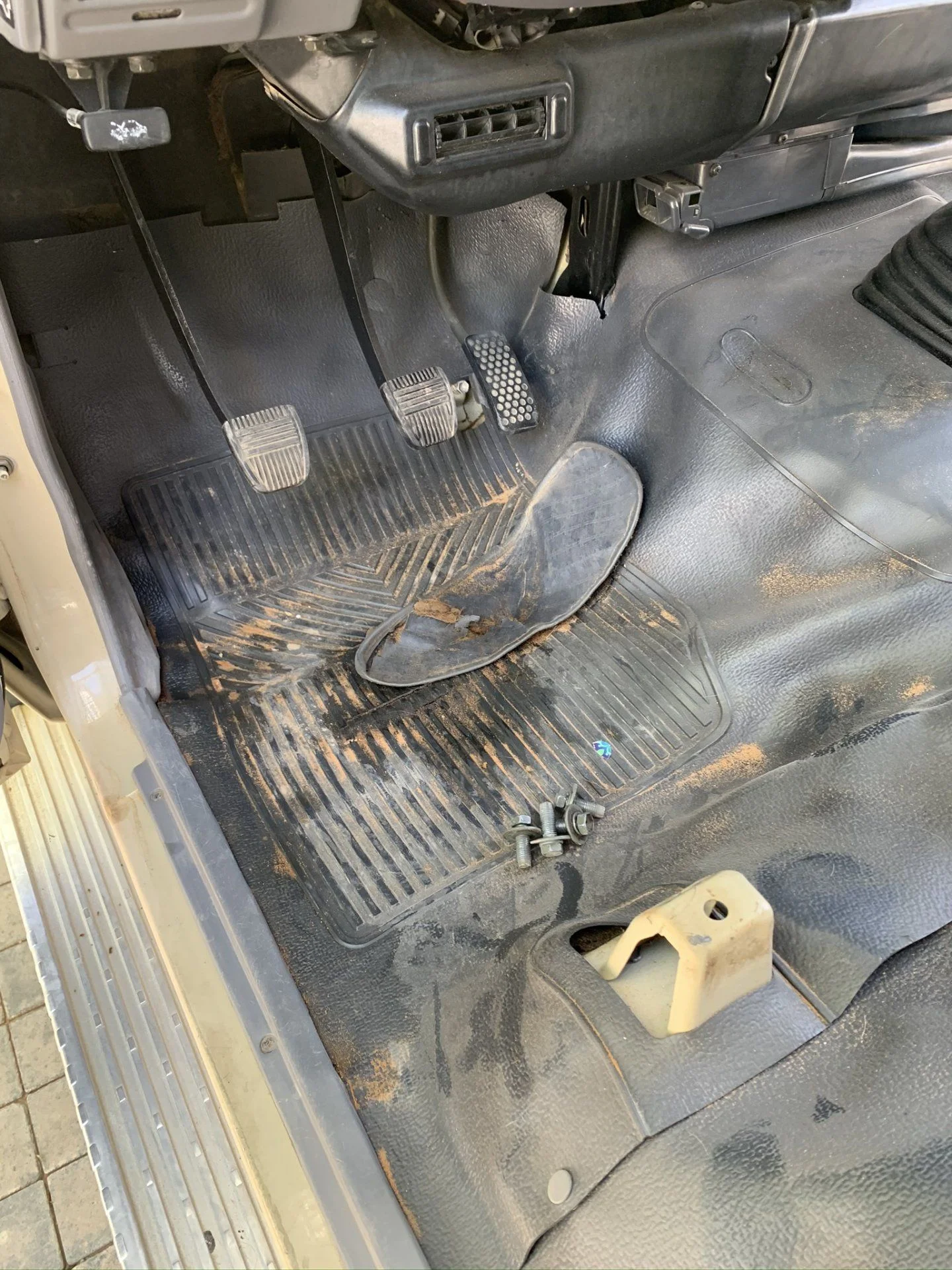

Also decided to remove my seats and the old floor liner this morning before the temps topped 100. Thanks to @Onur I have a brand new front liner that appears to match the old one perfectly including the color. That's somewhat important as the 75 pickup has a roughly foot wide strip that goes under the seat which I don't have a placement for. Old one is in fine condition though so no problem.
What is somewhat of a problem is the factory sound deadener in both footwells. When I removed the old liner it literally looked like someone had poured about a half cup of 30 weight on both sides. Clearly the factory stuff is asphalt based and with the extreme temps and age I suppose it eventually oozes this stuff out. If I was in the US and had access to some damplifier pro or something similar I would remove all of the factory stuff and replace it with that. For now I think I will clean it up best I can and tape some plastic down to keep the jute on the new liner oil free.
Here's a few pics of the old. Will take some of everything installed after I get it all cleaned up and back in.
