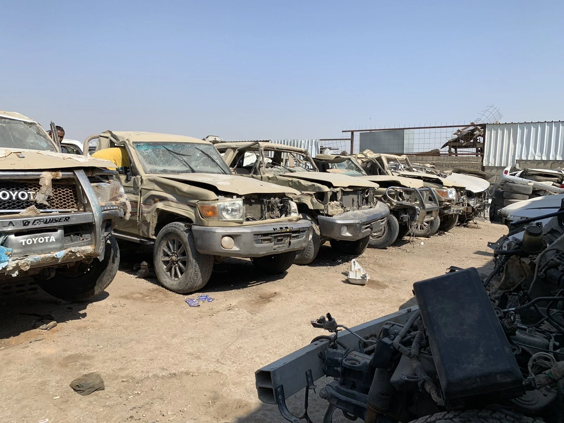

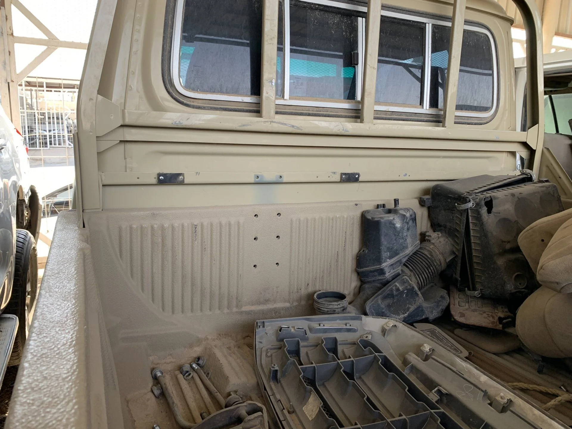

Took a field trip this morning to the wrecker yards south of Riyadh. It’s comprised of two large areas that must be 2 or 3 square miles each with individual yards abutting one another. To say there was no organization would be wrong but basically everyone was just driving around looking, I suppose, for a particular car that might have the parts you need. I bought an OEM pintle hitch to put on my ‘77 FJ55 but otherwise didn’t even see a pre 2000 FZJ75. I did see some newer models (see photo) and literally thousands of wrecked Hilux and Nissan pickups - all white.
So my wife and I both like the look of the pickups with the spare tire mounted on the front of the bed. Mine has no provision for mounting that I can find. I'm guessing if it came with the auxiliary tank the tire was mounted in the bed; otherwise it was mounted underneath. These pickups are everywhere over here so I've observed a pretty large sample to backup that guess. It looks like the parts are still available on Partsouq.com but the diagram is really confusing. If I do buy the parts it looks like I would need to at a minimum drill some holes in the bed.

Here's a photo of a newer model, FZJ79, with the tire carrier removed. Probably different hardware but it gives you a good idea of what would need to be done.
Leaning toward not making this modification but thought I would at least throw it out there in case it's much easier than I imagine.

Can't tell from that photo but are the small "chocks" part of the floor?
The small chocks are part of the bed liner. I have them in my bed liner as well even though I know the truck isn't set up for the spare. The bed liner in my pickup is new and therefore not of '94 vintage. Can't really say if they ever came without the chocks.
My chocks are welded / tacked and are a permanent installation. I've seen some mounts where the tire was simply held in place with a single bolt / nut but without the chocks the tire still moved around.
I’m planning on pulling the bed liner sometime soon. There could be chocks built in but I have my doubts.
Edit: they are still available. Part no 51933-90K00

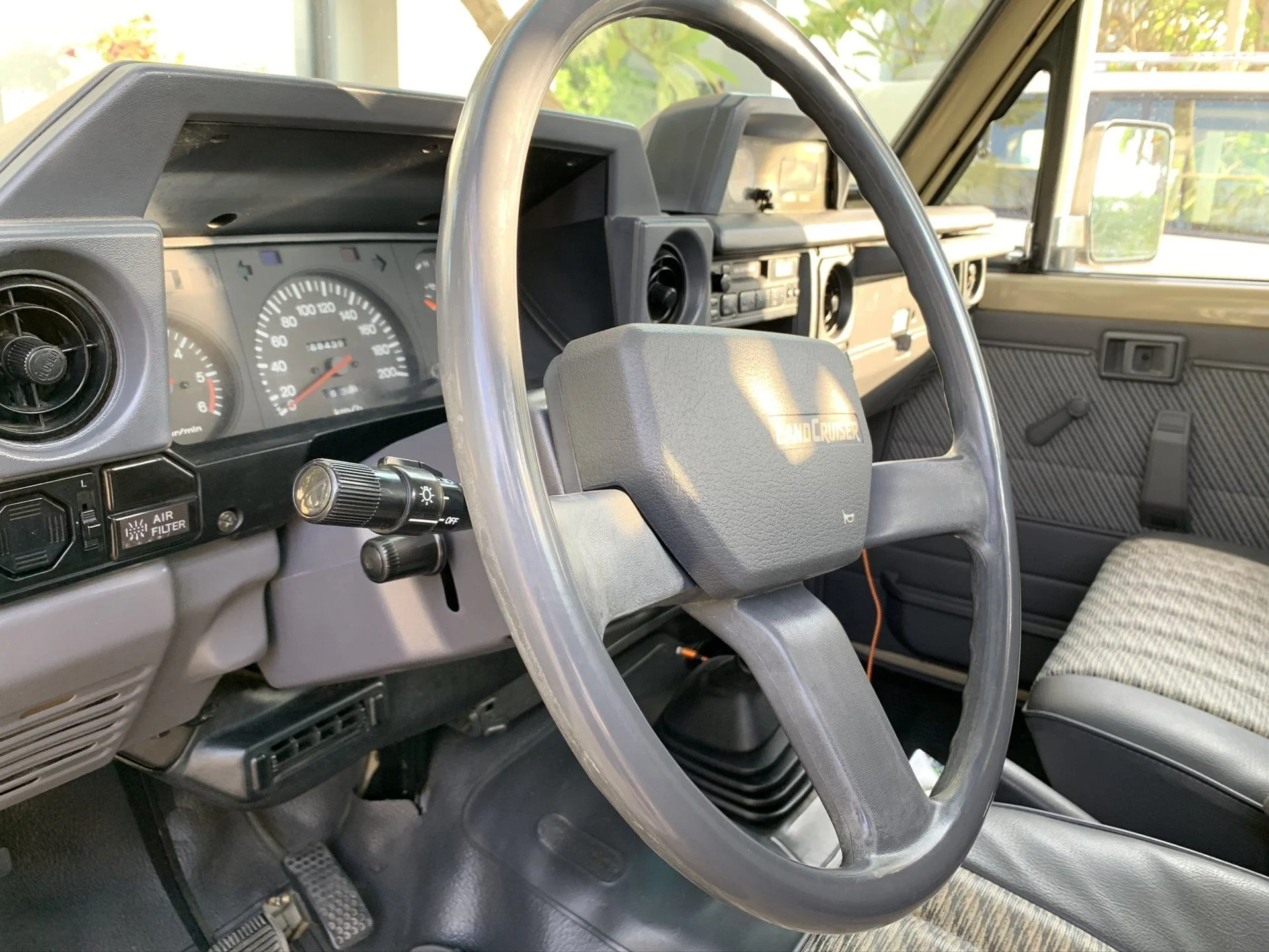

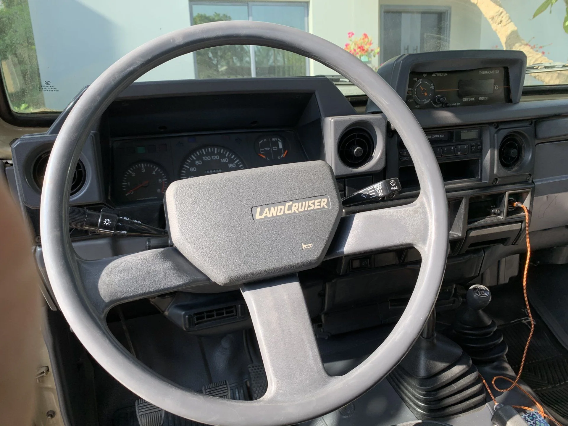

My intermittent wiper/washer not working issue resurrected so I ordered a new switch assembly. I noticed one of the internal screw tabs was missing off the steering column cover so I ordered a replacement.
When I installed the new switch assembly the wiper still didn’t work. Took me a while but I finally found the relay and after making sure the wiring plug was in tight it works. Left the new switches installed; nothing like shiny new parts.
Also noticed license plate light bulbs were out. Assemblies were pretty trashed anyway so instead of bulbs I ordered new assemblies complete with bulbs and wiring pigtail. They were only $10 each....nice surprise.
Gave the steering wheel a much needed bath while I had it off.
