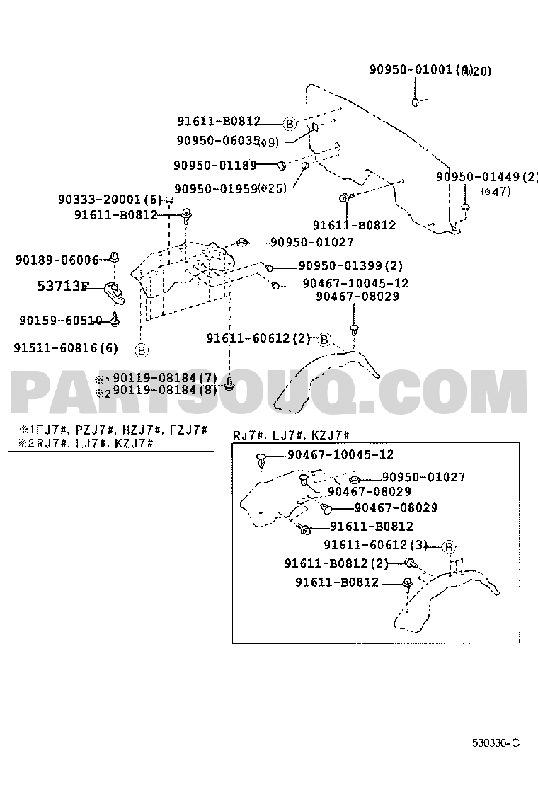

A much less important question for the experts; bordering on trivia. I noticed that my right front fender apron has a plastic piece screwed on to the very front whereas the left side does not. In fact, the left side doesn't even have the screw holes. Partsouq shows only a RH piece, part number 5371360030. When I take it off the aprons look more or less the same. Not sure what purpose it serves on the passenger side??
Reference diagram:
Reference diagram:
Well I don’t know what it is for but you helped me find where that piece goes. It must of not been important enough to take off because most of the good stuff was picked before I got the truck
Maybe it keeps crap out of the fender due to air intake coming from the inner fender?
That's the only possible purpose I could think of. The LH fender would clearly take the mirror image piece if it had the two screw holes. I suppose that is because the two fender skirts are identical mirror images.
Reference diagram:
Hello,
It is a protector for the air intake.
The air box gets air from the RH fender. This part prevents dirt and water from entering into the air intake duct.
Some models have a cyclone in the intake duct, some do not. Depending on the model, the protector/cyclone combination helps to remove coarse dust and water from incoming air, thus making the air filter's job a little easier.
Juan
