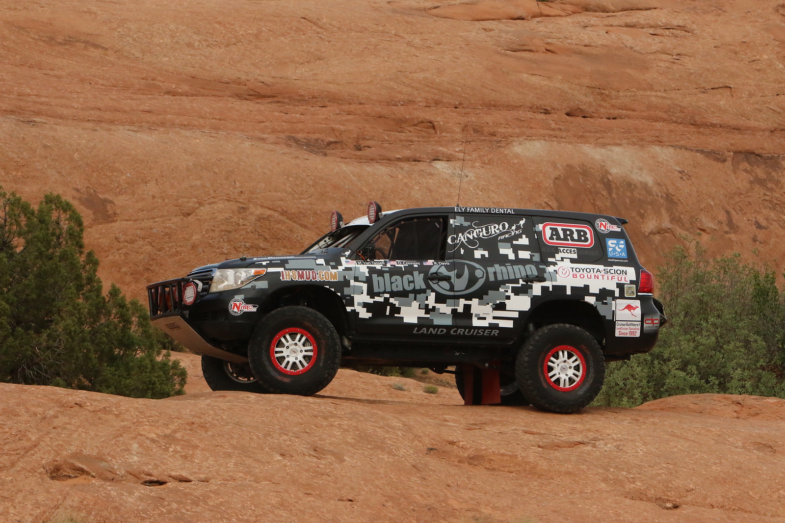

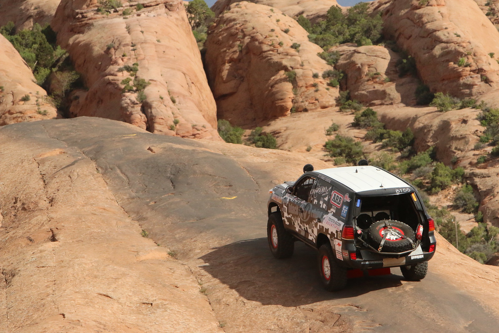

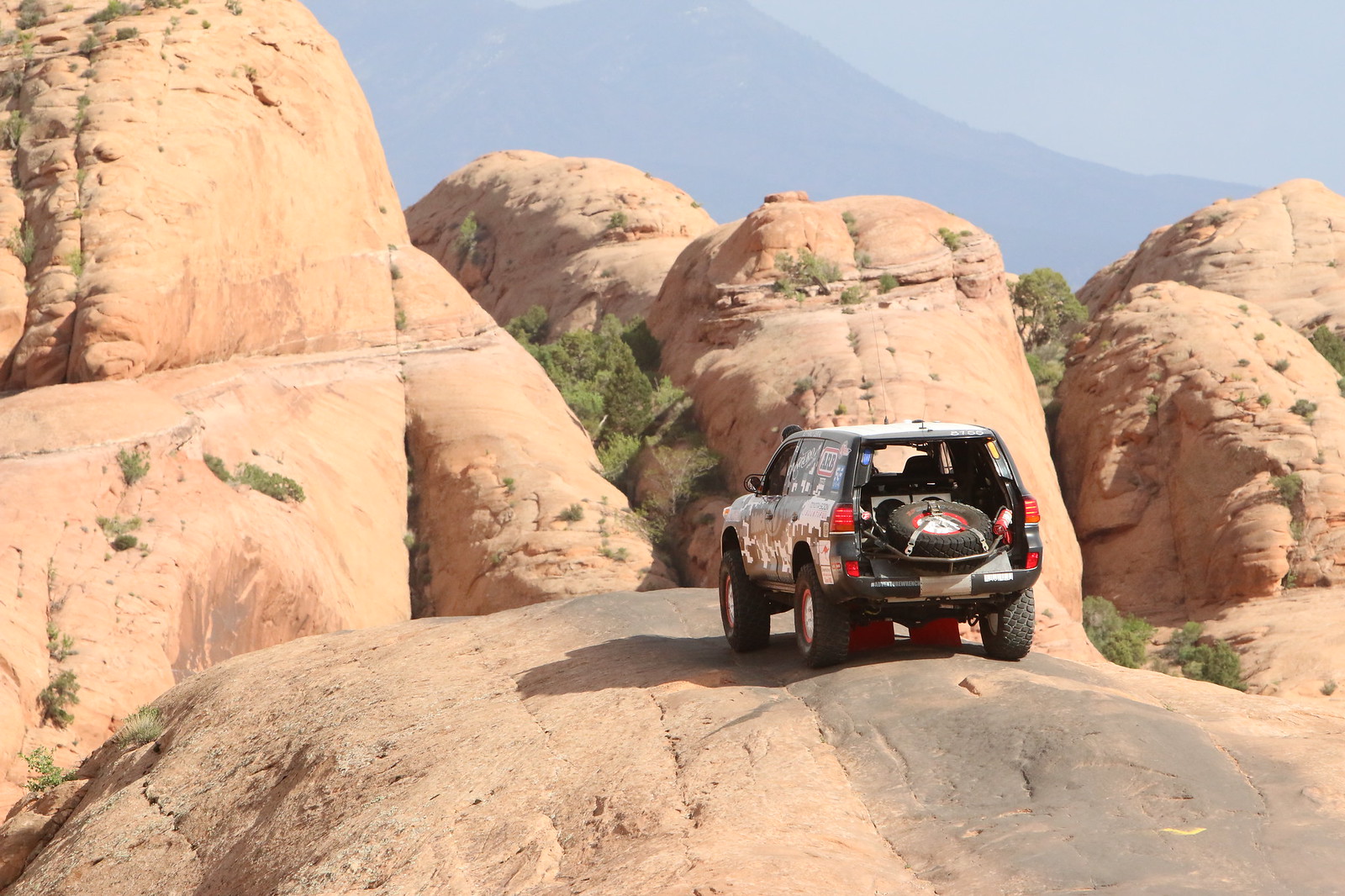

Was looking through some of my old pics and came across these shots we took down in Moab right after this version of the Livery had been completed. Not sure I have many pics of it this clean after this. :) Gotta say I was a fan of the white wheels!
IMG_1338 by Adam Tolman, on Flickr
IMG_1408 by Adam Tolman, on Flickr
IMG_1414 by Adam Tolman, on Flickr

What’s the structure inside with 2 round holes in front of the spare in the second photo? Looks like a couple 15” subwoofers. You guys rocking the tunes on the races?
Transmission cooler.

The important question, what is the orange/red "flap" under the center of the vehicle touching the ground?
