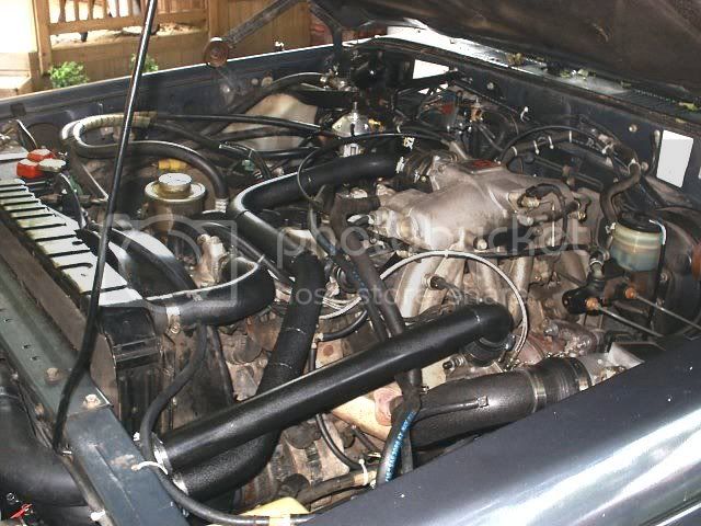

So im a bit confused, is the stock ECU alone running that setup?
The FMU interveens and raises the fuel pressure as the engine is transitioning from vacume into boost. Once positive pressure is achieved, the ECU only reads wide open throttle. The FMU steadily increases fuel pressure in the fuel rail as the boost rises. A bleed valve on the FMU allows a moderate level of tuning for the fuel mixture.
The FMU is mechanical!

Currently running 4psi, might bump it one more. Vehicle runs great and seems to consume LESS fuel. Use to, the truck would have to rely on the tranny kick down to move out of its own way. Now, throttle response is greatly improved and it feels like a larger displacement engine. That is really the result I was seeking. You only have to use about 1/4 throttle to match the old WOT position.
New Pipe
It has recently been brought to my attention that perhaps my charge pipe could have been a little shorter and taken a more direct path. Not being one to dissapoint, I built a new one.:)

How does the air flow meter and the ECU cope with the turbo?

Thanks for the props guys. As for the ECU, once the engine transitions from vacume to boost, the computer just gets a WOT signal from the Air Flow Meter. The mechanical Rising Rate Regulator just increases the fuel pressure via/boost from there. The computer is sending the same pulse width to the injectors, but the higher fuel pressure is forcing more fuel through. This type of setup is good for up to about 8psi. Running 91 octane just to be on the safe side. I had also advanced the timing a little before this project and never changed it back. It's been pretty warm here and I havn't heard any pinging yet.
