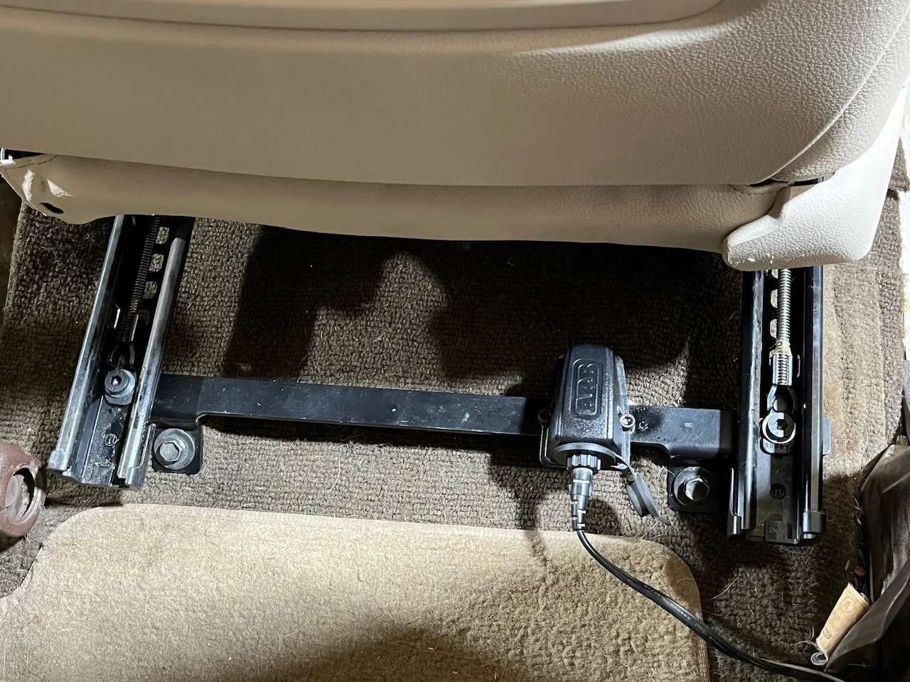

Similar - I added the arb power port under the passenger front seat and the fridge cord is long enough to reach to the back of the truck. Single battery, 15 year old Engel fridge, no problem. I think the wire I ran was 10ga, Bluesea fuse box at the passenger kick panel.

Ah, that's really cool. It's also good to know that the fridge cord is long enough that the position doesn't need to be super custom based on location.
Ah, that's really cool. It's also good to know that the fridge cord is long enough that the position doesn't need to be super custom base on location.
Dometic cords are 6’ or so. I imagine they are pretty similar.
