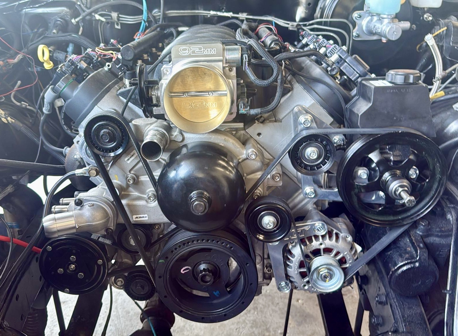

Hoping this new cap helps with the burping fluids per the v8 swap thread. TBD.

Solved my burping issues. Runs 195-205 all day now
Not running into any overheating issues, yet. lol.

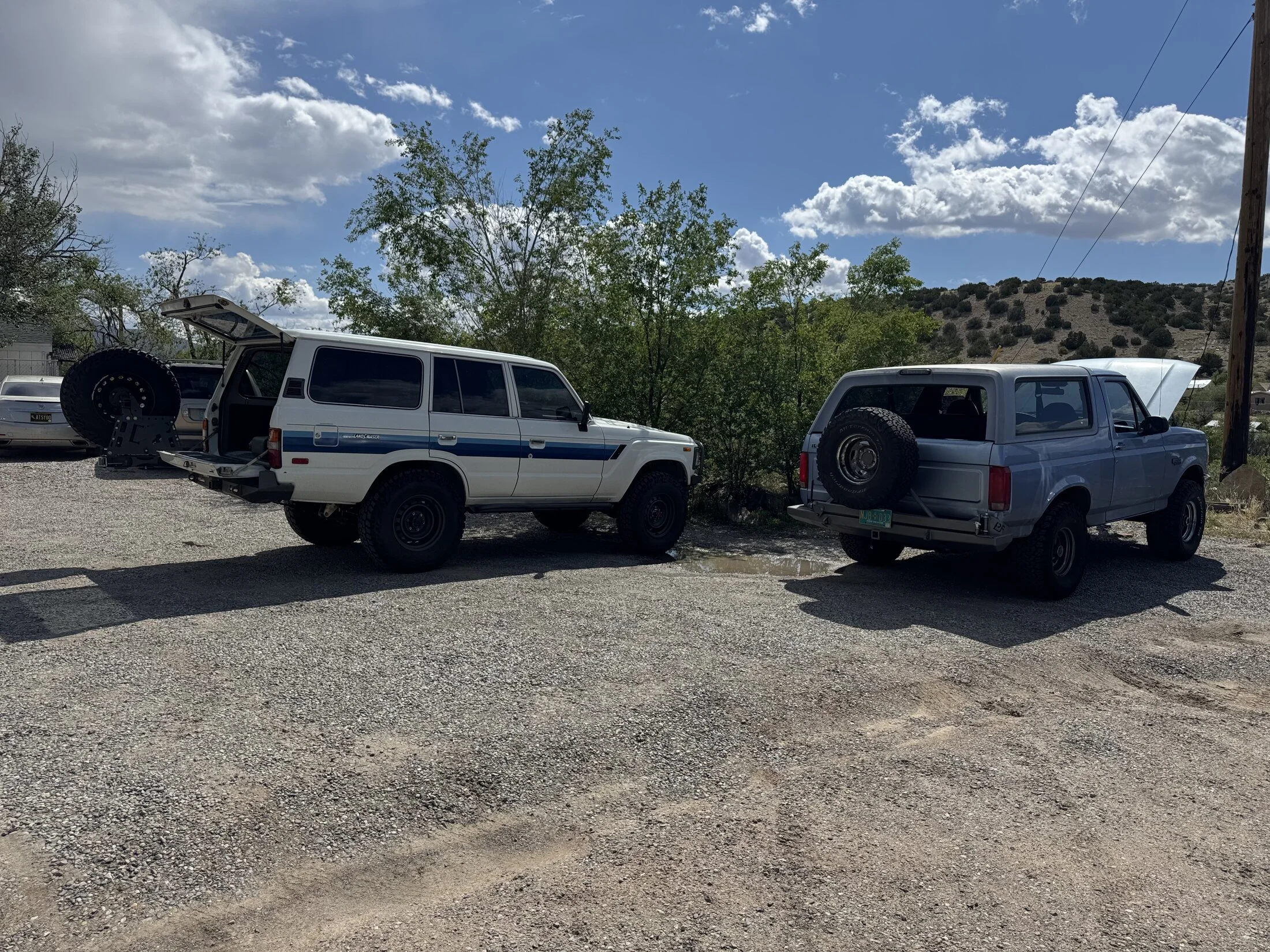

How'd the bronco do? I grew up in the back of one of those.
Runs great so far, the charge pipe came off with a loose band clamp but easily solved.

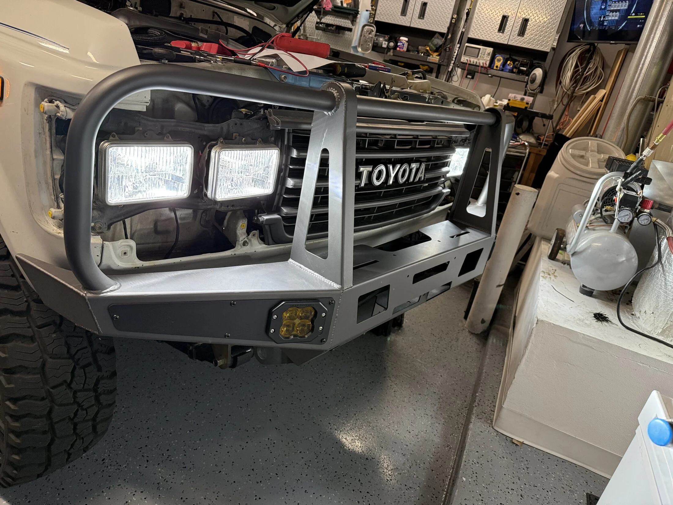

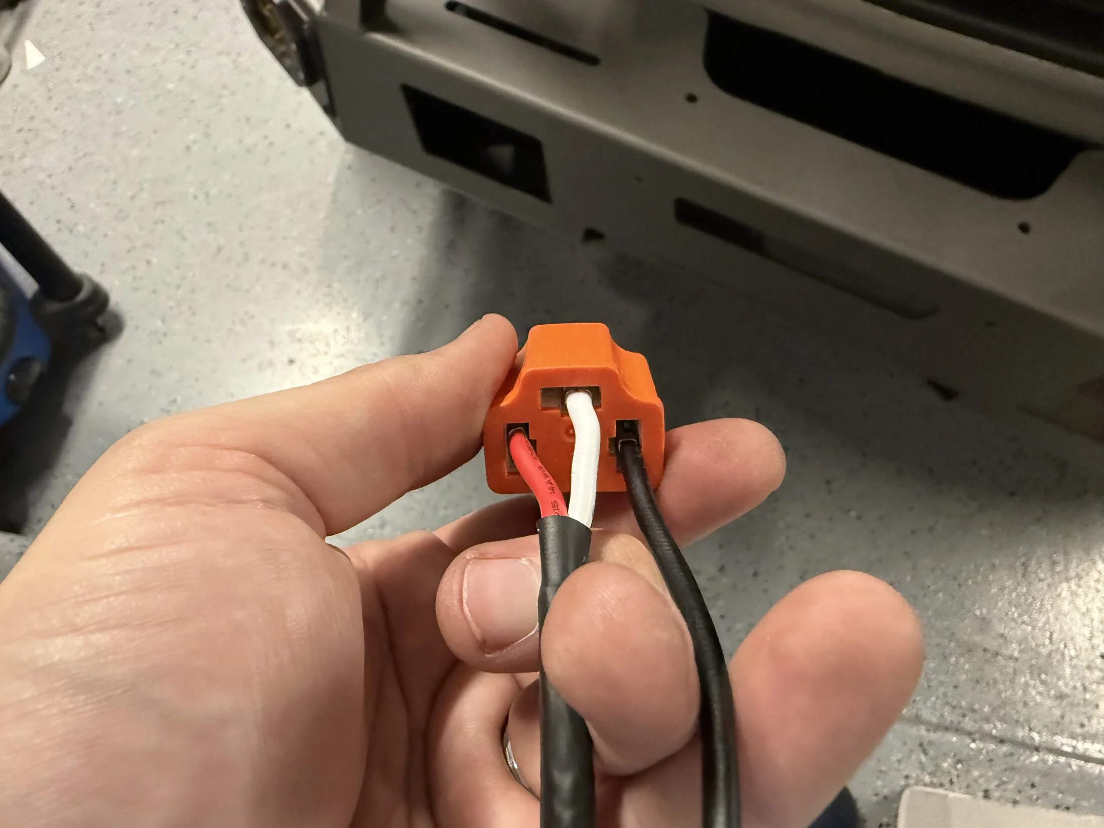

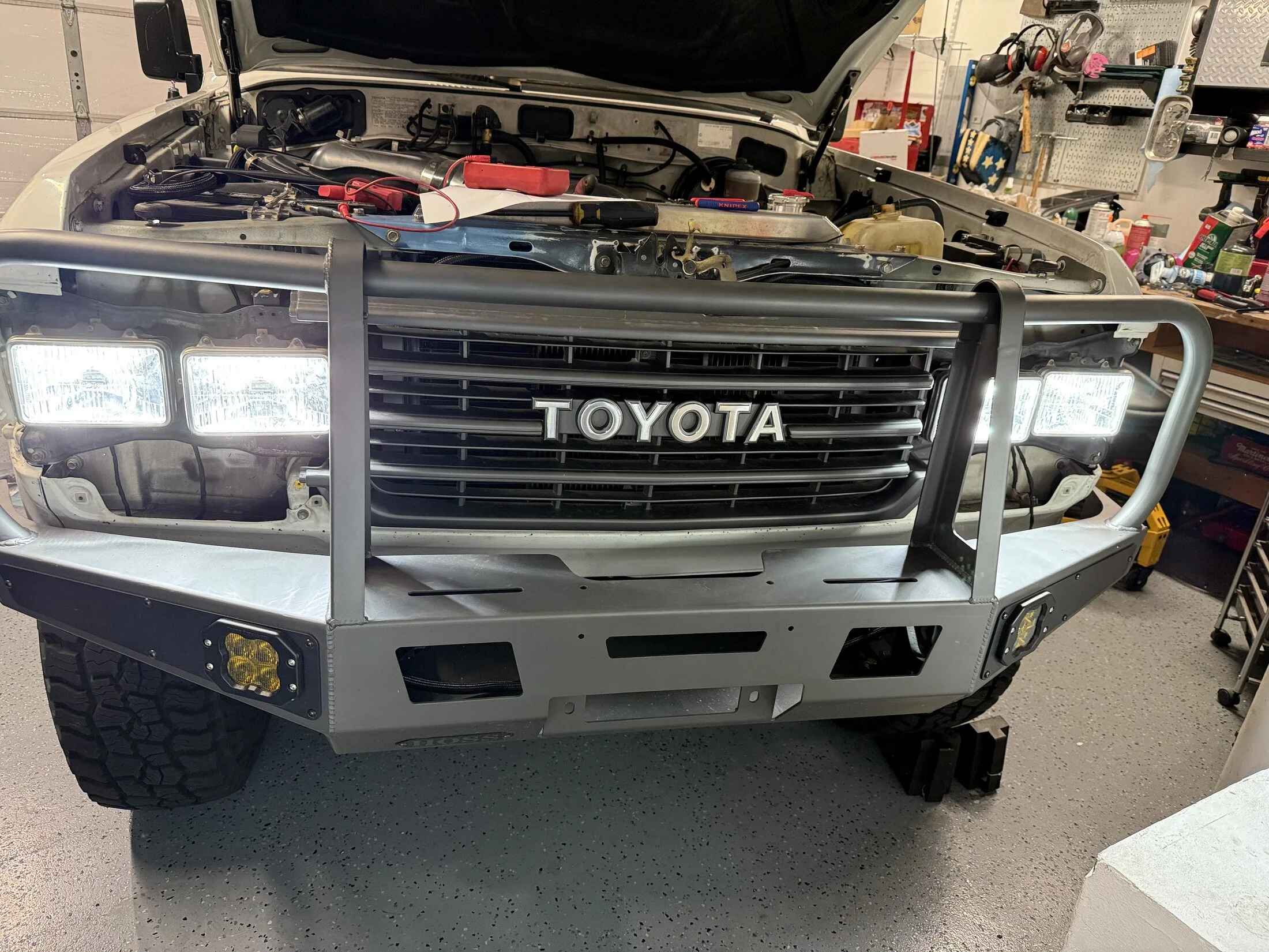

Got the retrobrights installed. Had to do two modifications to get it right. The h840 “Toyota” harnesses don’t work off the shelf.

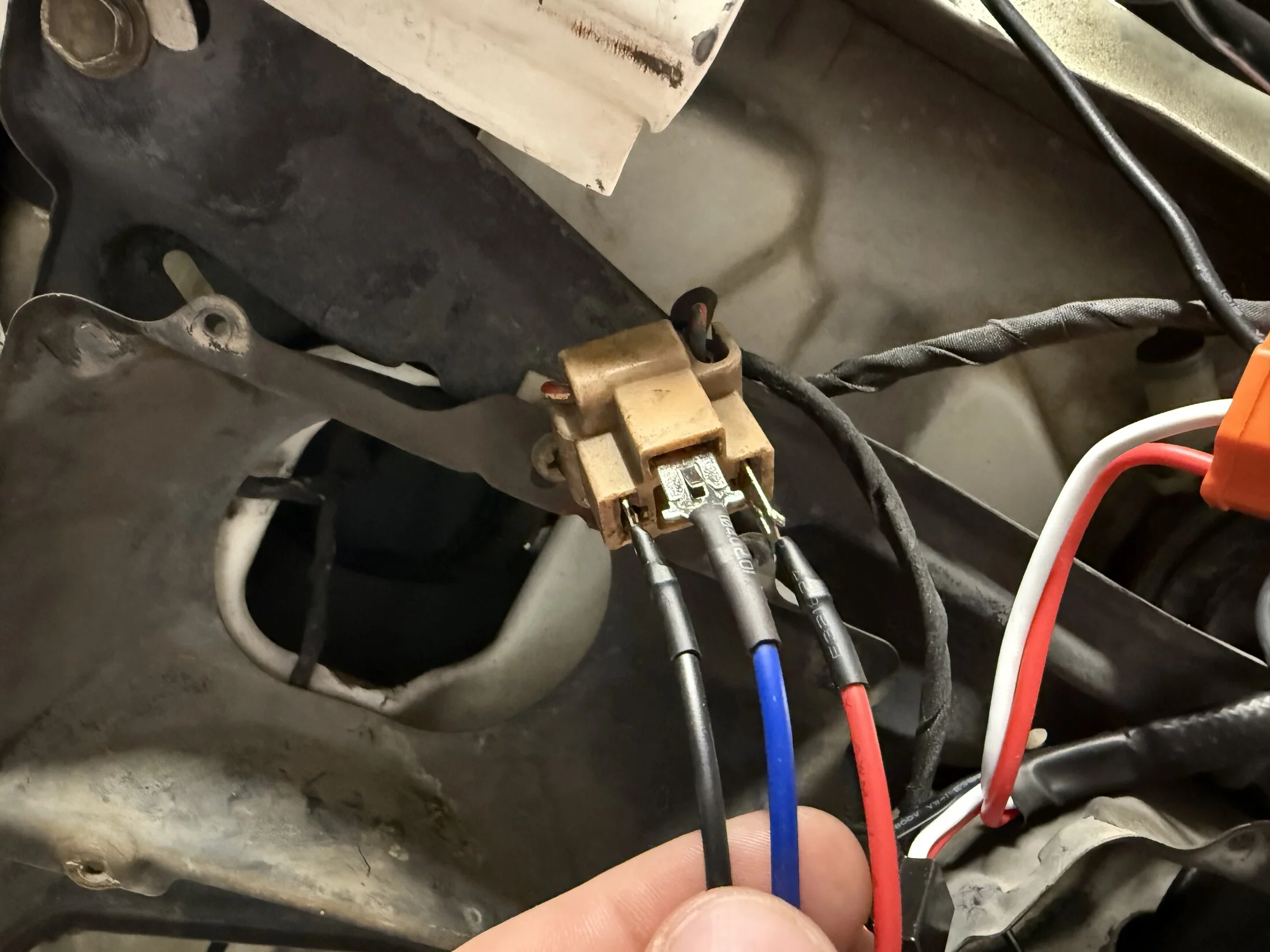

I used one of the universal adapters that come with each headlight to adapt the input to the h840 like this
Then the ground and low beams are pinned wrong on the output of the harness. I just repinned all 4 of those
All 4 low and hi, like it should have always been

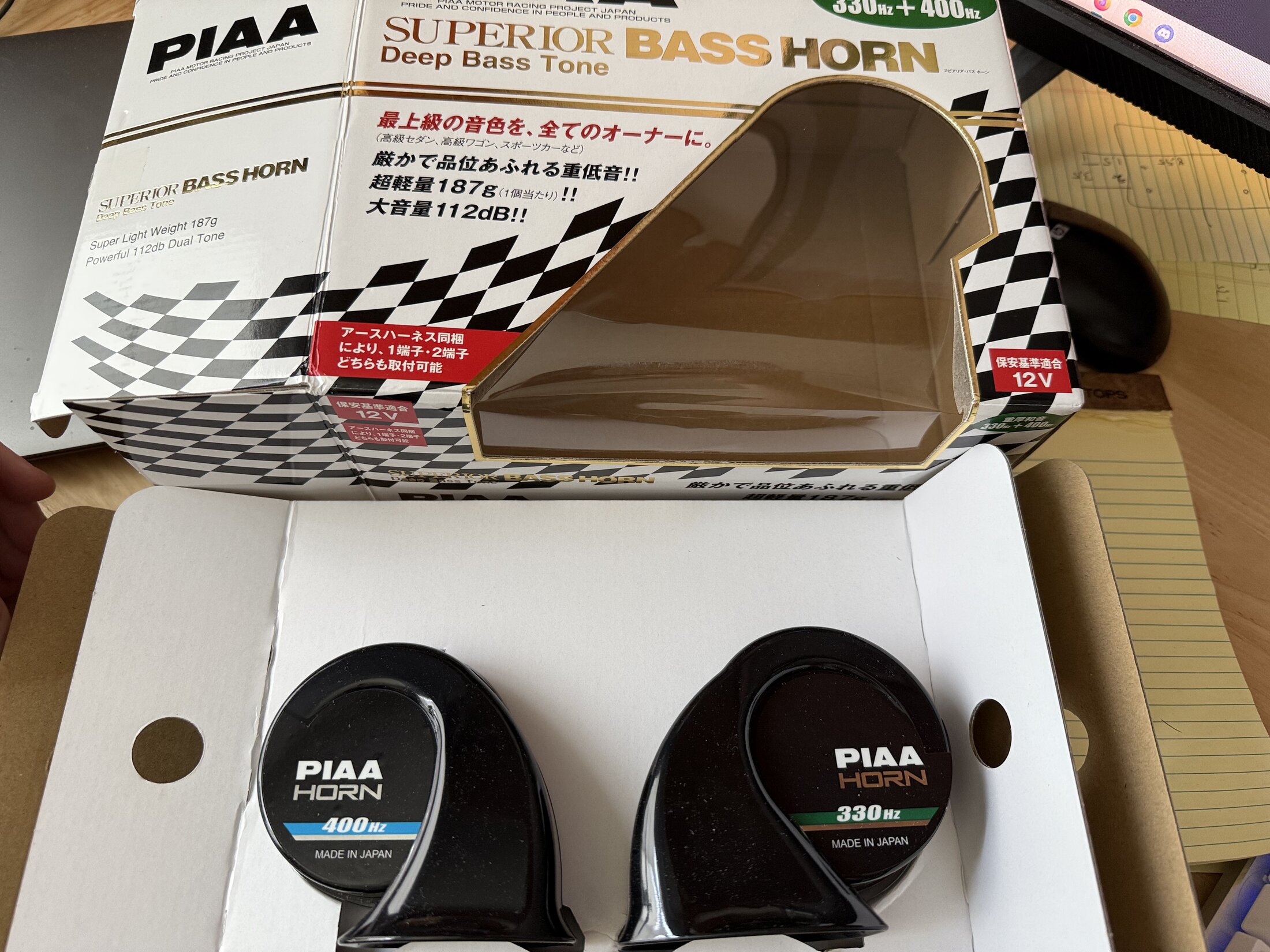

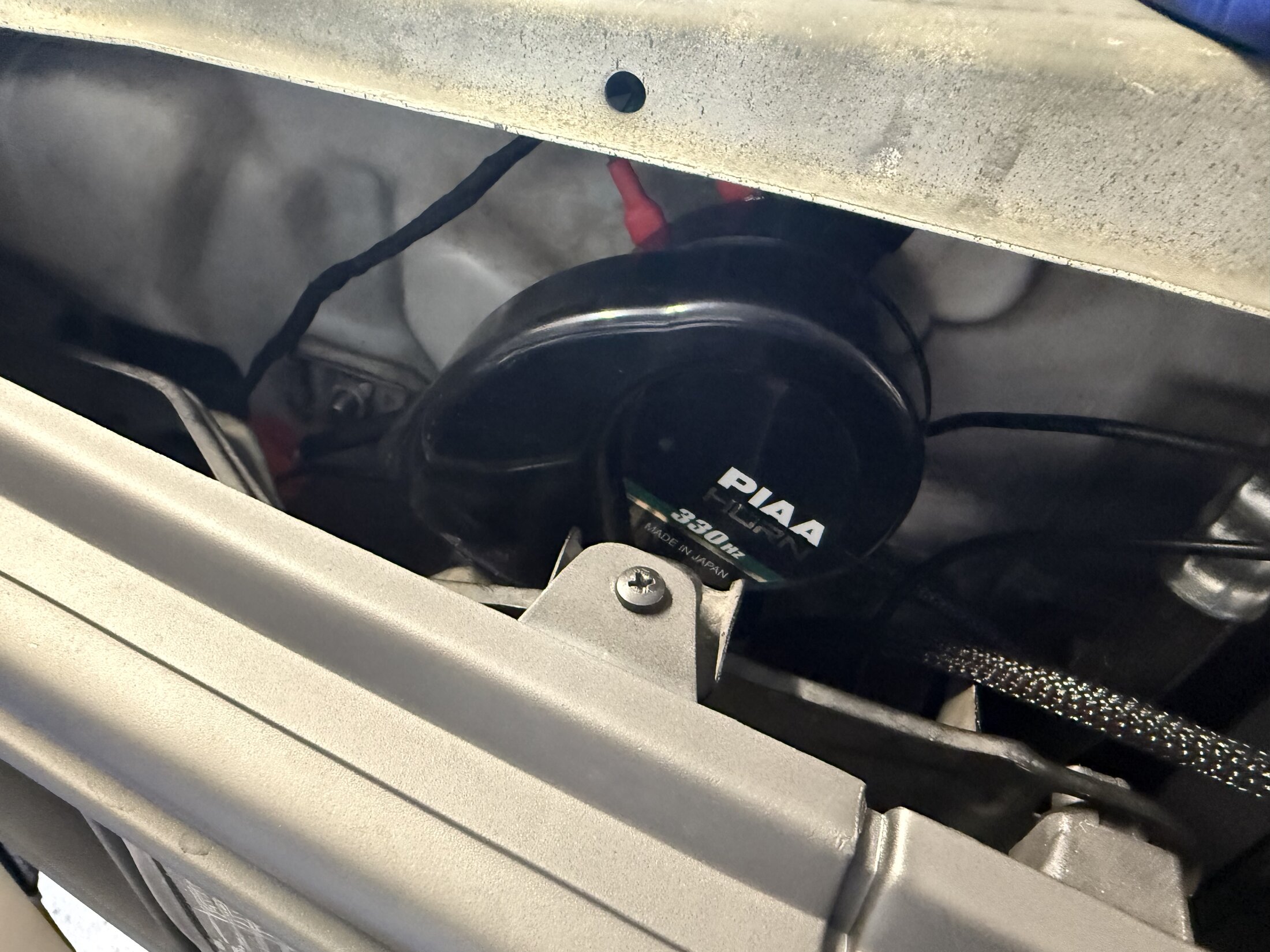

With a newborn in the house, just enough time for a quick install. Swapped the OEM horns for some PIAAs based on @dbbowen post.
Real nice upgrade in tone and volume. I went with the superior bass.
dude those sound great! Now you get to wrench on your truck at absurd hours in the night with the newborn in the house!
