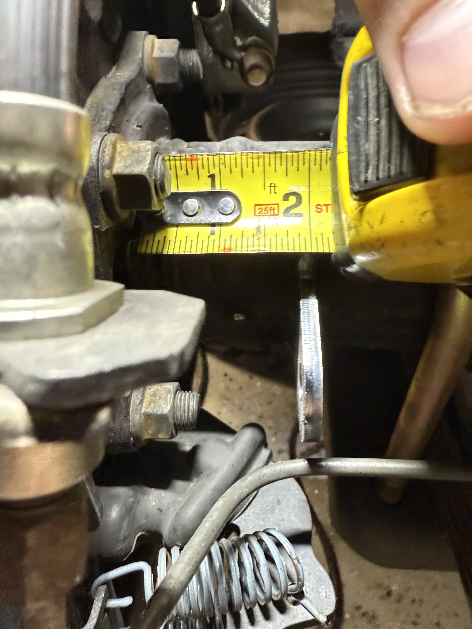

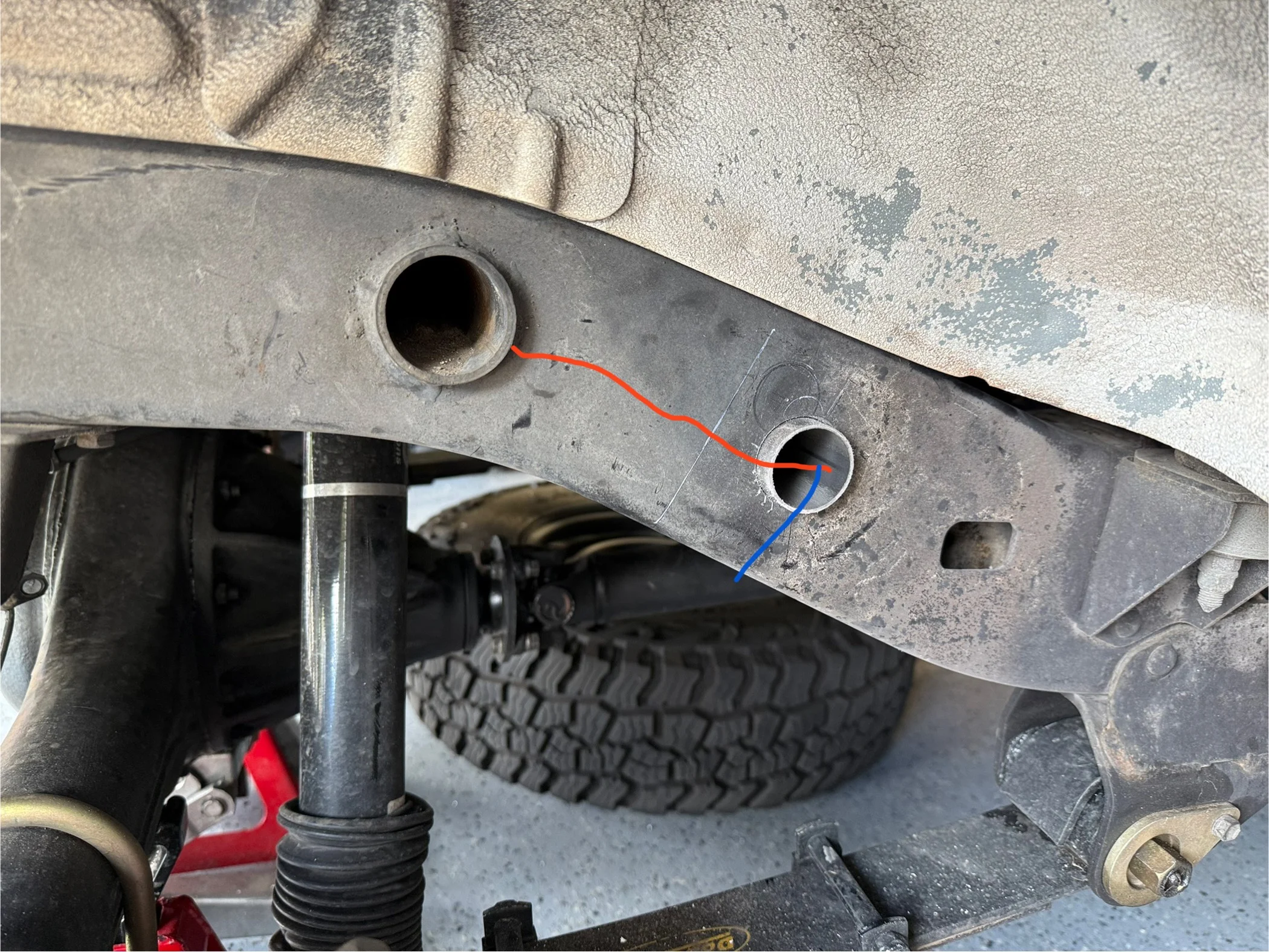

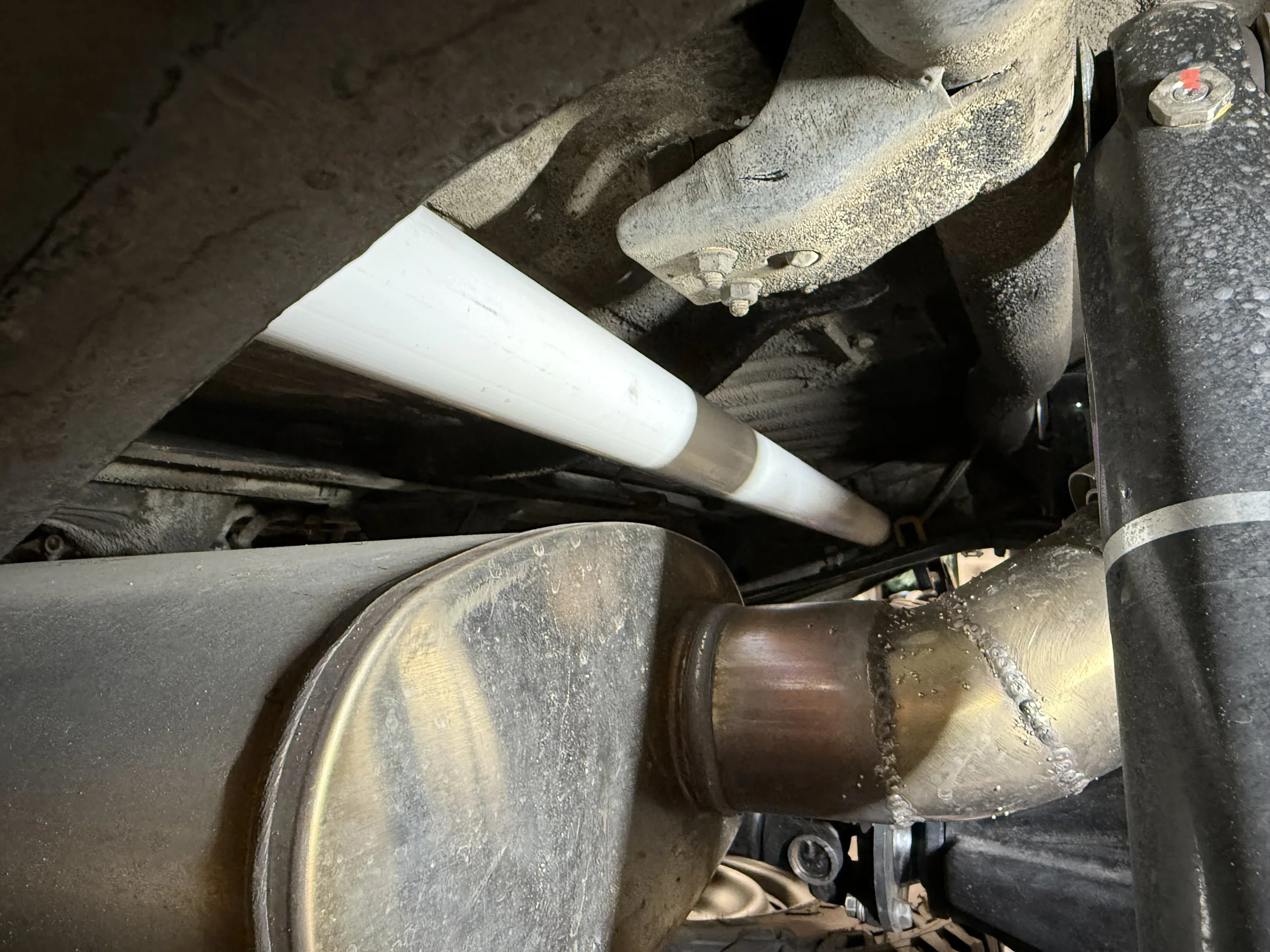

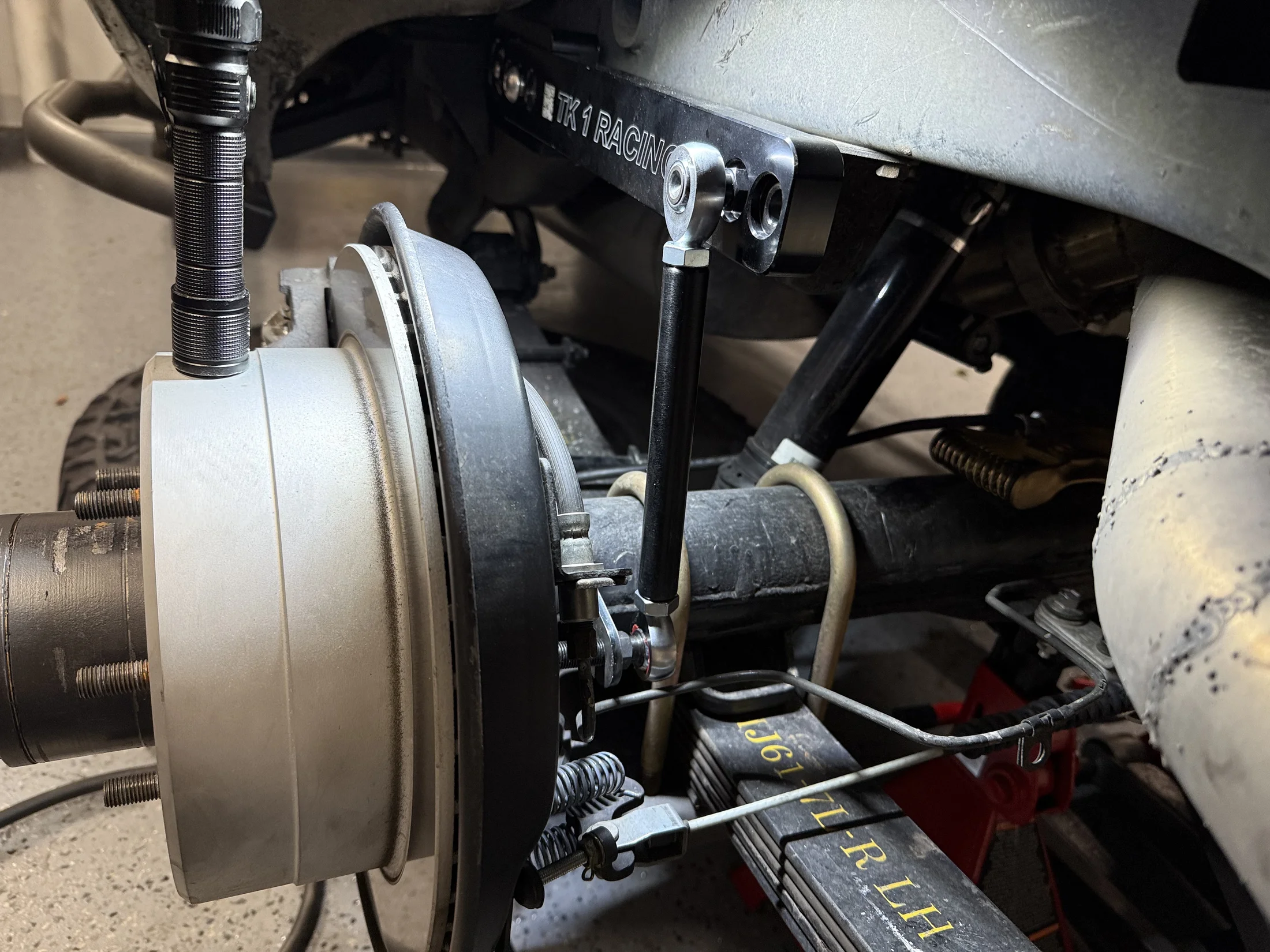

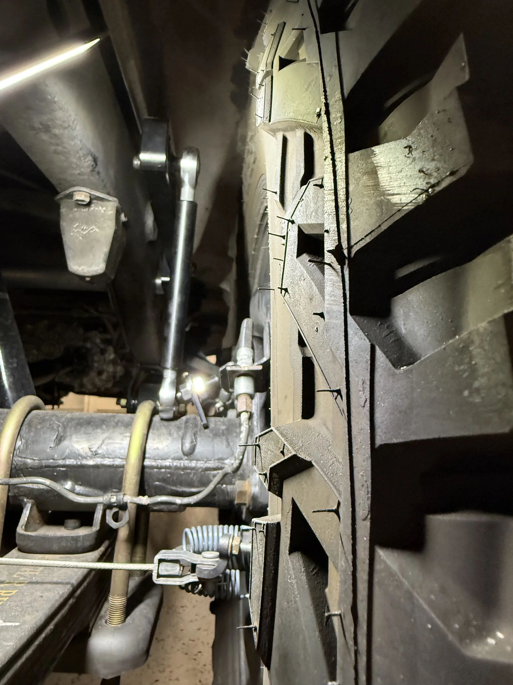

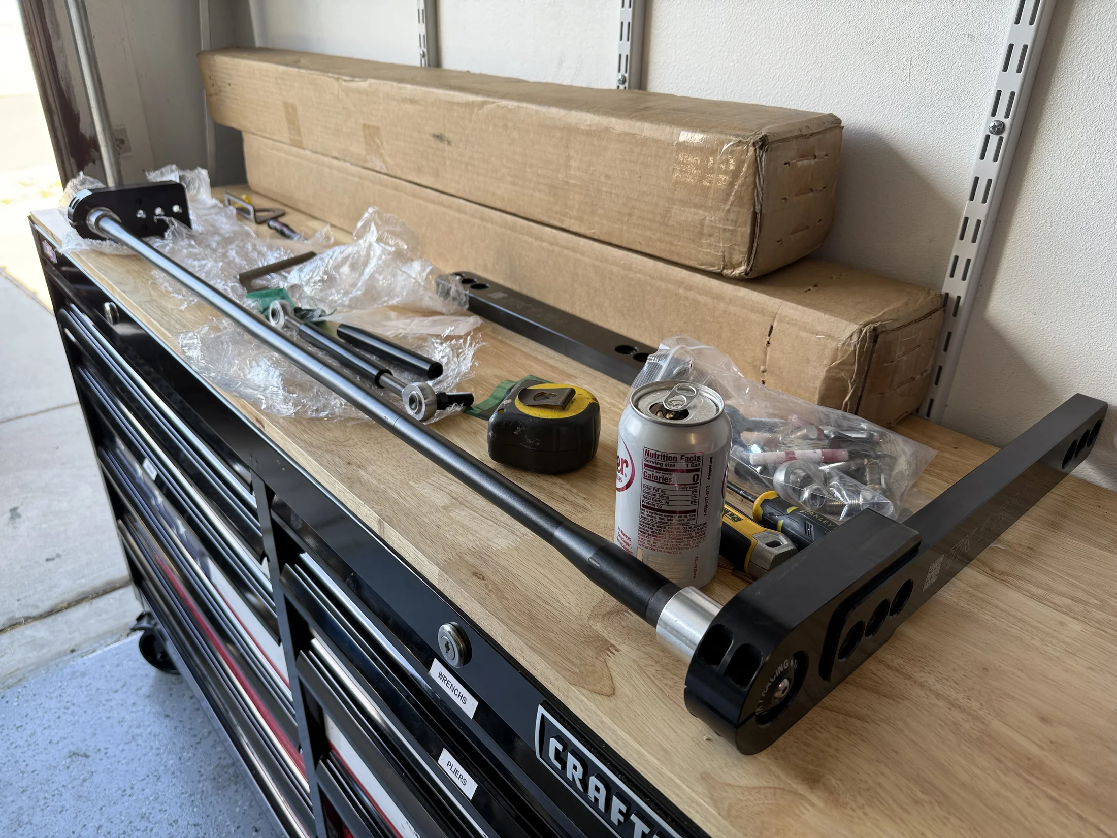

Upon further review, and a strategically cut 1 1/4” piece of PVC tube, we may get away with no line changes
At the swaybar, this should allow for 5” uptravel which is plenty for me.
I run a AN fuel line and custom exhaust with the V8 swap so YMMV on this exactly. From the edge of the shock mount tube to the center of the new tube is 5.25”. Perpendicular to the bottom of the frame, up 2.25”
For the axle side, 2” from the flange, aft side of the axle

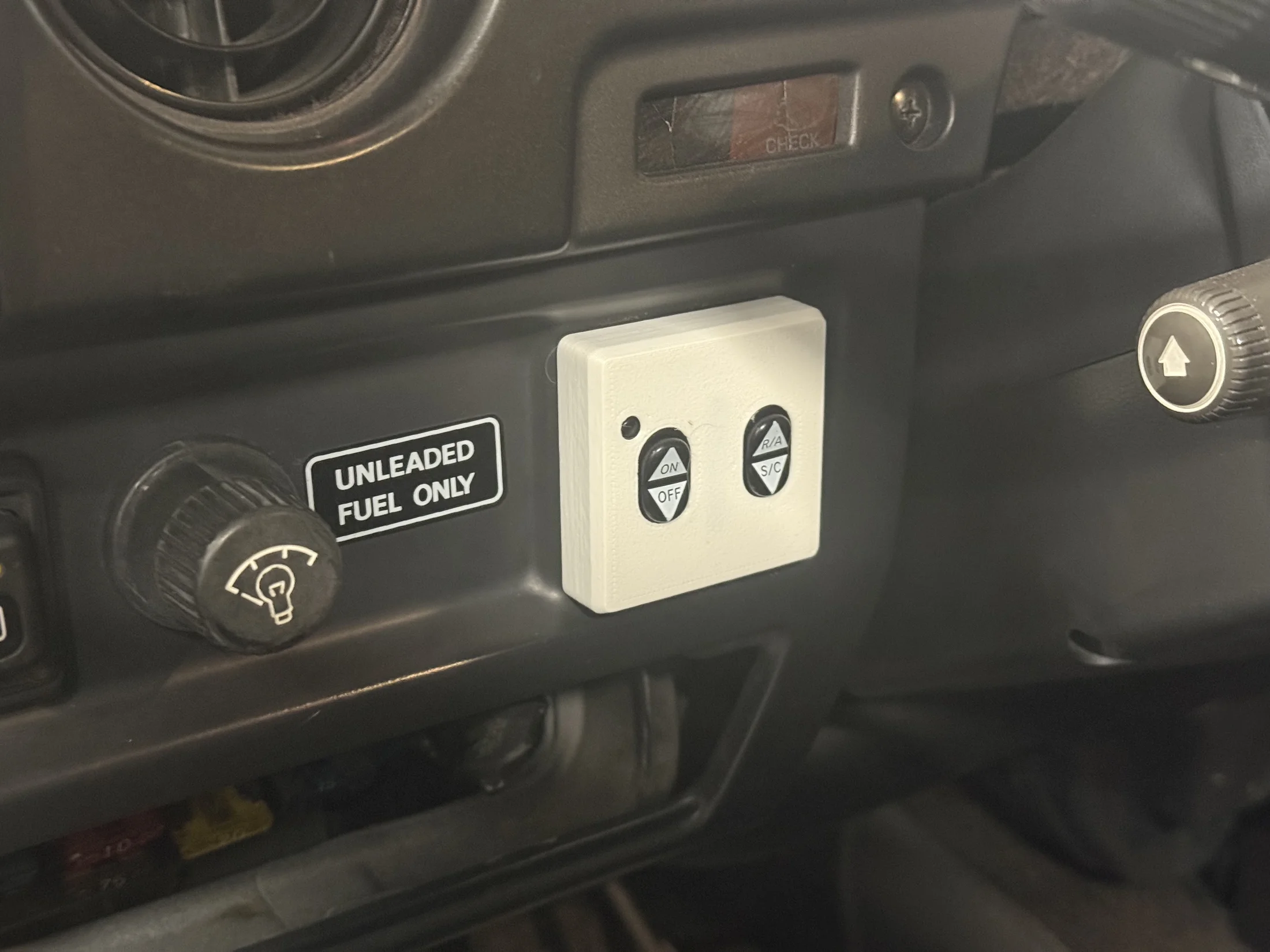

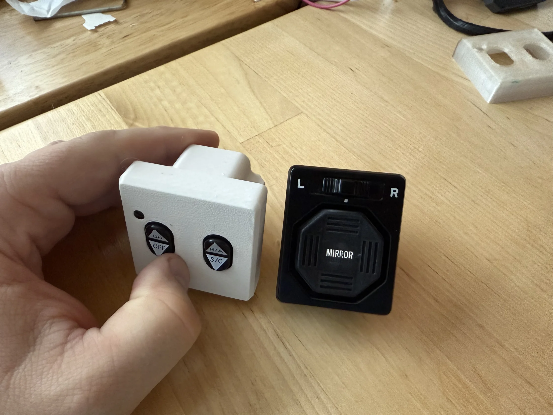

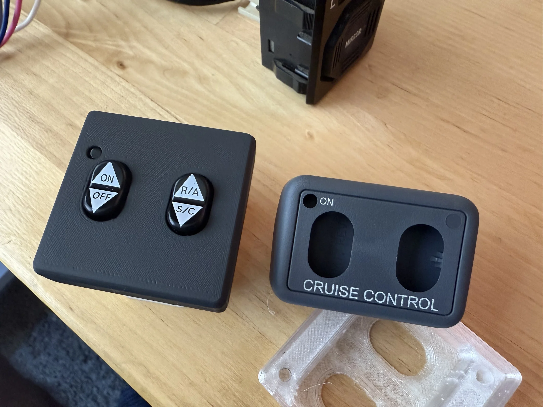

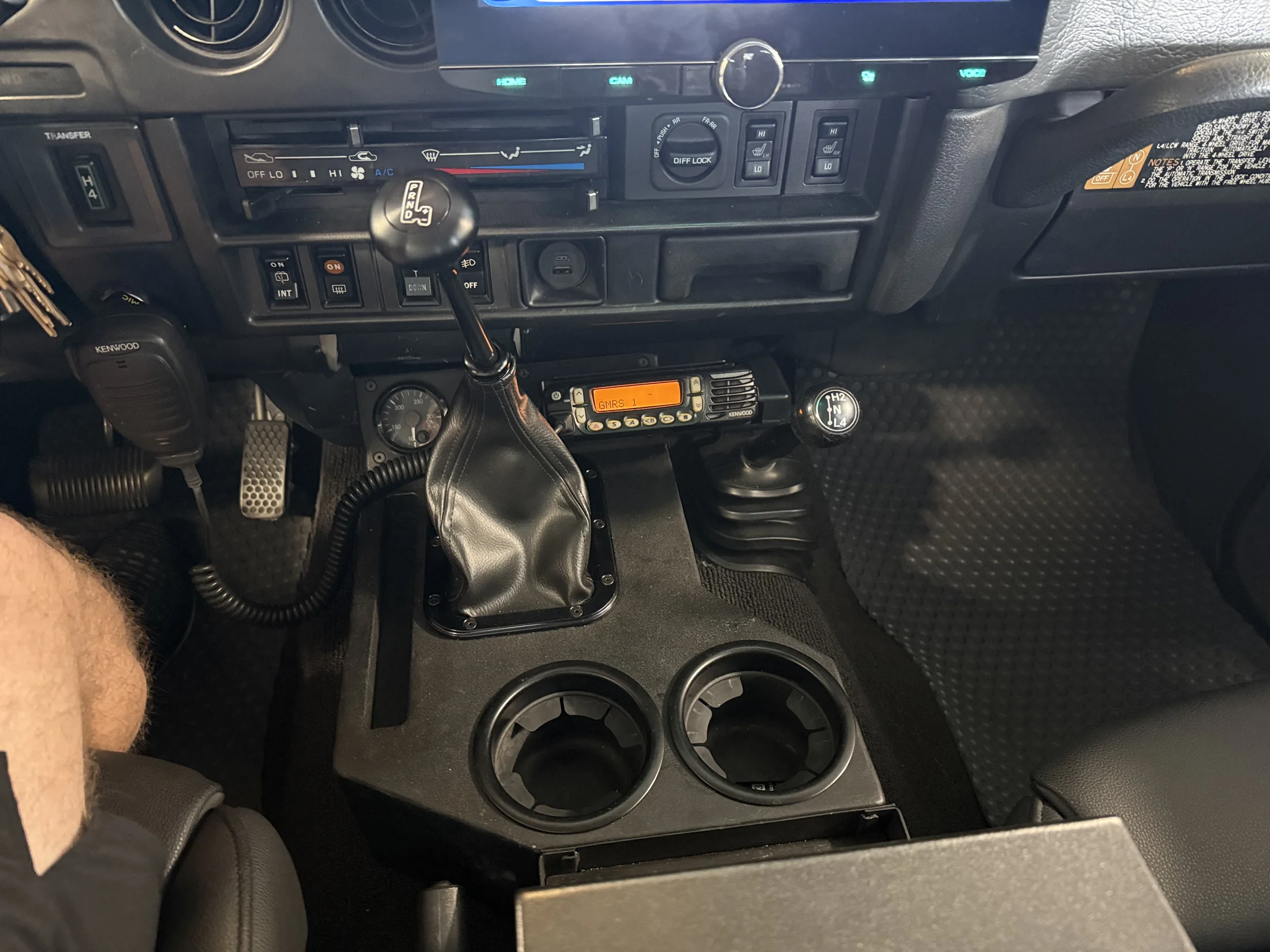

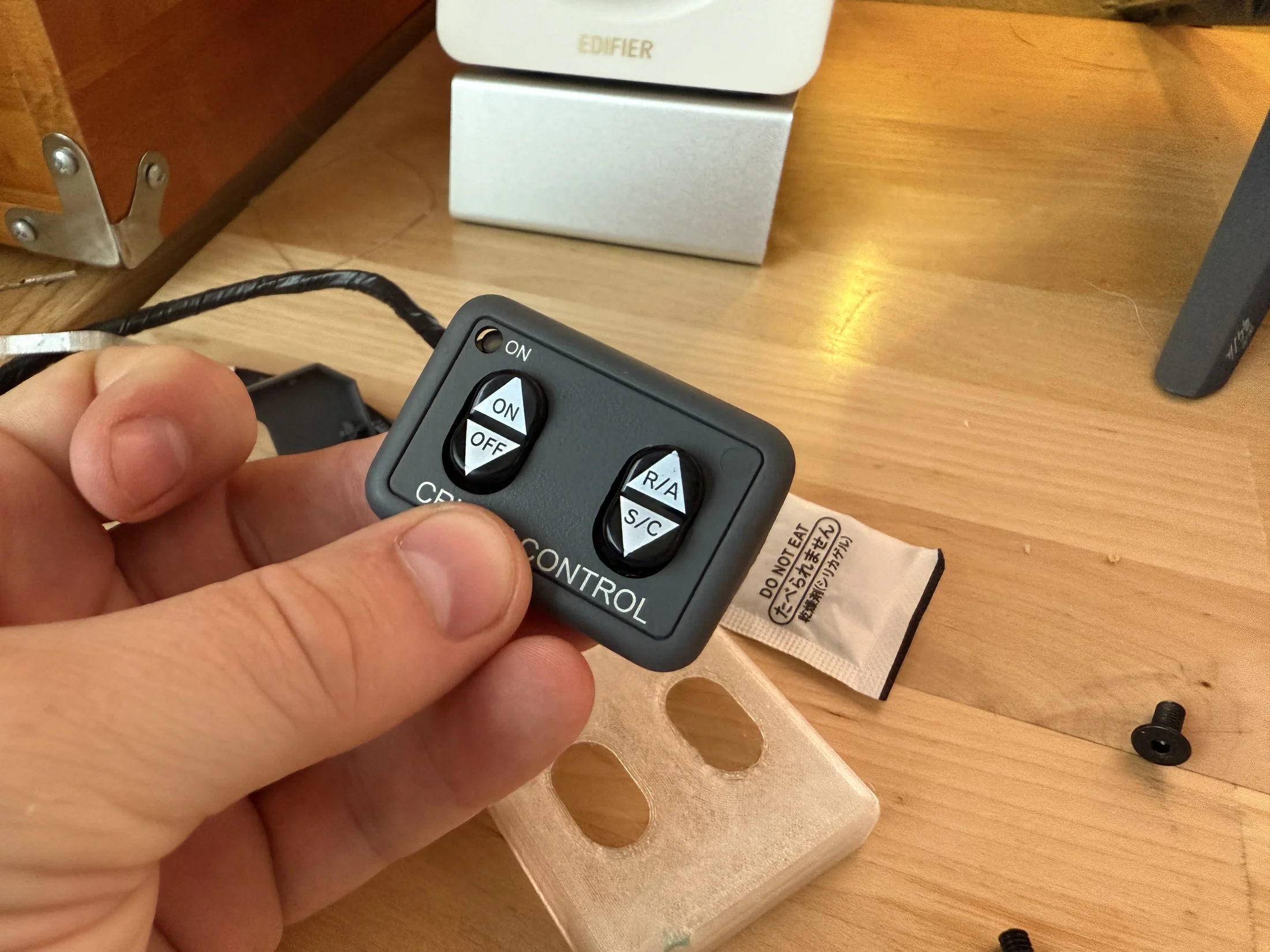

As I slowly prep for my first Land Cruiser roadtrip in October, cruise control lingers in my head. I want to go @dbbowen ‘s method with the 4Runner stalk I got but honestly I’m not prepared to fully restore that stalk and figure out wiring.
This is the cruise control stand in adapter. The housing that covers the circuit board and switches from Dakota Digital sucks. I redesigned it to assemble with 4 screws instead of snaps, and it recreates the interface the mirror controls used to go (I installed 70 series fixed mirrors)
Prototype work, I’ll get some high build primer and SEM paint on it next
View attachment 3986906View attachment 3986907
Super cool. Did you 3d print that enclosure?
Ive been wanting to do this for my scangauge so bad. I moved my rheostat to the right of the steering wheel and that area thats indented to the lefto of where you have this mounted on the metal part of the dash is completely clear for me on my truck. I was wanting to 3d print something to sit down in that valley and take the guts out of the scangauge and 3d print a new flush mount housing for it to make it look like part of the dash. My attempts have all been... not great so far haha. The plan was to cut a hole in the metal dash and mount it like in there.
Yup it’s hard to repackage those parts. Happy to provide any help I can if you need

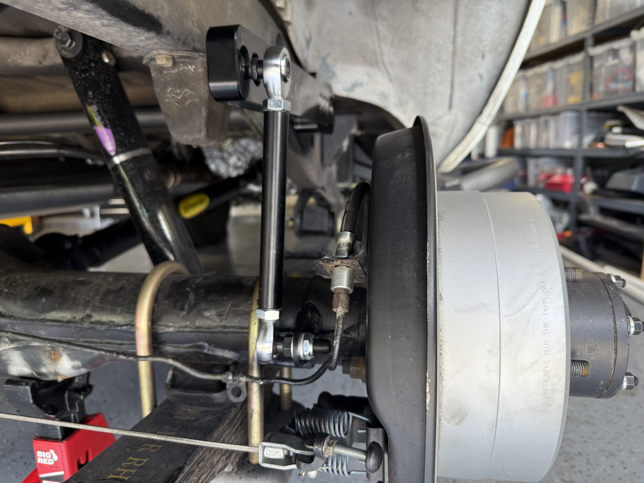

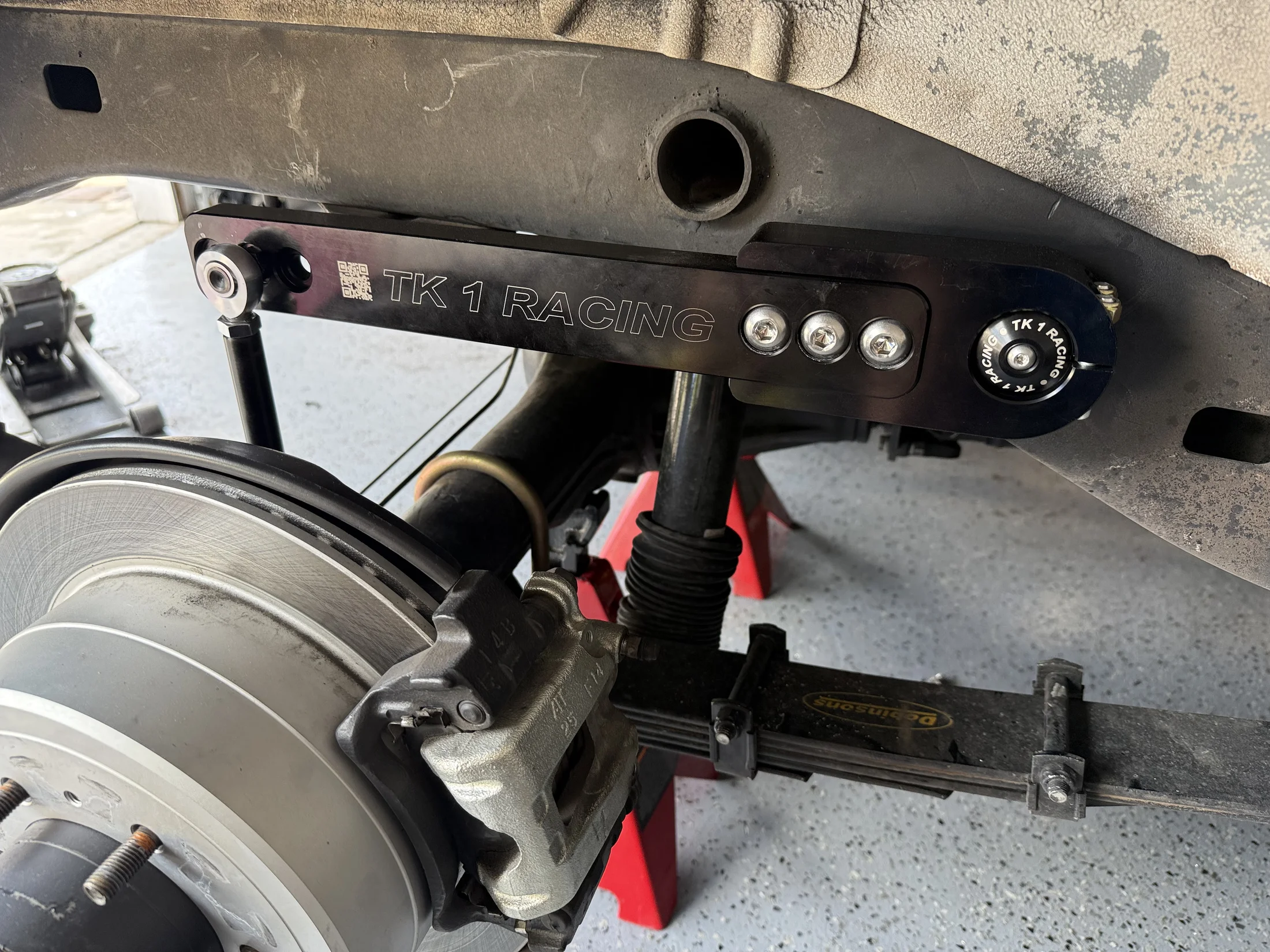

More pictures of something that you will never see and I can’t describe.
But! Major improvement. I don’t remember what the stock 62 felt like since I owned it stock for like 2 weeks. Highly recommended. Body roll significantly reduced
Nice work! Seeing this makes me wish I would have went this route instead of the OEM Fj62 rear sway bar. I guess I still could.. Is there a bearing/bushing or something the lives in between the frame and the sway bar?
Yup 80 axle. And yes there is an aluminum spacer between the welded in tube and the bar itself, and a Delrin/teflon washer between the aluminum and the swingarm
