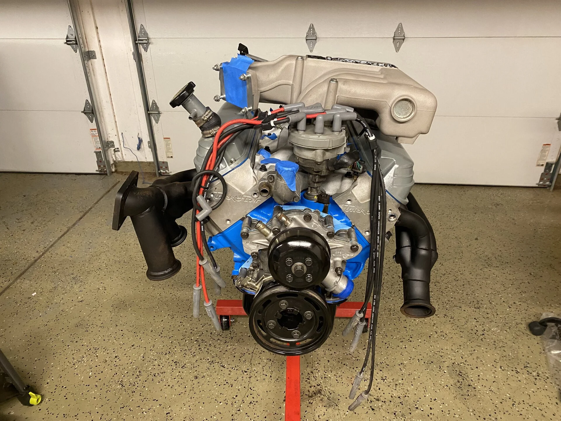

helped a friend with more 302 fun. Thing is going to get a turbo.

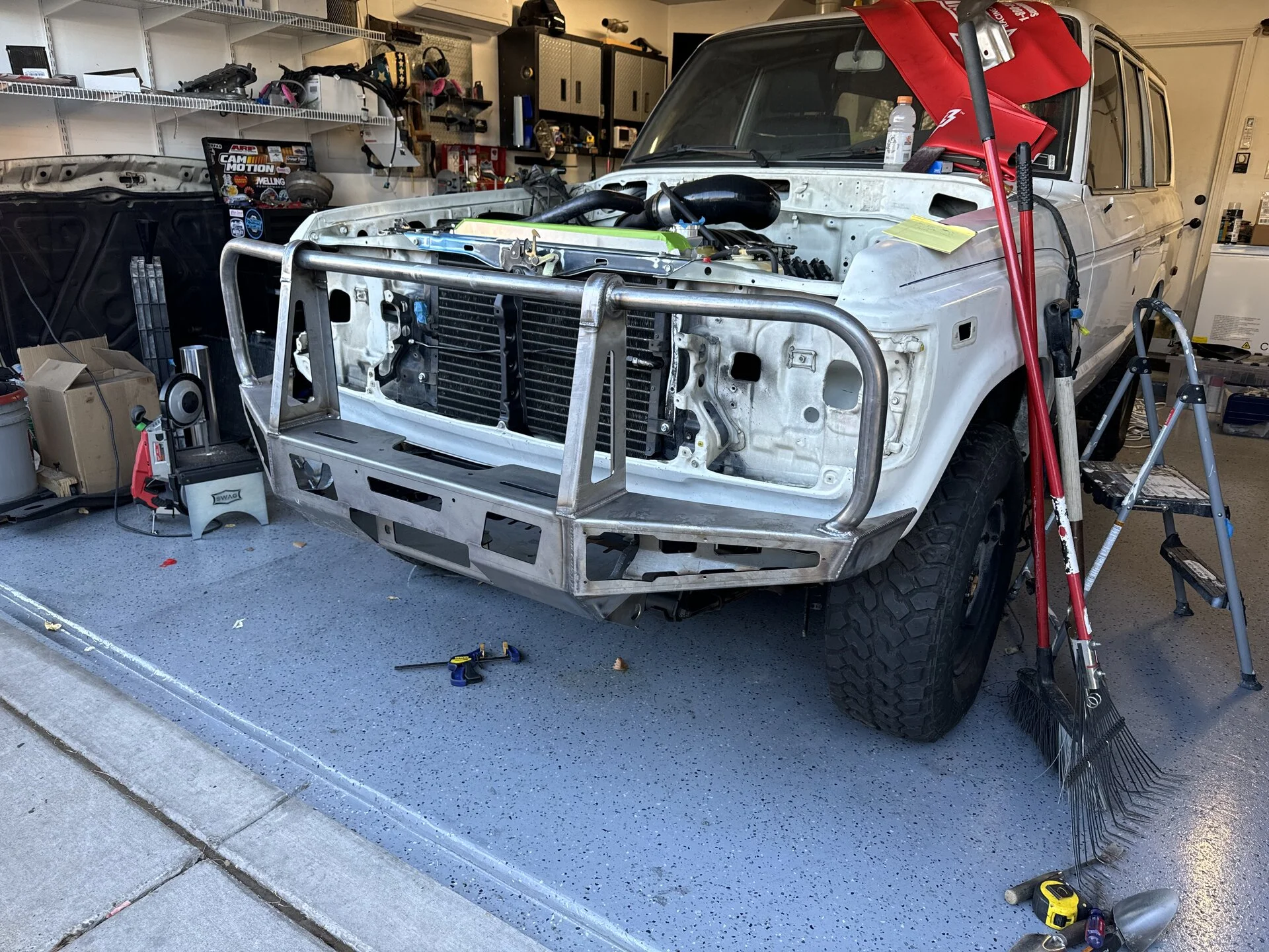

Busted my toe but managed to throw the dissent bumper on for fun
That bumper looks awesome. What color you going with? And do I remember that you said somewhere you’re going to paint your rig, too?

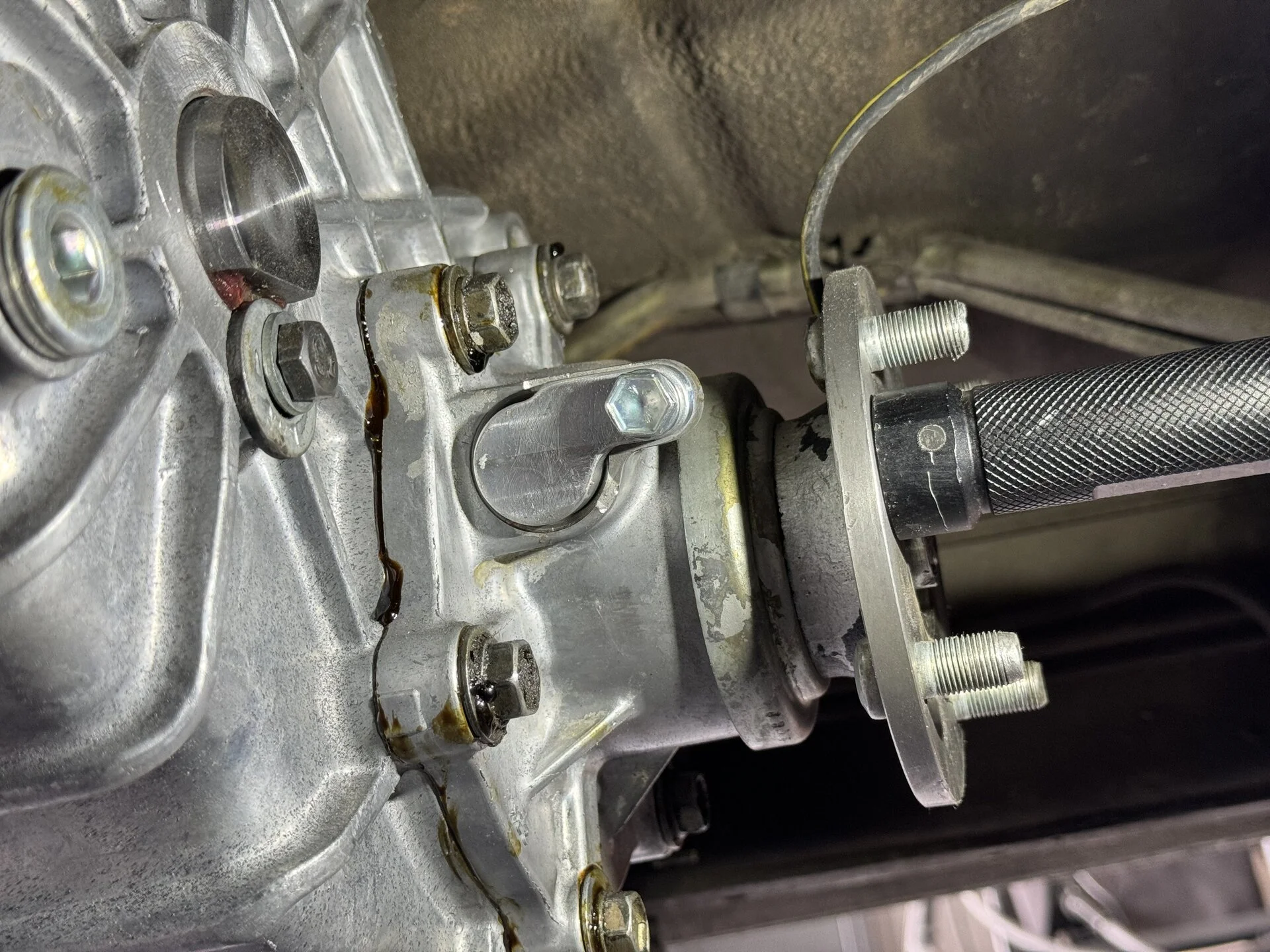

Yes that washer holding the intermediate shaft in is wrong. She seems to have disappeared in the rebuild
You should have mentioned! I would have thrown one in with the parts. I have plenty of them new and used. :lol:

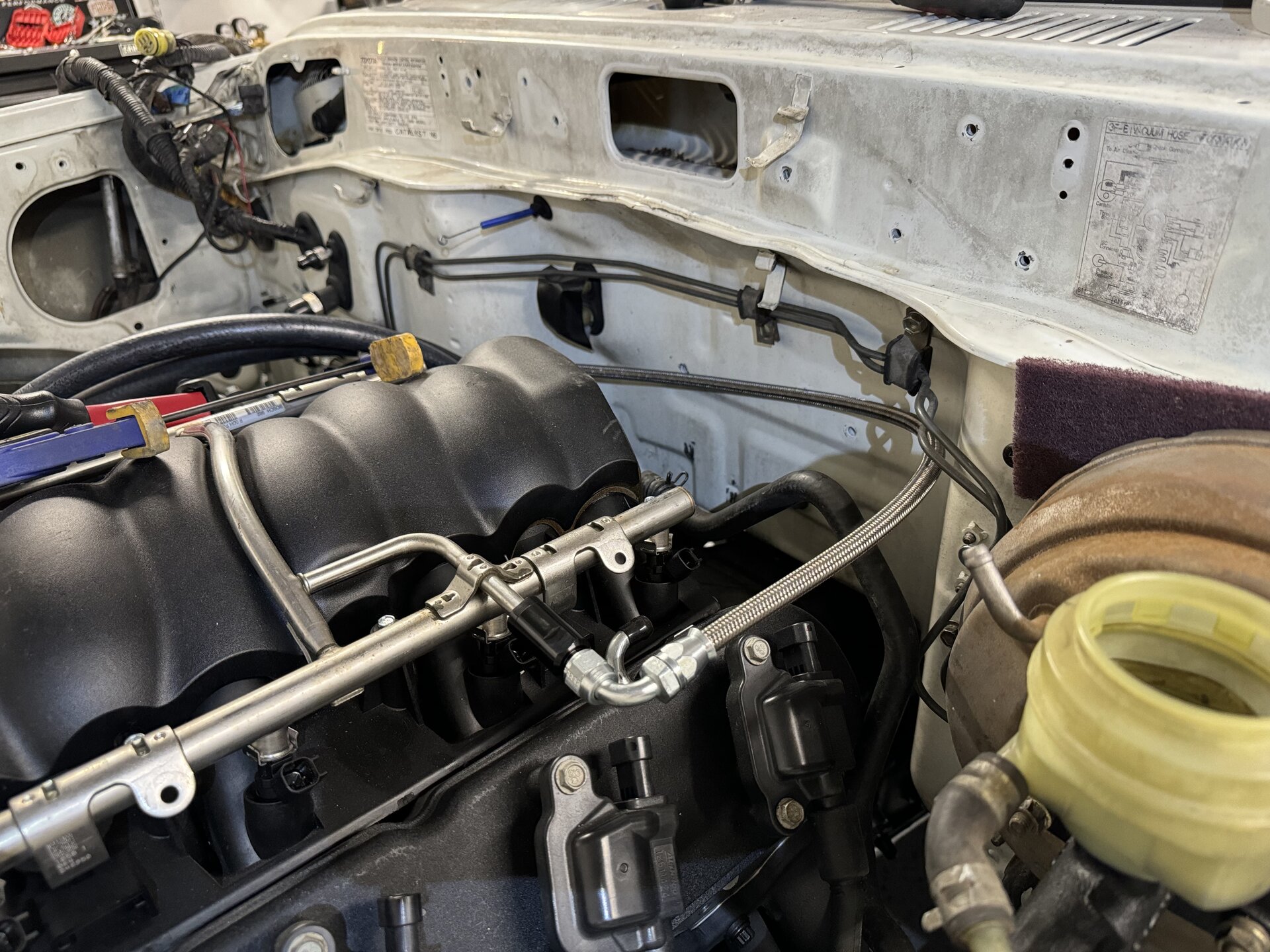

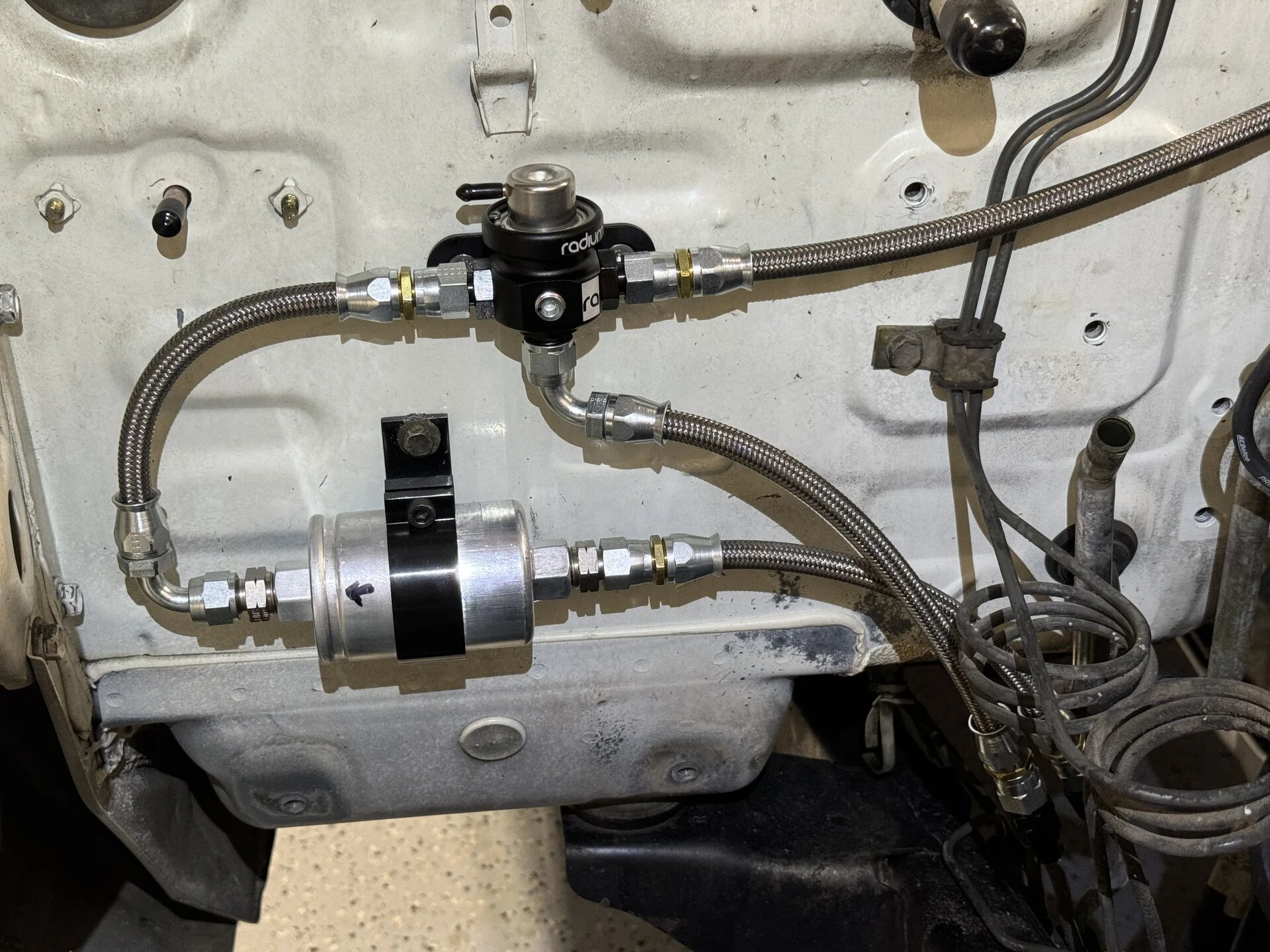

Finished up the PTFE lines for the fuel. Went with a fixed pressure regulator from Radium. Has a drop in Bosche regulator. Reasons include apparently the “corvette filter regulator” is widely counterfeited and hard to find a real one. So I went discrete on filter and regulator
Just needs some adel clamps, .500” I have are slightly too large. Hose OD is .450”

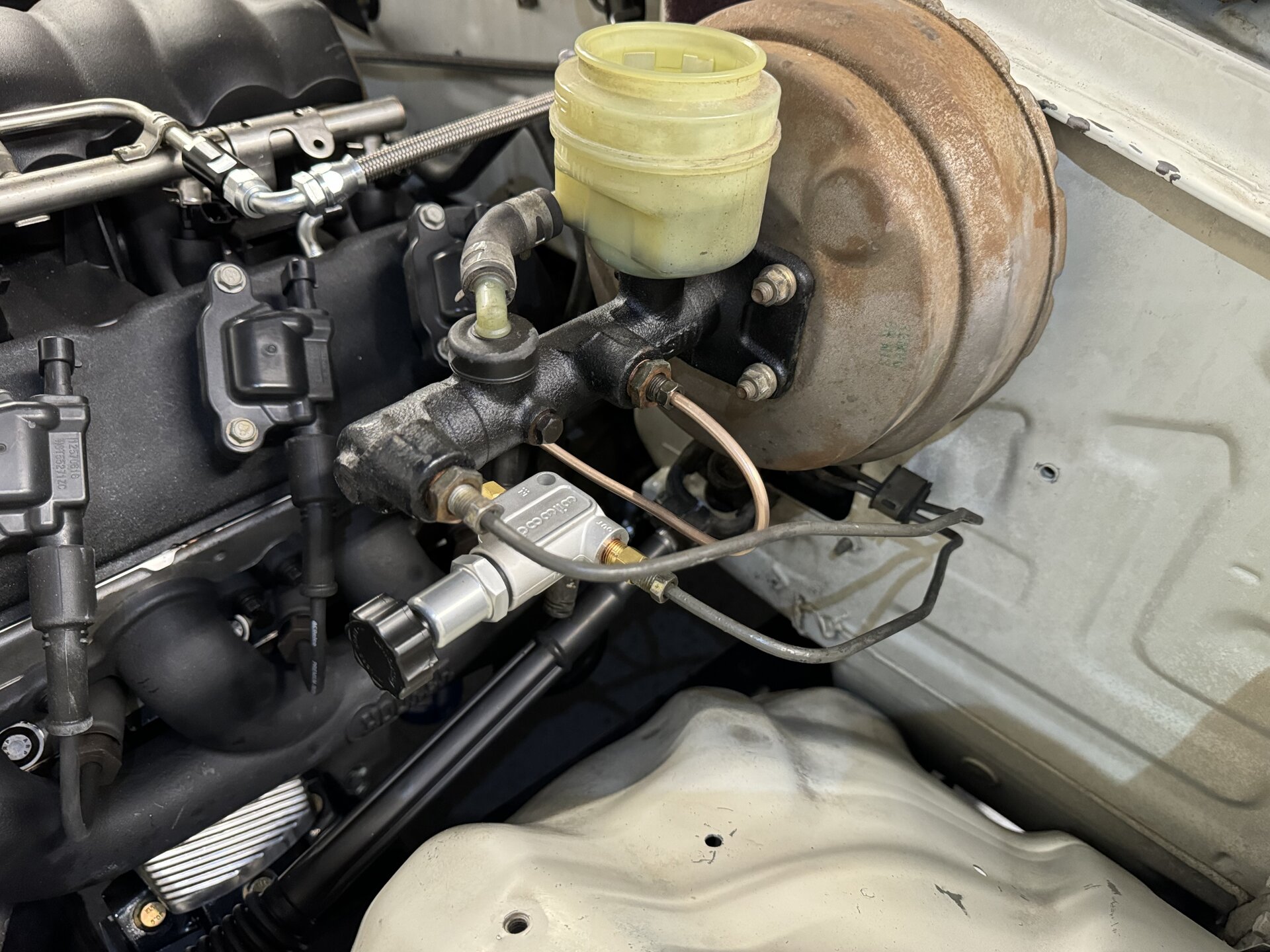

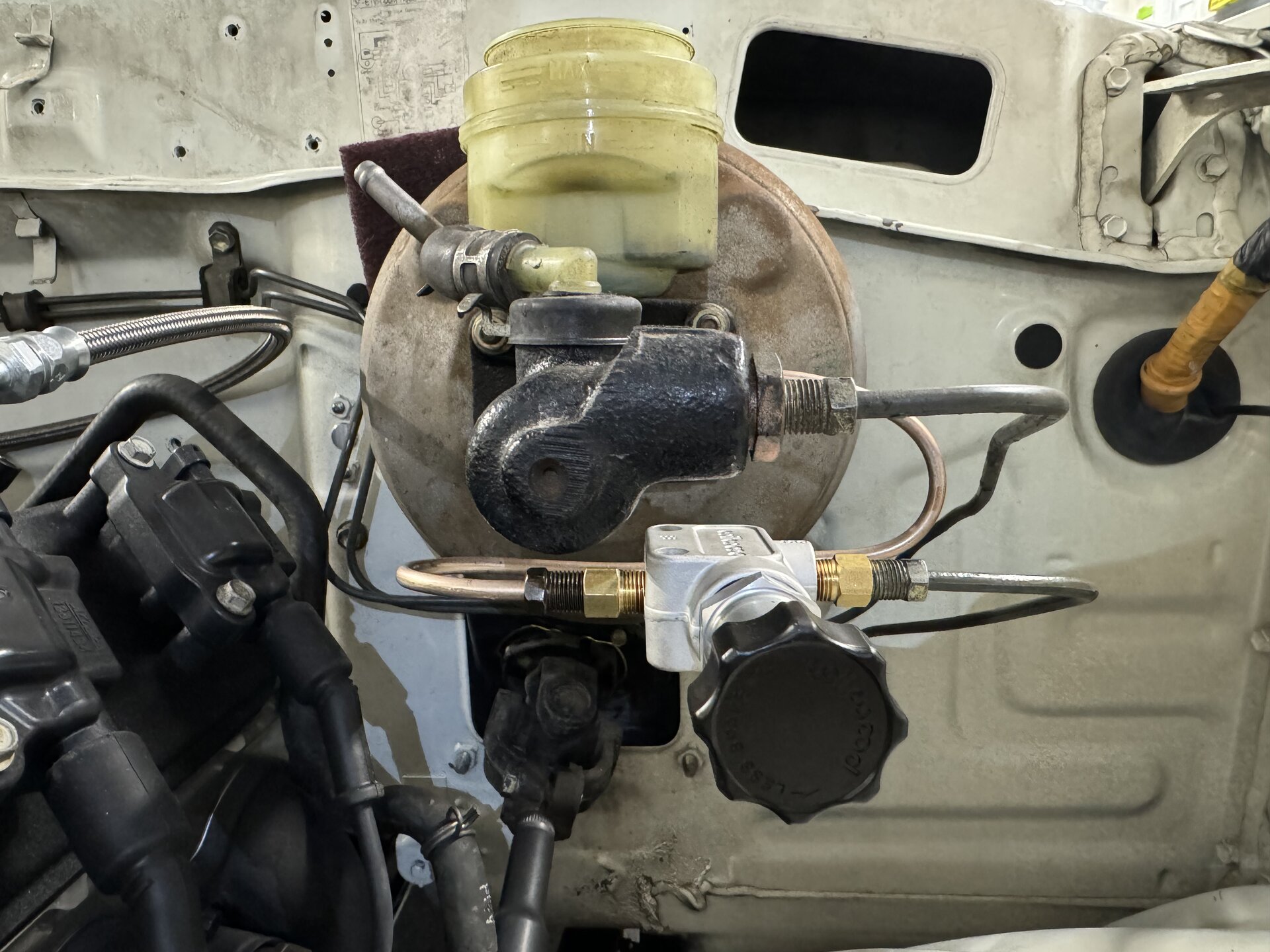

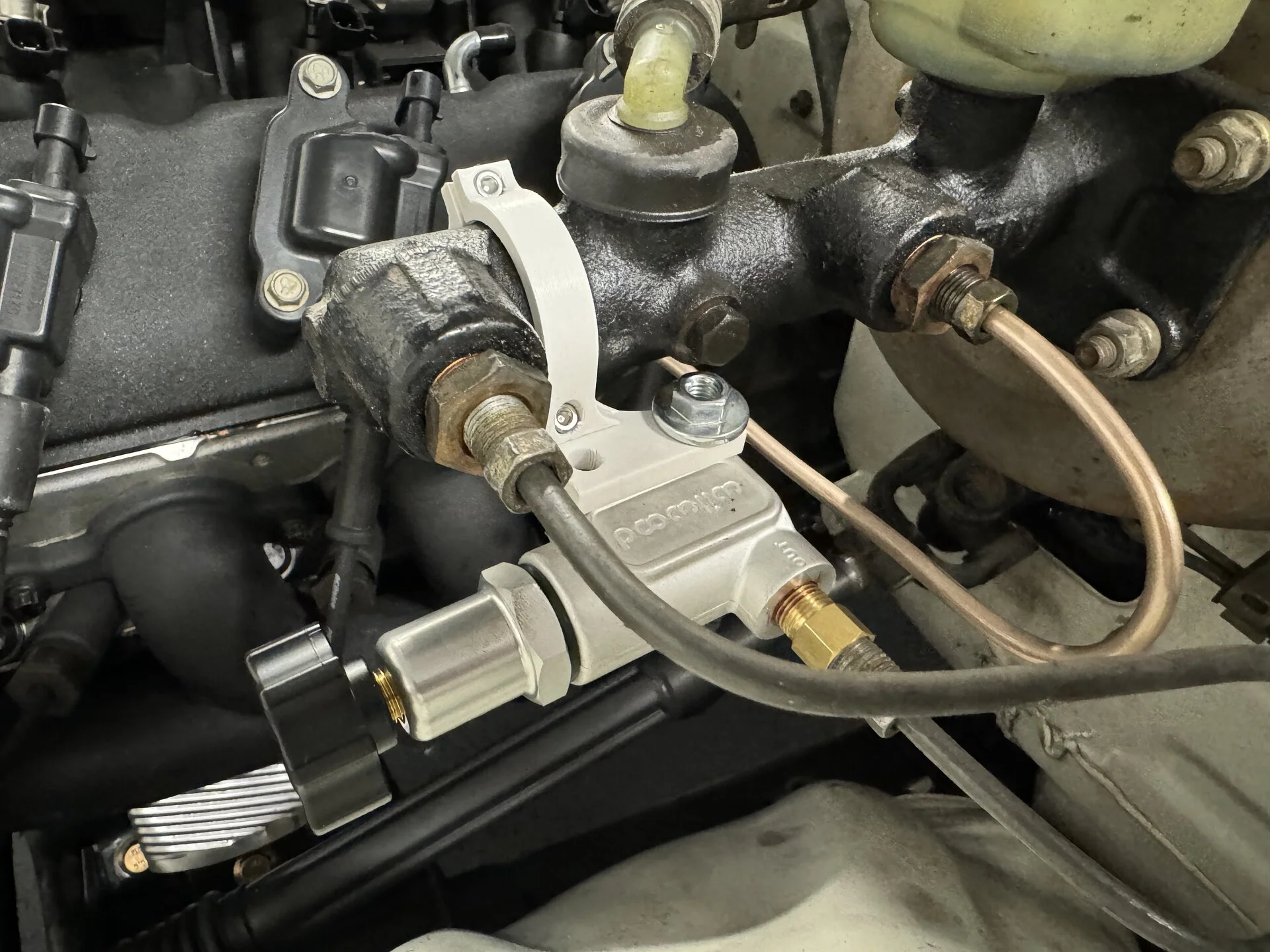

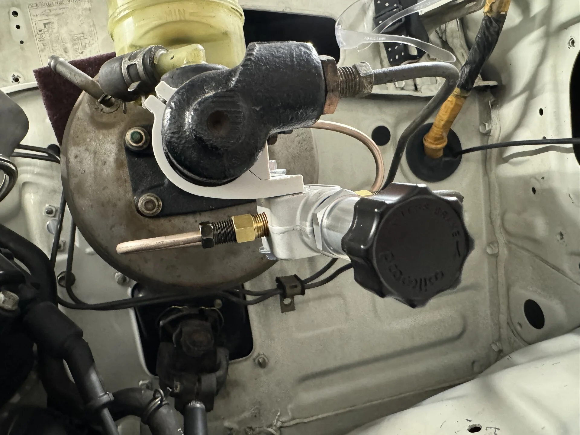

test fit the LSPV replacement. Got this on with adapters from FlyingMiata, but I found something similar at CityRacer after it was ordered.
I am designing a 3D printed bracket for the valve to master cylinder. Going to have to be ASA for under hood heat. That might not even be enough
I've been looking for nice an line clamps that can be mounted to the chassis or body haven't really found anything that I like yet and ptfe lines are smaller that regular an line.
the OD is basically 7/16" which is annoying. Everything is 3/8 ID or 1/2 except for a few Sandvik Marine ones but they aren't cheap
