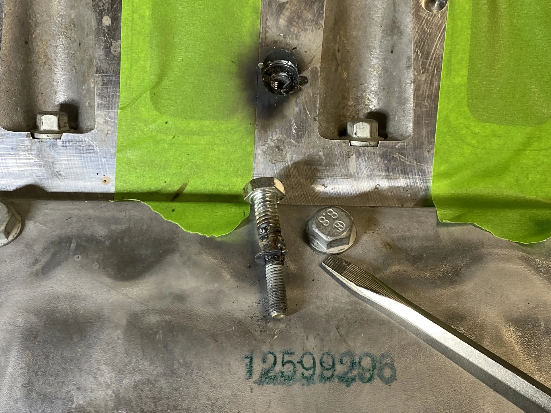

Got a mig welder? Thats aluminum. If you use er70s-6 wire for mild steel on a nut that will fit in there somehow you can try doing that. The question is... what nut can you get in there haha
I might get some hate for this... but get some black FIPG and put it around the rubber "gasket" on that oilpan on the side where it mates to the block. Every single one of those ive ever installed has leaked until i started putting the FIPG on them. Run a very thin bead and put a good sized goop in the corners. They like to leak in the middle of the longer straight side on the passenger side. Since I started doing the FIPG, none have leaked and mine and the one other that i had to drop the pan to apply it.. havent leaked again either
Yup got a welder and suitable wire. I agree the hard part is finding a nut that fits and a socket that fits that counterbore.

Milwaukee 3/8 on setting 2 is the torque spec for those intake bolts

washer then bolt trick worked nicely

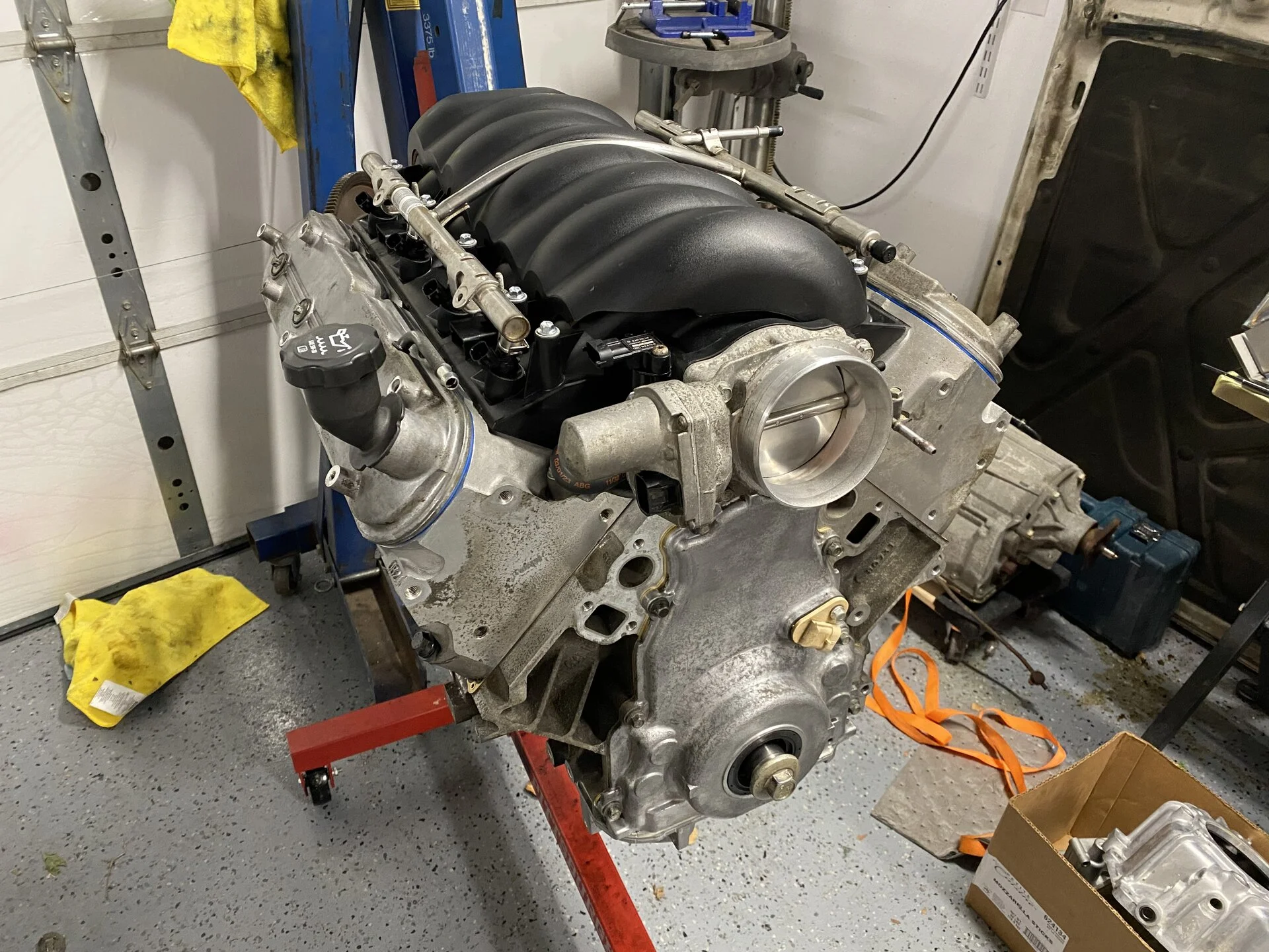

Word of wisdom, intake manifold bolt holes in your heads are thru holes directly above the lifters…. So I chased the hole that I snapped and realized this….
$250 later for new MLS gaskets and some ARP head bolts. but the lifter valley is clean of aluminum dust

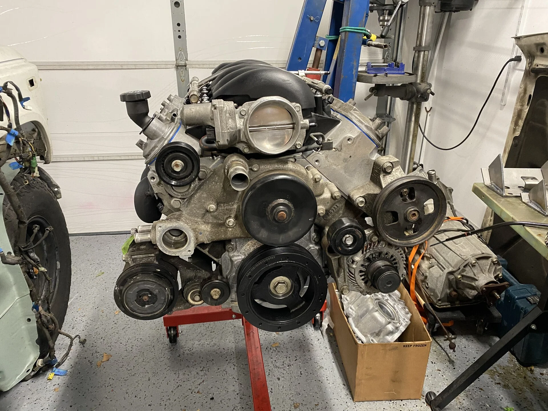

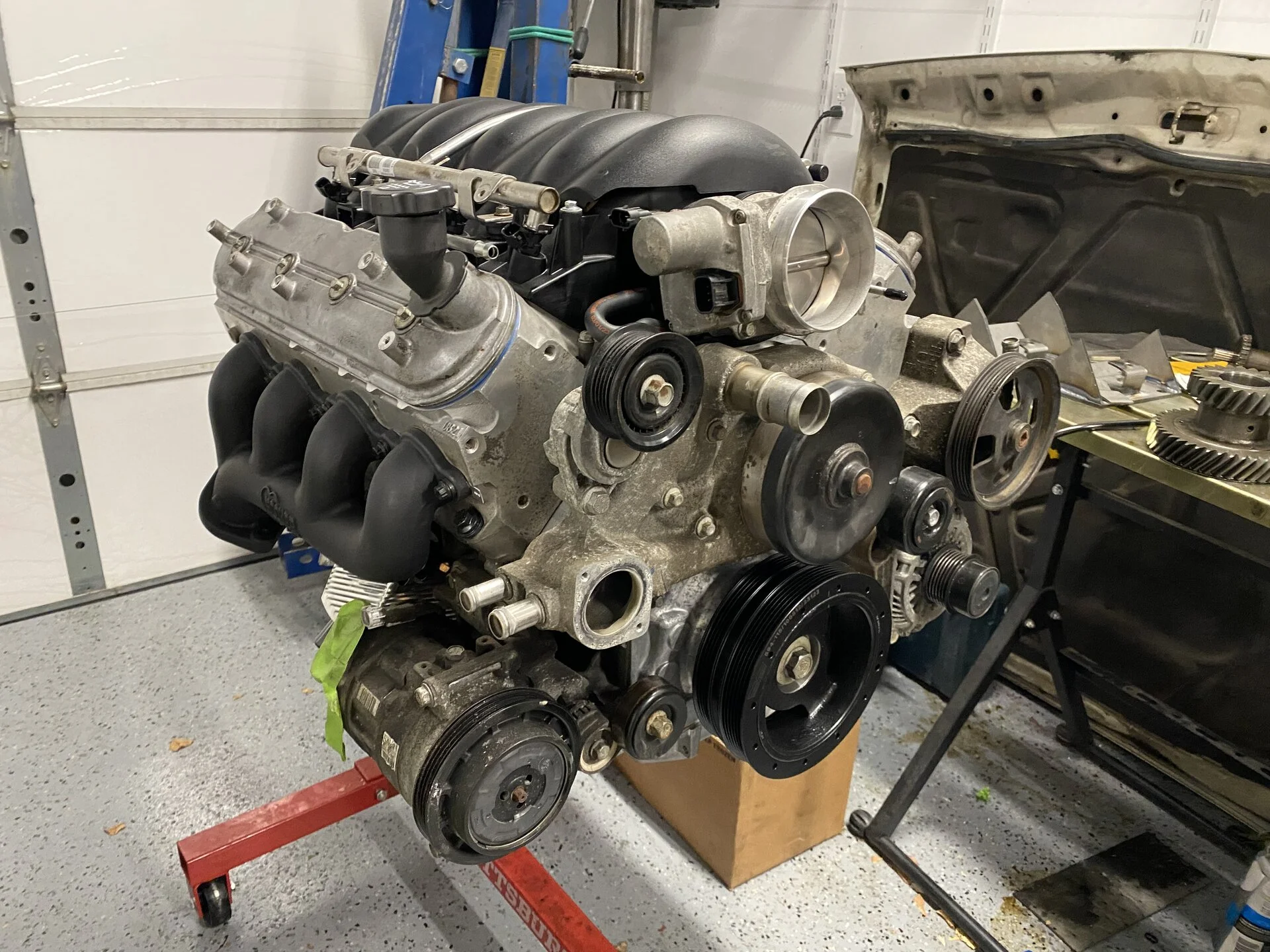

Finished dressing the engine except for plug wires, coils, etc. going to refinish some brackets
What are the chances this fits in the engine bay with the car accessory layout? a few ICT Billet brackets may be in order for the AC and alternator.
EDIT: with Matt's mounts, it actually looks like it fits as-is. Gonna be tight

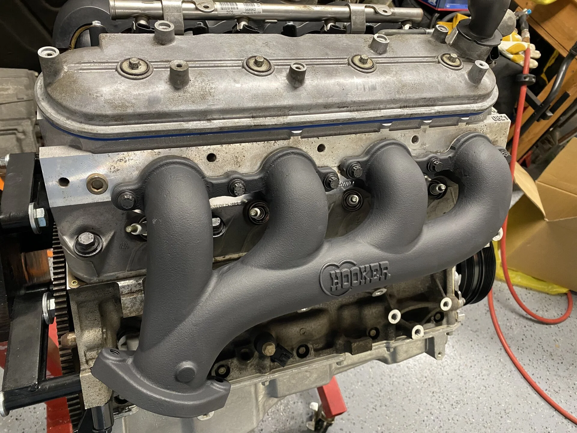

Love me some Hookers and those Hookers you have. . .sexy AF!

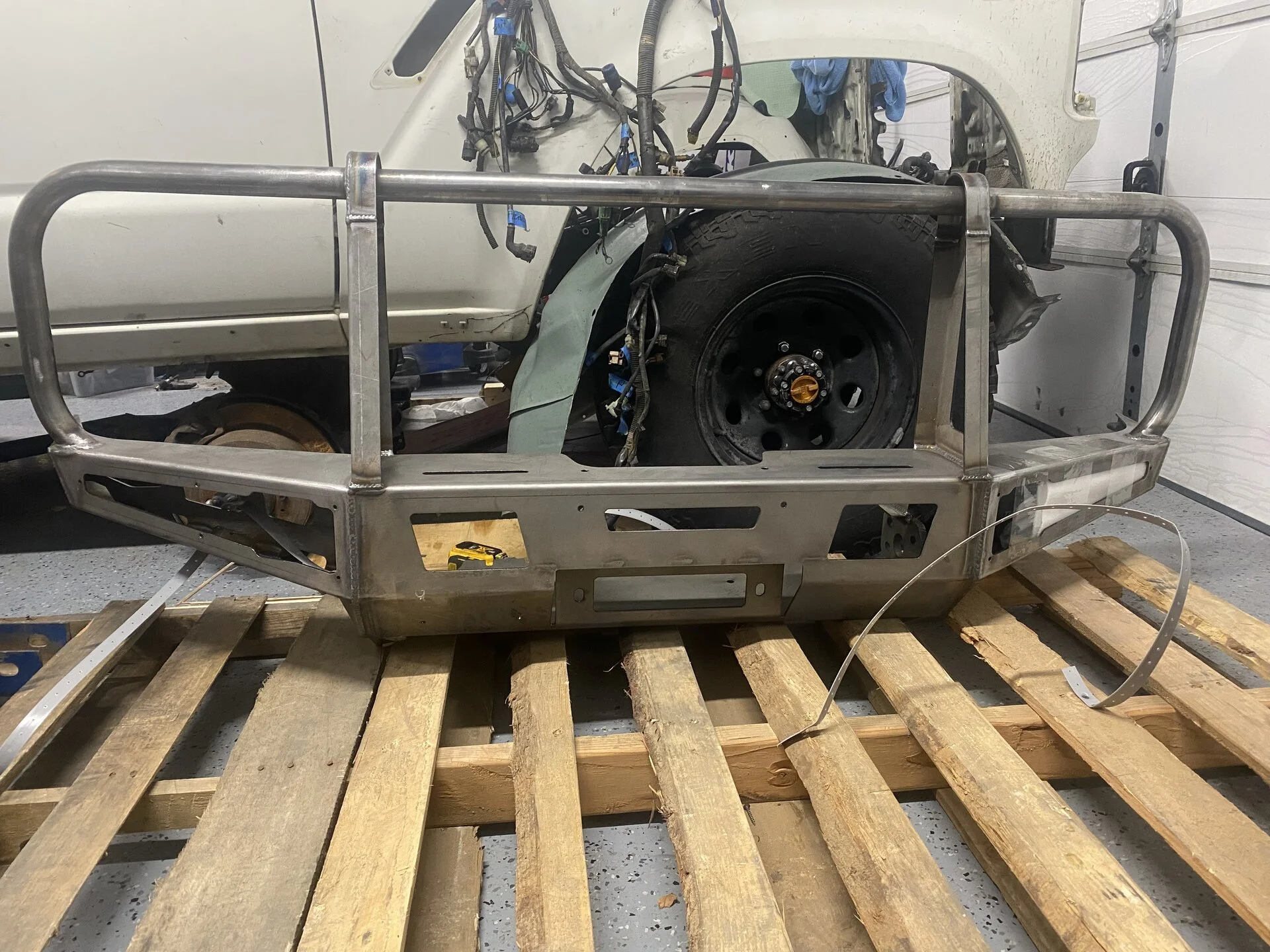

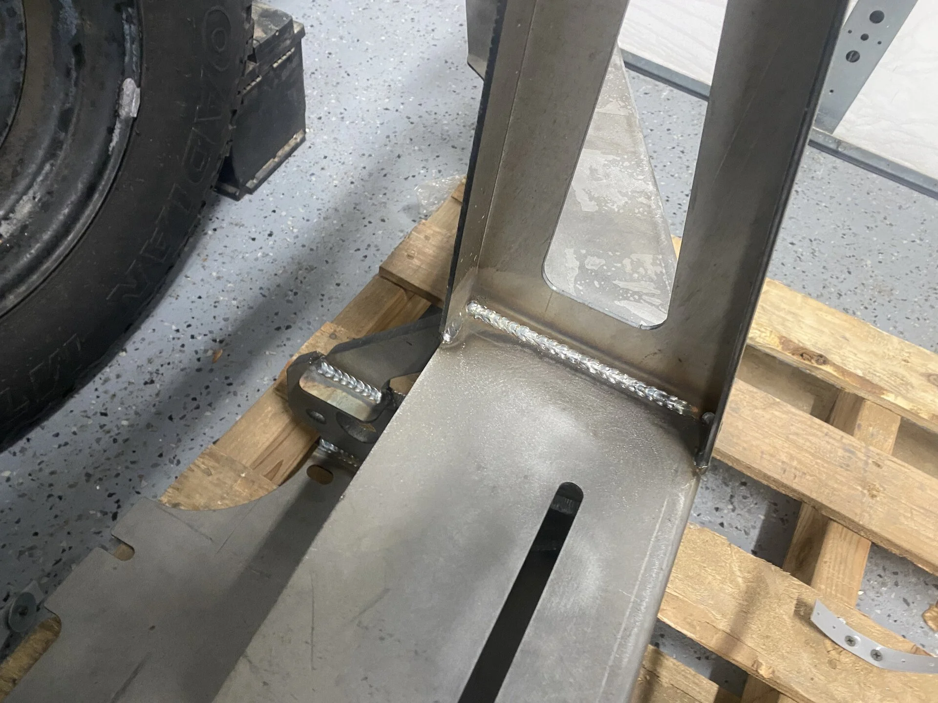

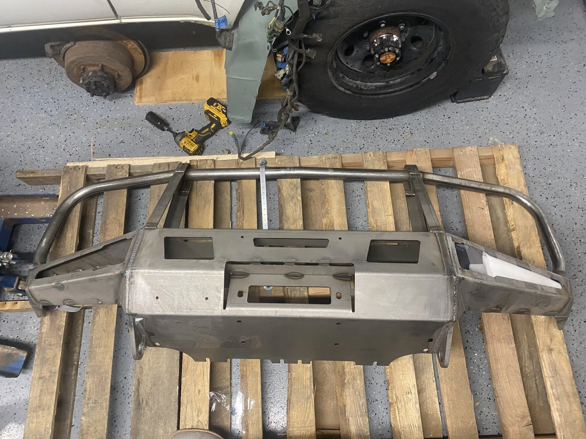

Dissent Offroad bumper has arrived! Welds look awesome. going to be a while before this gets mounted to ill throw some primer on it to keep the flash rust off

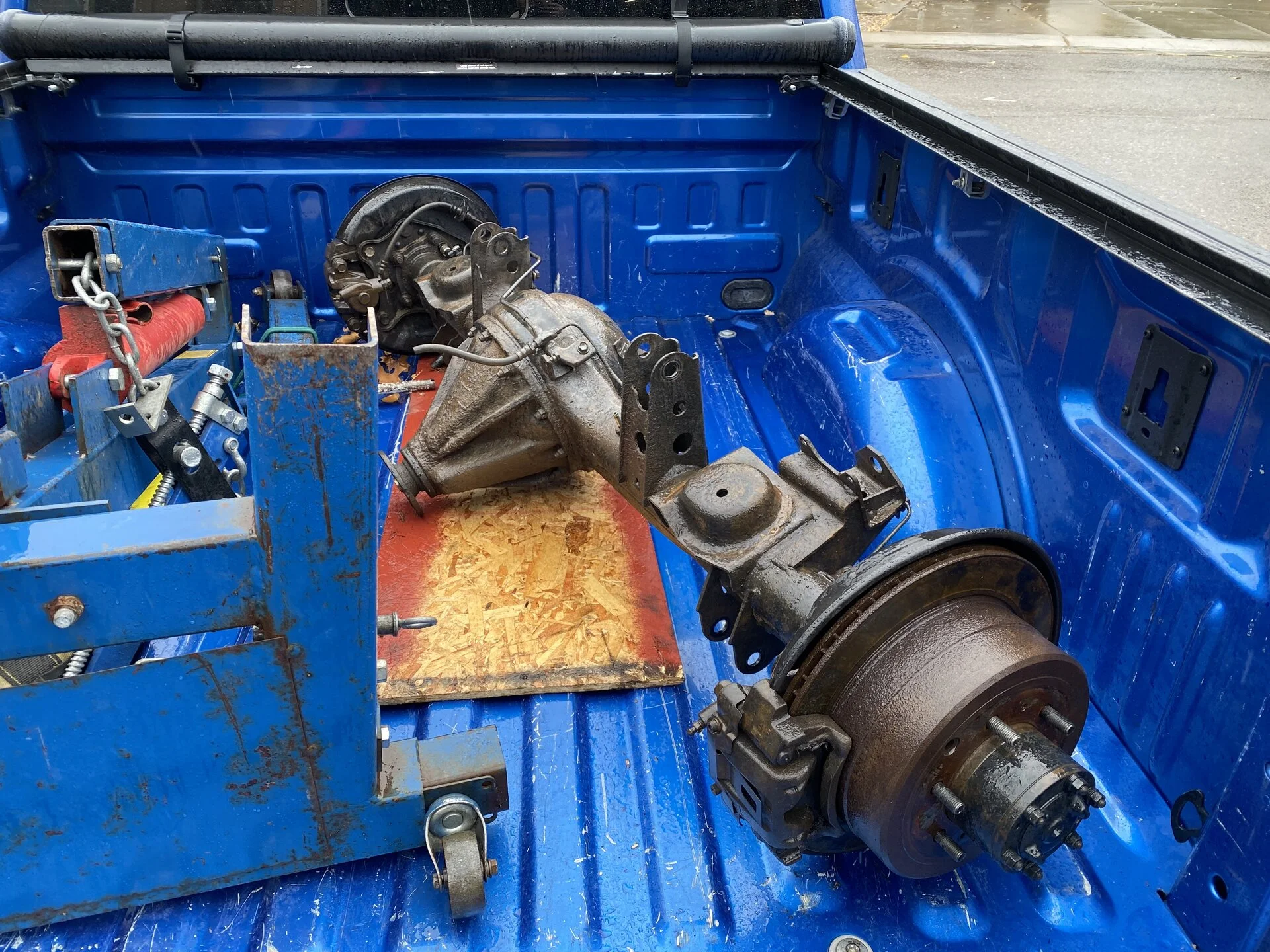

Also picked up rebuild kits for the 80 rear and 60 front. These will also be set aside for the engine project to finish and to find Tundra brake swap parts. @cruiseroutfit
