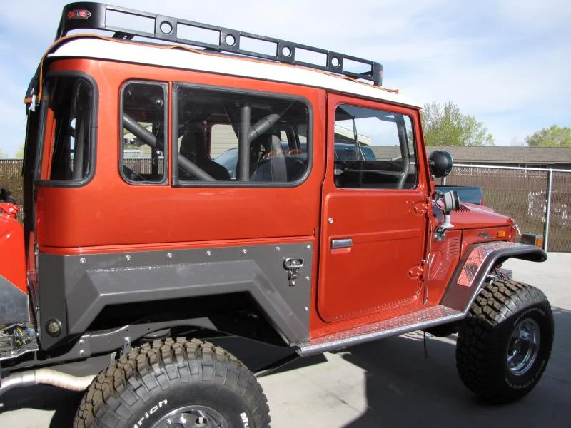

got the cap glass in, not very easy doin solo, but got them in along with the oem channel run.

Amazing build, thanks for sharing. What are the small lights above the kick vents?
they're swivel recovery lights, and will rotate 360 degrees vert, horiz, and 45....they come with spots, but i usually change to floods. I've used them on every cruiser i've owned and always place them in the same spot. Kinda nice to use when changing a flat, or any breakdown. Little pricy but very cheap when you need them.

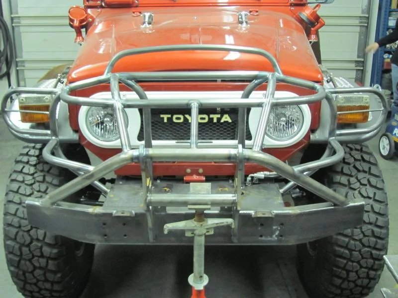

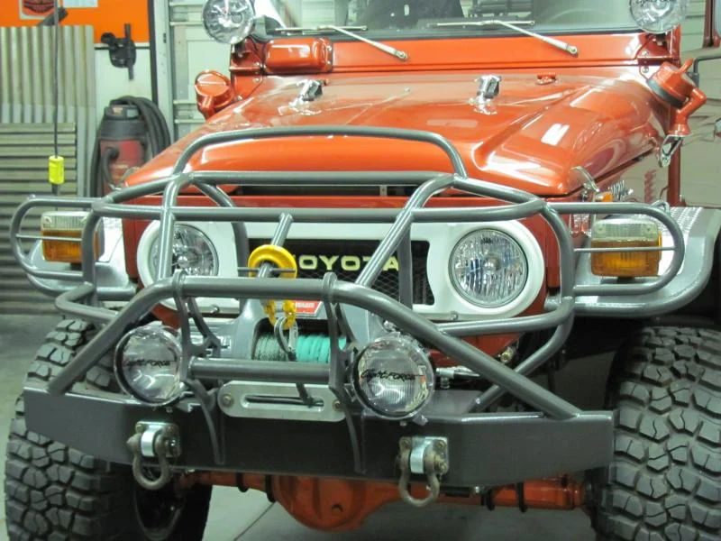

well....its been a spell since i've touched this, but now the snow has hit and will give me an opportunity to complete. Bent up the rest of the tubing for the front bumper, here is how it sits now

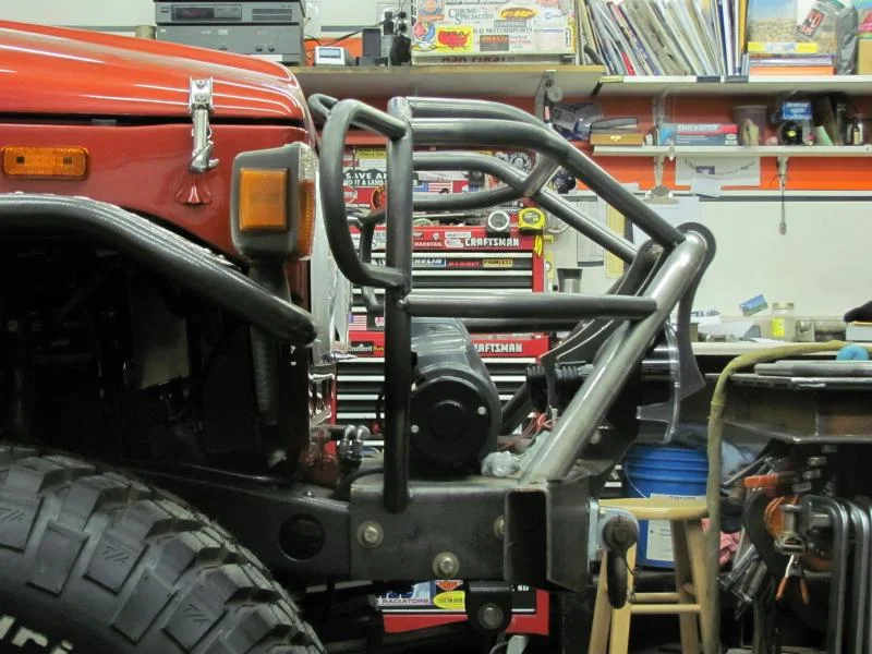

here is a side pic, finally by tommorrow, it will be ready to powdercoat.

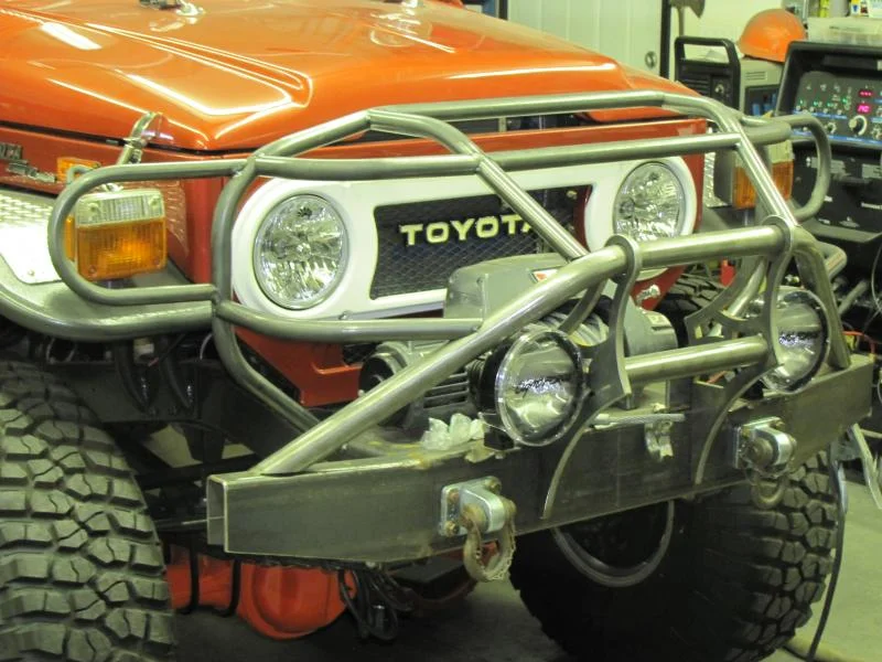

welded a few more pieces, wasnt sure about the top hoop but i rolled it to follow the top curve of the hood

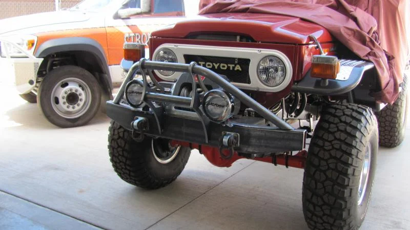

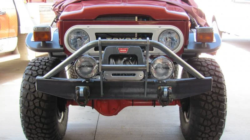

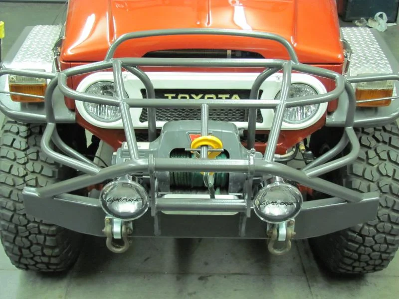

got my bumper and some misc parts back from the powdercoater today, nice late night settin up the front end with lights and winch. Thanks to my best friend Bill, for the kick ass US Army Vietnam era recovery shackles.......oh, anyone thinking of upgrading their lighting system, Round Eyes Bulbs and Hellas battery wiring kit is a must have. Extremely bright and clear and for driving lights, the Liteforce line of light are excellent quality and are very very bright
