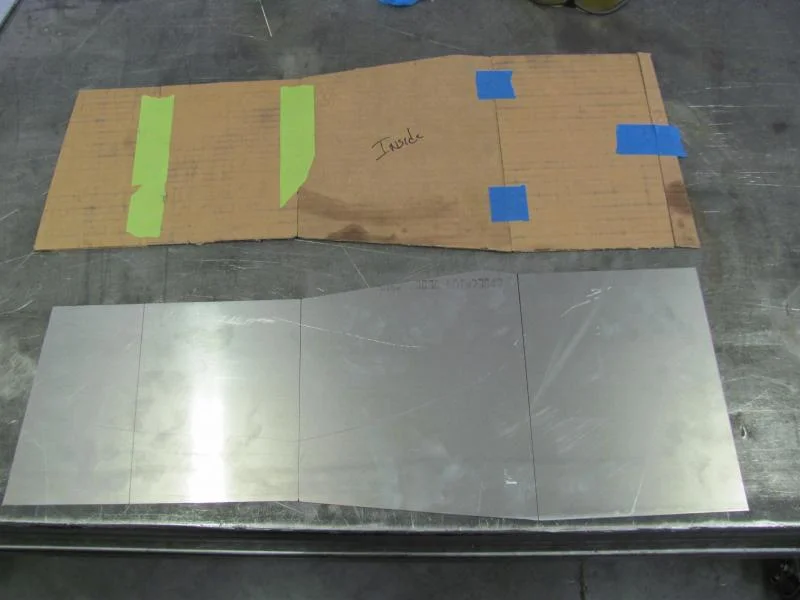

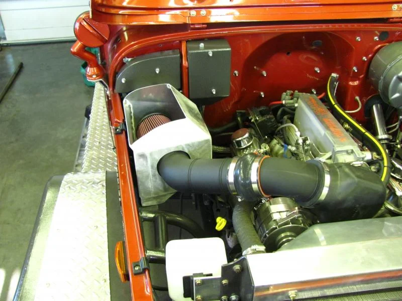

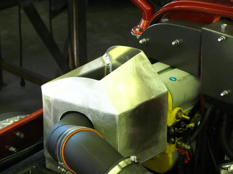

forgot i had to fab up an air box.here is the sure fire way to cut once, mock up of cardboard then bend, ran out of time today to finish. The plan is to get fresh air from the louvers on passenger side of hood. If this doesnt work or has a flaw, i'll cut it up and go to plan B

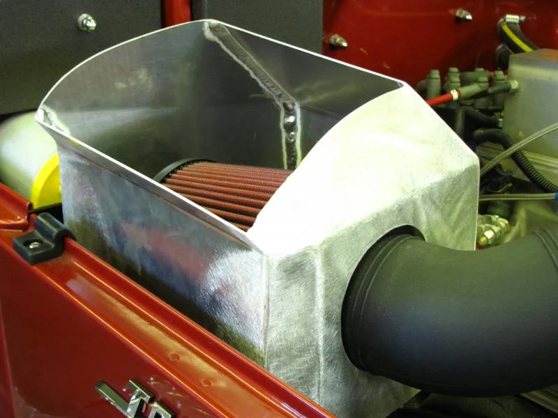

welded it up, sanded it down, just need to source some fat air box gasket s***......tommorrow

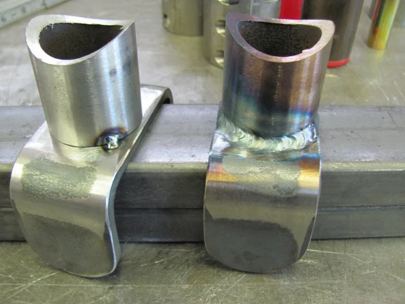

shock towers
i figured that since the shocks are bolted directly to the fender tubing, some sort of support would be needed to keep the fenders tied in tight and minimize hwy vibration. This is what i came up with.

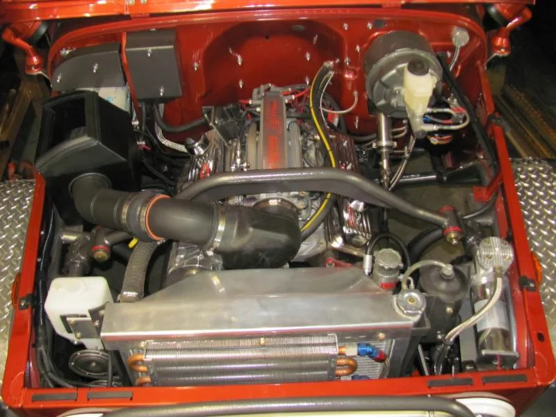

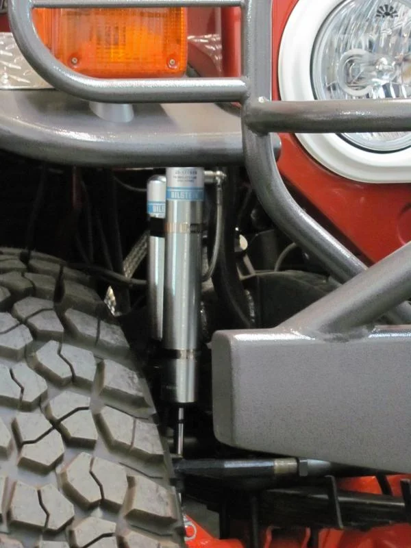

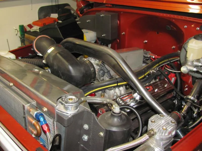

Finally put the shocks on........got the shock tower brace back and in........Ordered a Howell MEFI 3 to TPI harness and computer, should've done this a long time ago in the build, this will gain me some mpg, cut down the super rich conditions and smooth out the idle. 10 more days. In the mean time, registration and insurance time!!!!!!!!! very amped to wheel this thing. Only thing that sux, is the passes wont open until june-ish......Moab is only right around the corner and its been pretty mild for snow in the valley so im sure we can find a few places to work out any bugs......Thanks to all who chimed in along this build,

Awesome!
You'll have to let us know how the air box works out.
Awesome!
X2. Of all the stuff that you have done to this rig, this is the one which makes me slap my forehead and wonder why I didn't think of it.
Is Jeremiah going to sell that box as a product? Fantastic!
Josh
Josh
.....The only thing Proffitts did was the suspension. If i had the correct geometry, i would've done that too......If you would like an airbox like that , it can happen, pm me.Thank you.

my weight is 5320lbs, so the springs were way too soft, bumped it up to 80 series, still too soft, then got different springs, loaded it on trailer and the p/s took a dump so i cannot anwser this as of today. Should have pump back by saturday. I will let you know.....as for the Rhino lining, i think it was around $350 inside and underneath.
