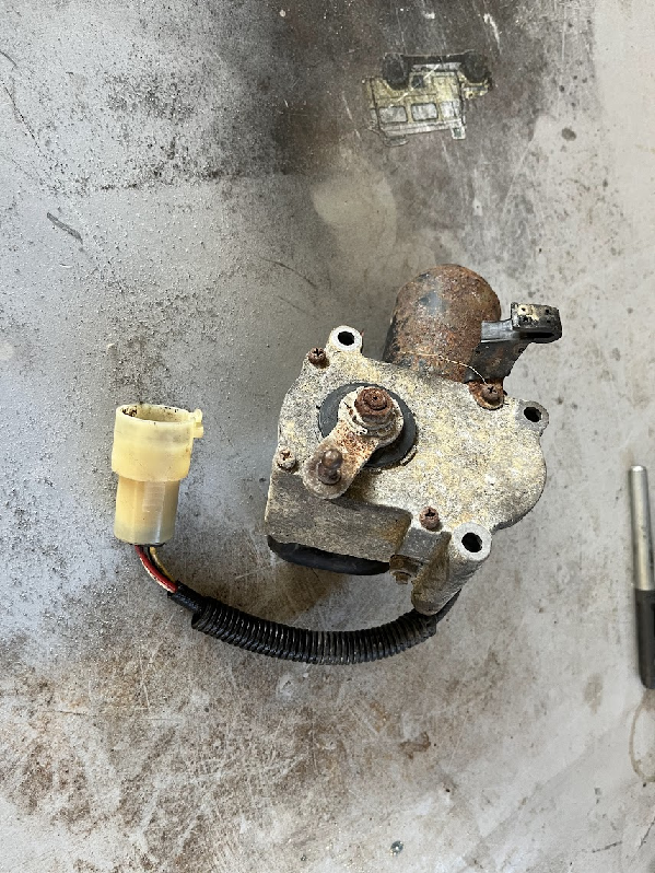

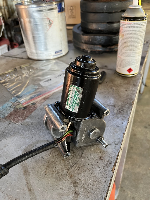

EDIC motor tested, cleaned and ready to go back on..
you are not going straight for the bowden cable/ edic delete?
I run a Stop Cable on my HJ47... but if the Fuel Control Relay and this motor work "out of the box".. I'll run it until it doesnt work anymore :)

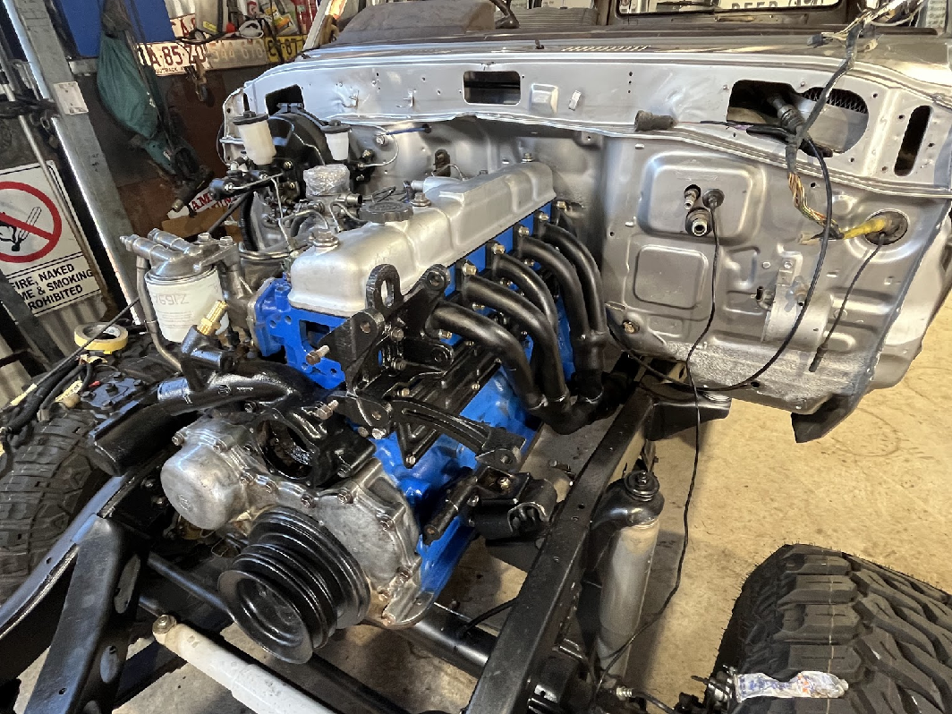

Extractors and various other brackets etc back on after work today. Nice new studs, new washers and new brass nuts for the extractors. Tomorrow after work I hope to do the lower and upper thermostat housing, the bypass hose and then the water pump. I am getting close to being able to do another quick test run before the guards go on so the radiator support can be put in place.
Are those headers from a kit or did you fabricate them?
Lookin' good!
quick question, is naked smoking a thing in oz? kept see a sign prohibiting in your pics :flipoff2:
nice work man
Hahah.. I had to go and find that sign in the photograph.
Naked smoking is indeed the national past-time, one most carefully choose that you dont smoke in a no naked smoking area. There arent many of those areas, but they do exist.
