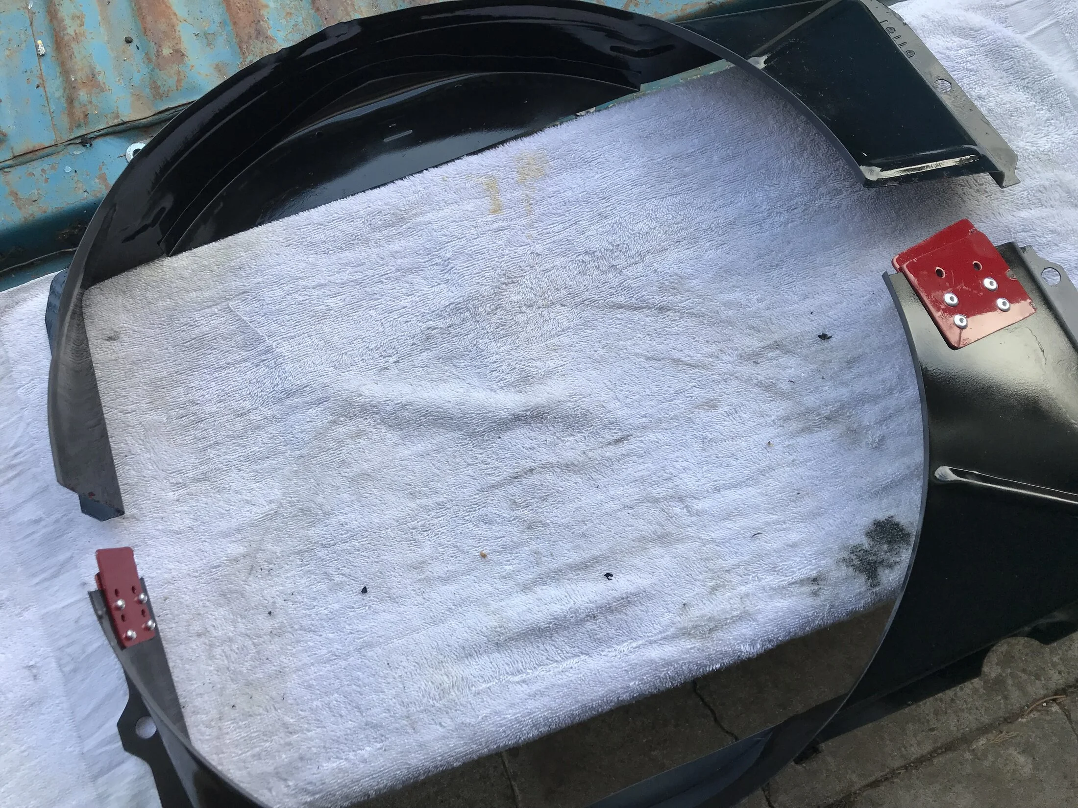

THANK YOU!!! I'm doing a cooling system refresh and have seen some of these threads, and I'm always thinking "Why do you need any kind of bracket? Just cut it and bolt that damn thing back in!"

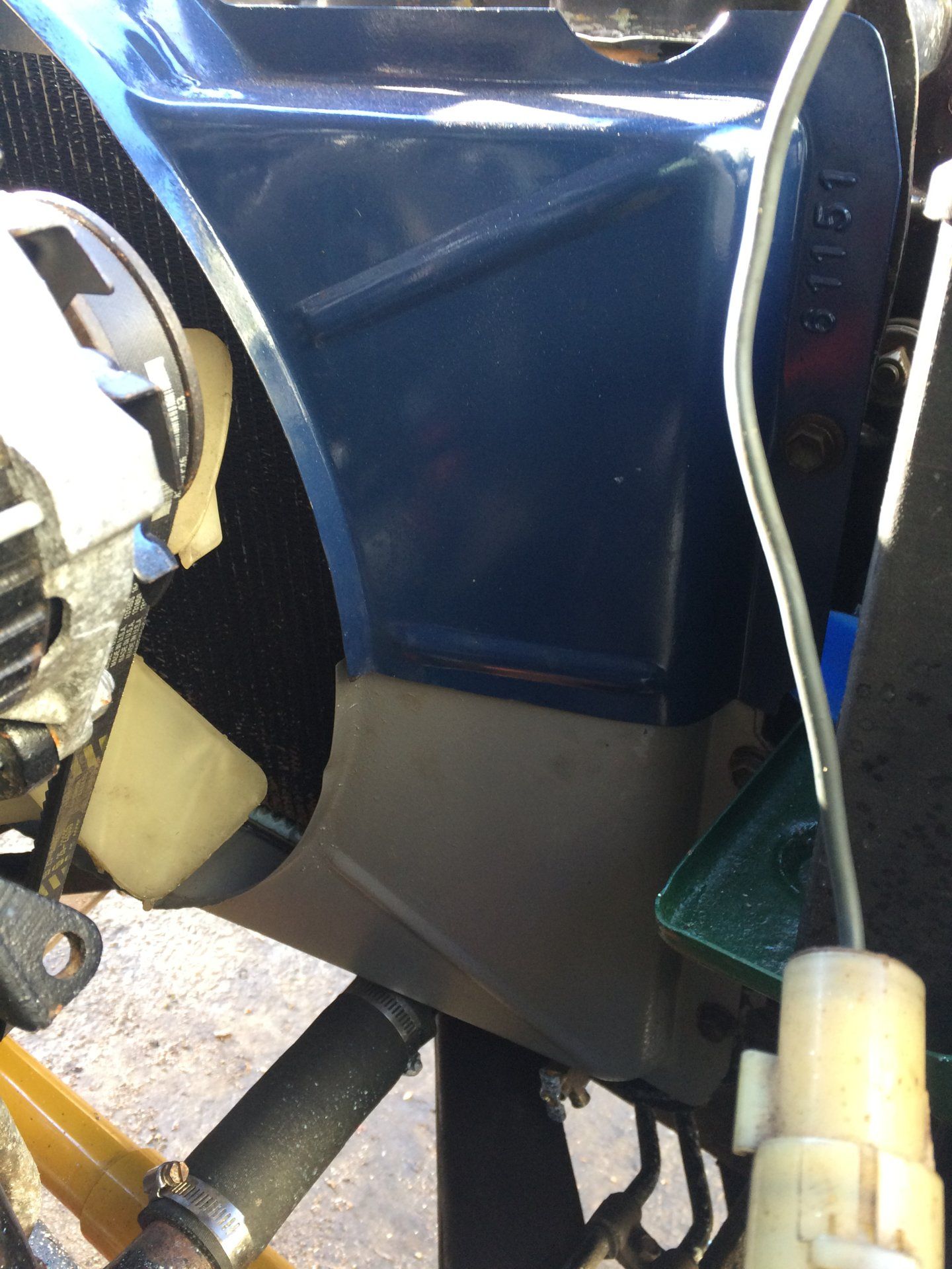

Yeah a whole lot of extra work imo. I did nine two different colors just to make the mod stand out. ;)
Why? Sometimes 'just because we can'...
I've done so many things a certain way that wasn't necessary, but it's fun to fabricate and use your skills, I get his point.
Wouldn't have used pop rivets though.... ;)

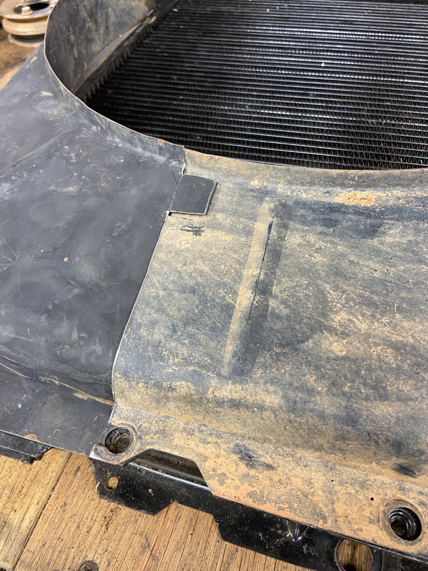

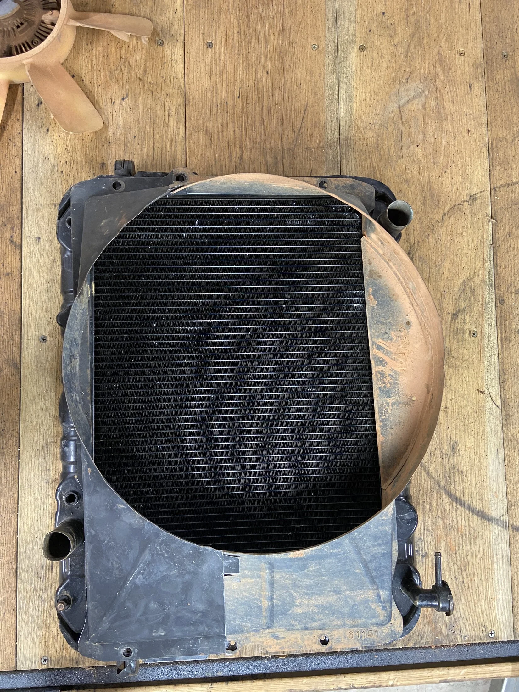

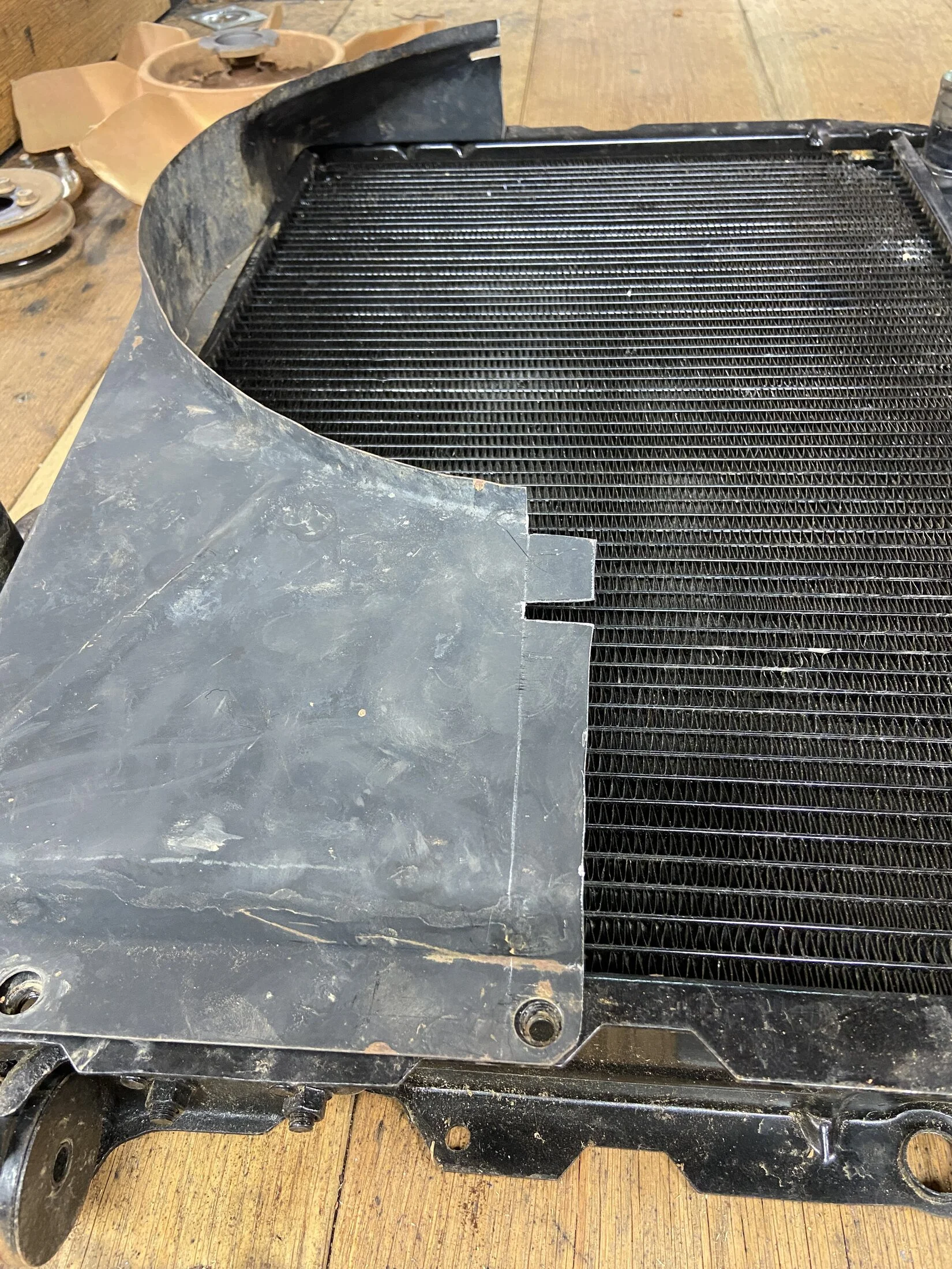

Just chop it in half and stick it back on. Nothing fancy necessary other than paint. @evilorgoodtwin hasnt been online in months. I did mine tho and didn’t add any fancy brackets like some have. It goes on and off just fine. No rattles w/o a special bracket.
Is there an optimal “cut line” to clear hoses and such? Or is right down the middle good enough?
Pretty sure I did mine right across the middle. It’s a horizontal cut (not vertical)… you’ll have no issues clearing hoses. I can shoot you a photo tomorrow if you need. Heading to bed now.
