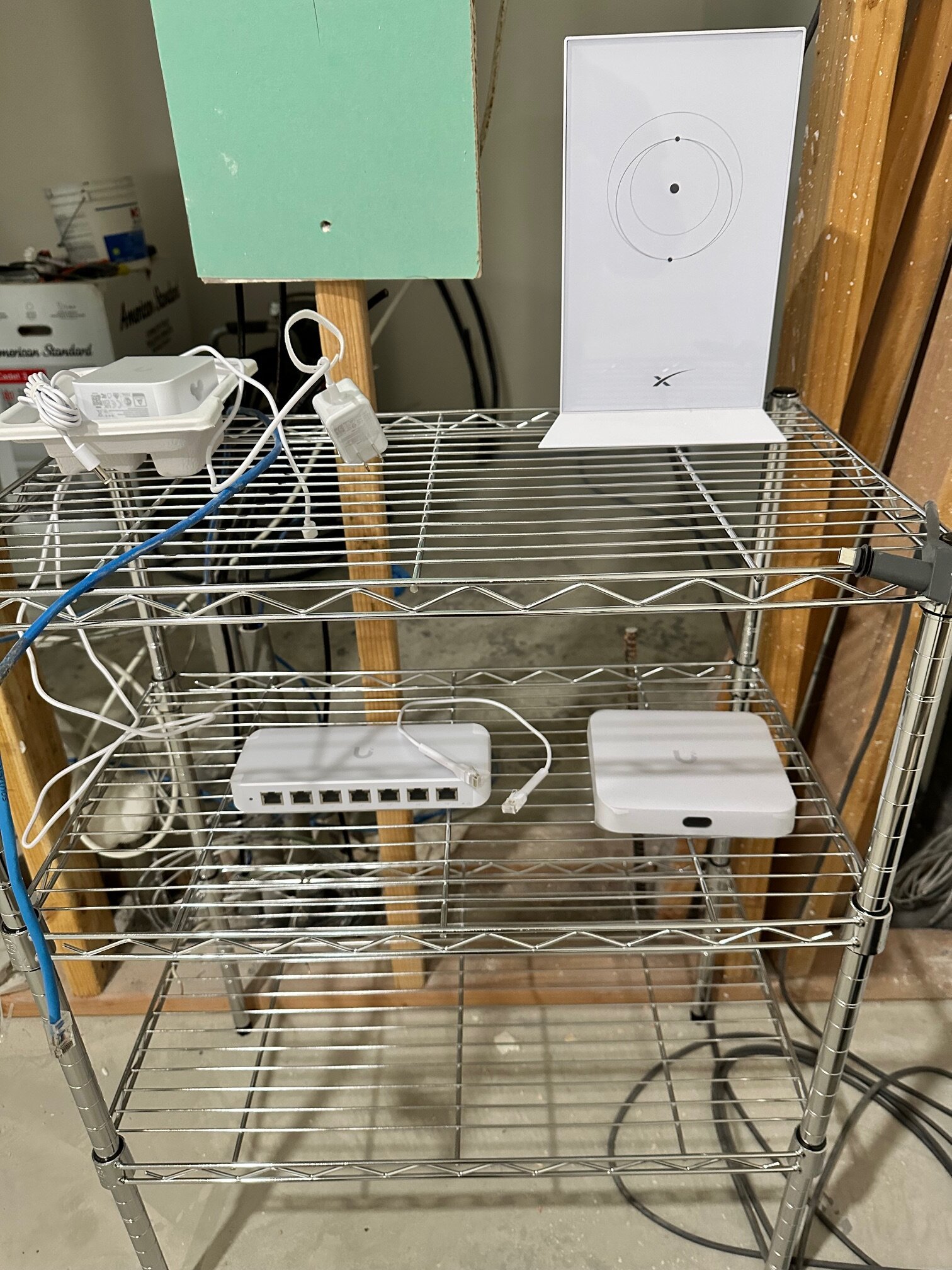

All of my network stuff for the house was delivered, so I'm in the process of installing that now; a gateway/router, PoE switch, and hardwired (ethernet) WiFi access points.

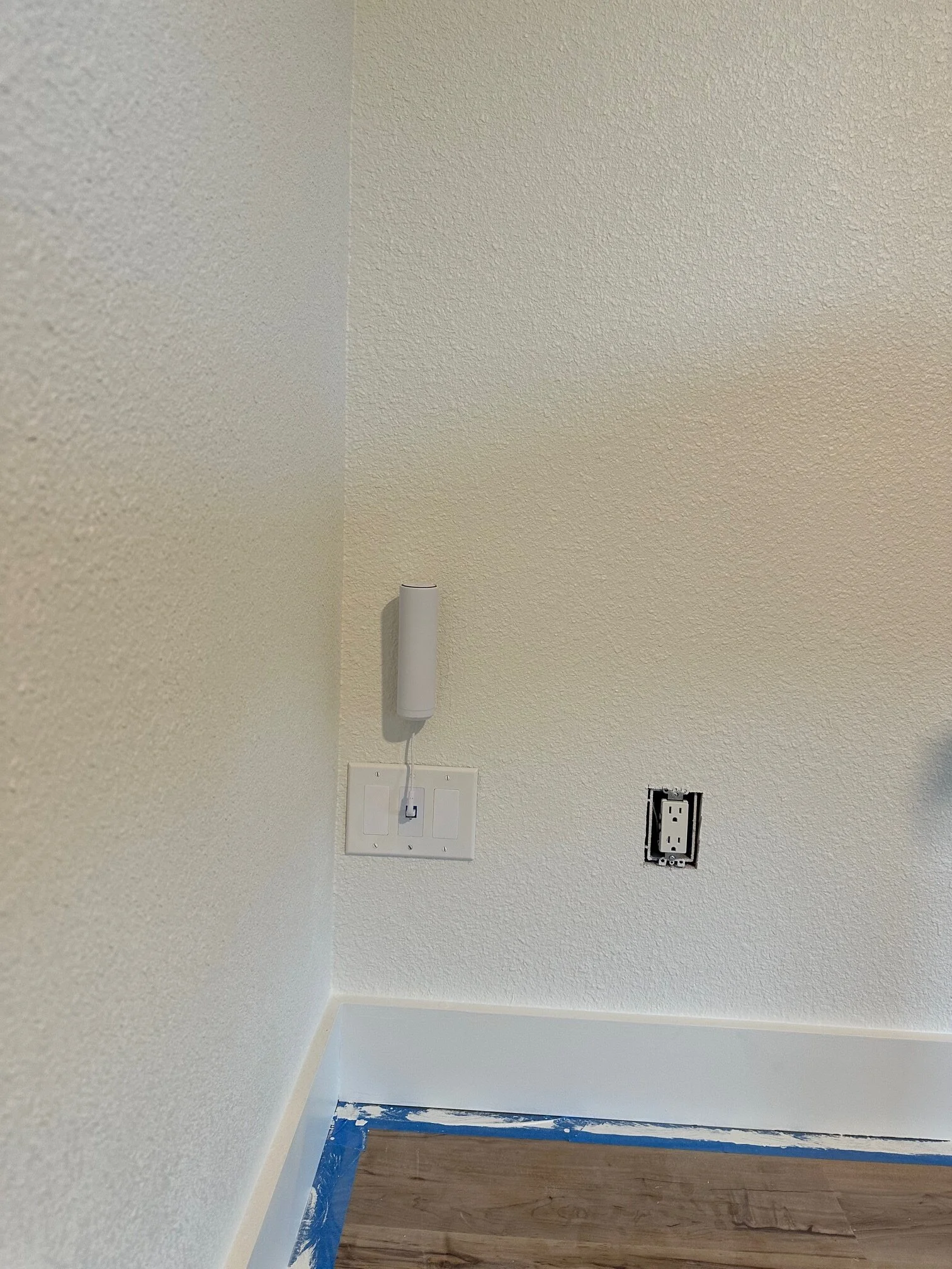

One of the access points:
