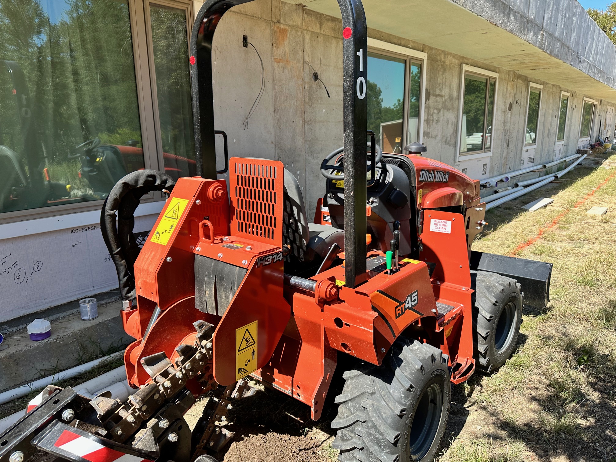

Having previously rented walk-behind trenchers and learned how hard it can be to keep them straight, I splurged and rented a big ride-on trencher that digs a true 6" trench 4' deep.
It was well worth the extra $150. Dug 250' of trenches almost perfectly straight, in about 2.5 hours, and that included down time for finding the power and water lines for the chicken coop that cross the sewer line path. I also had two helpers, making it much easier to handle the 20' lengths of 4" schedule 40 and get tees glued in straight. One of the helpers also has a laser transit that makes measuring the grade a snap.

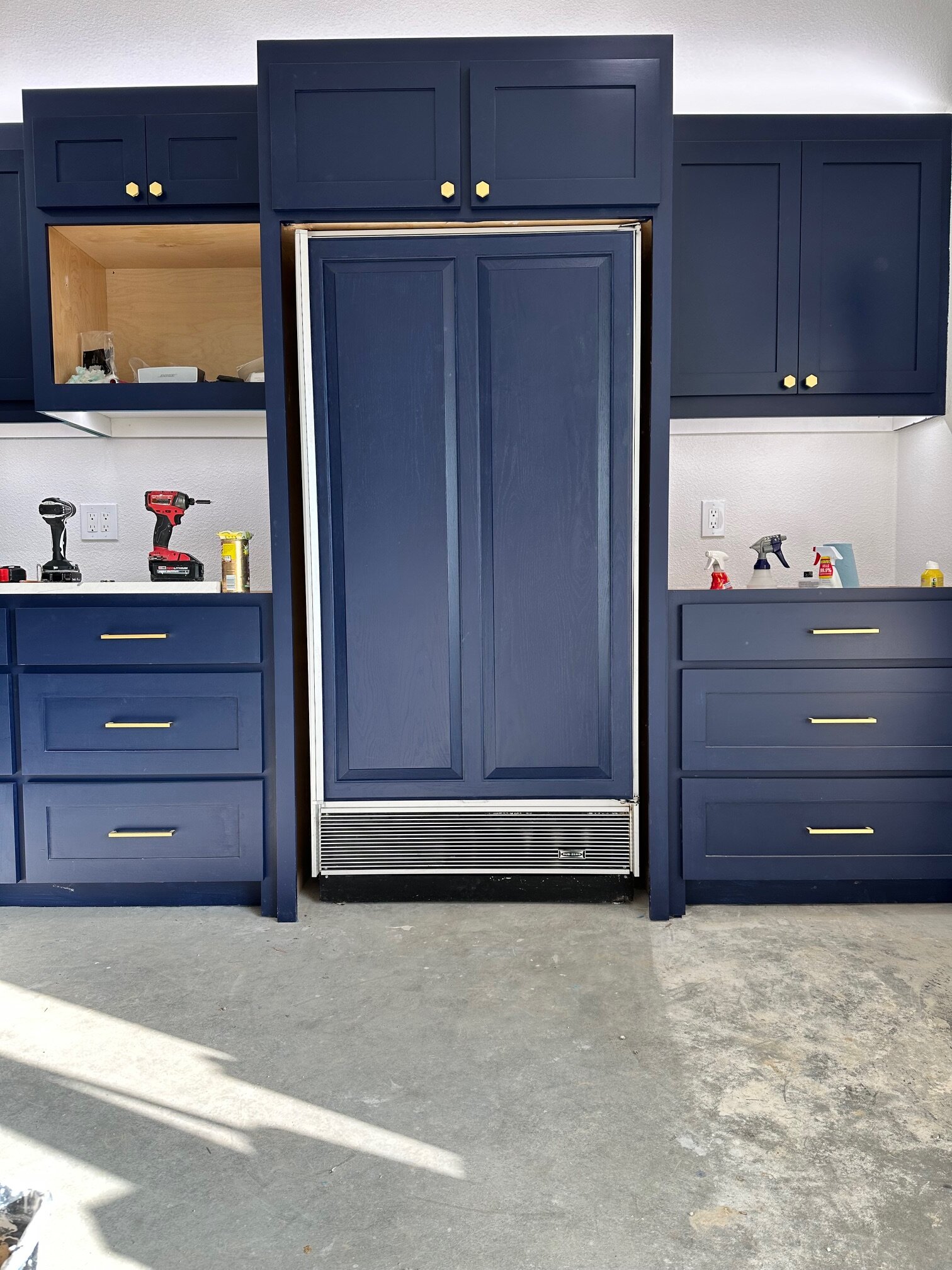

Sub-Zero fridge installed and running. I'll have to take it back out when we put the flooring on. I guess I will paint the inside of the enclosure the same dark navy blue when it's out.

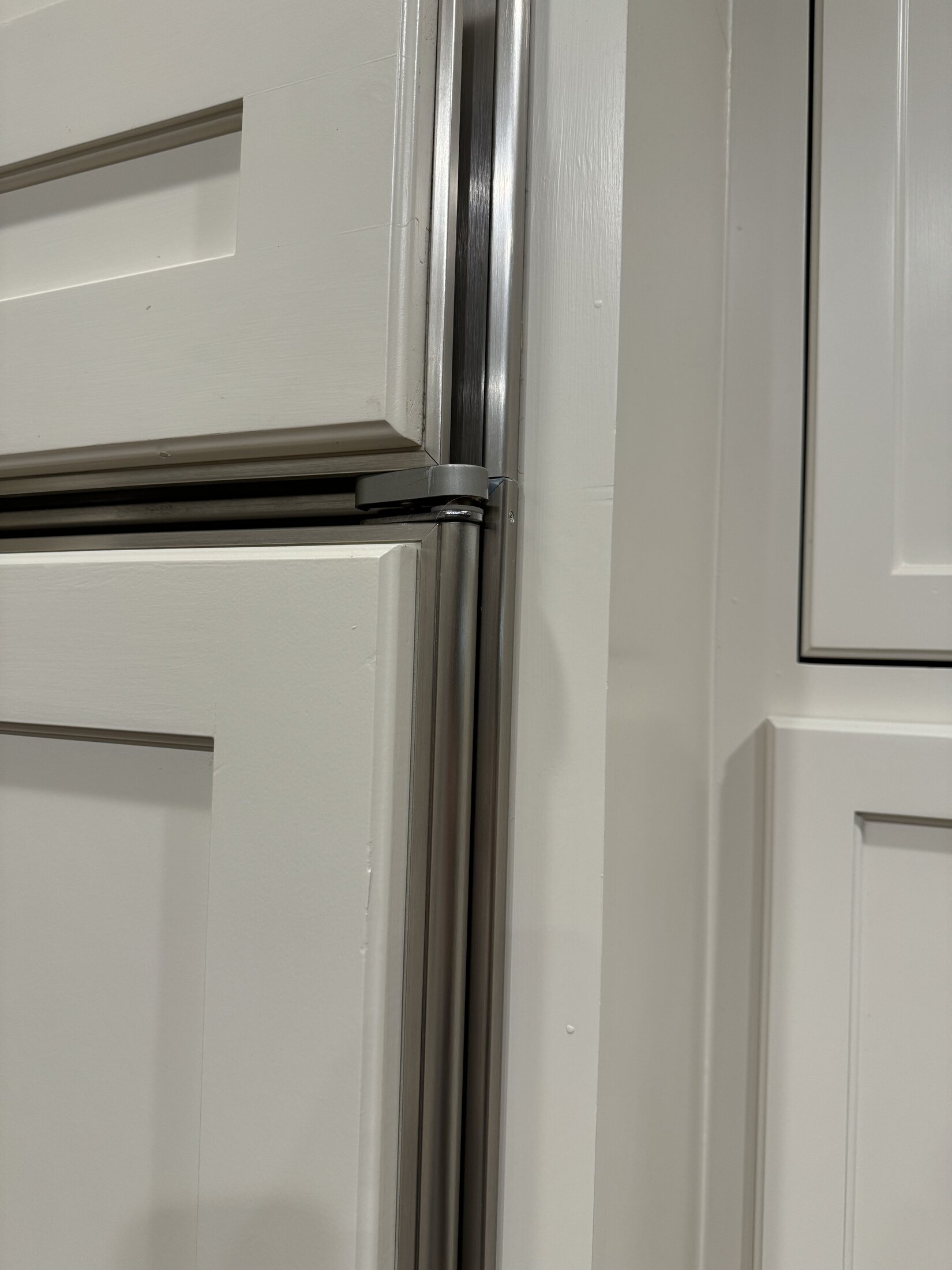

Nice color. I know you don't want to hear this but normally those units fit flush on the top and sides with a small stainless edge piece overlapping the cabinet frame. Or at least the 4' combined units do. I've never had the 3' individual units before.
Yeah, I know they are supposed to. The problem is, the mrs. did not know what fridge she was going to end up with when the cabinets were built, so they just did a generic opening size. That thing is a couple of inches taller than any standard fridge size, so we already enlarge the top of the opening for it to fit. Some day, I may trim it out properly, but for now the mrs. is happy with it as-is. We've been working on the house for so long now that she just wants to move in, and has given up on perfection.

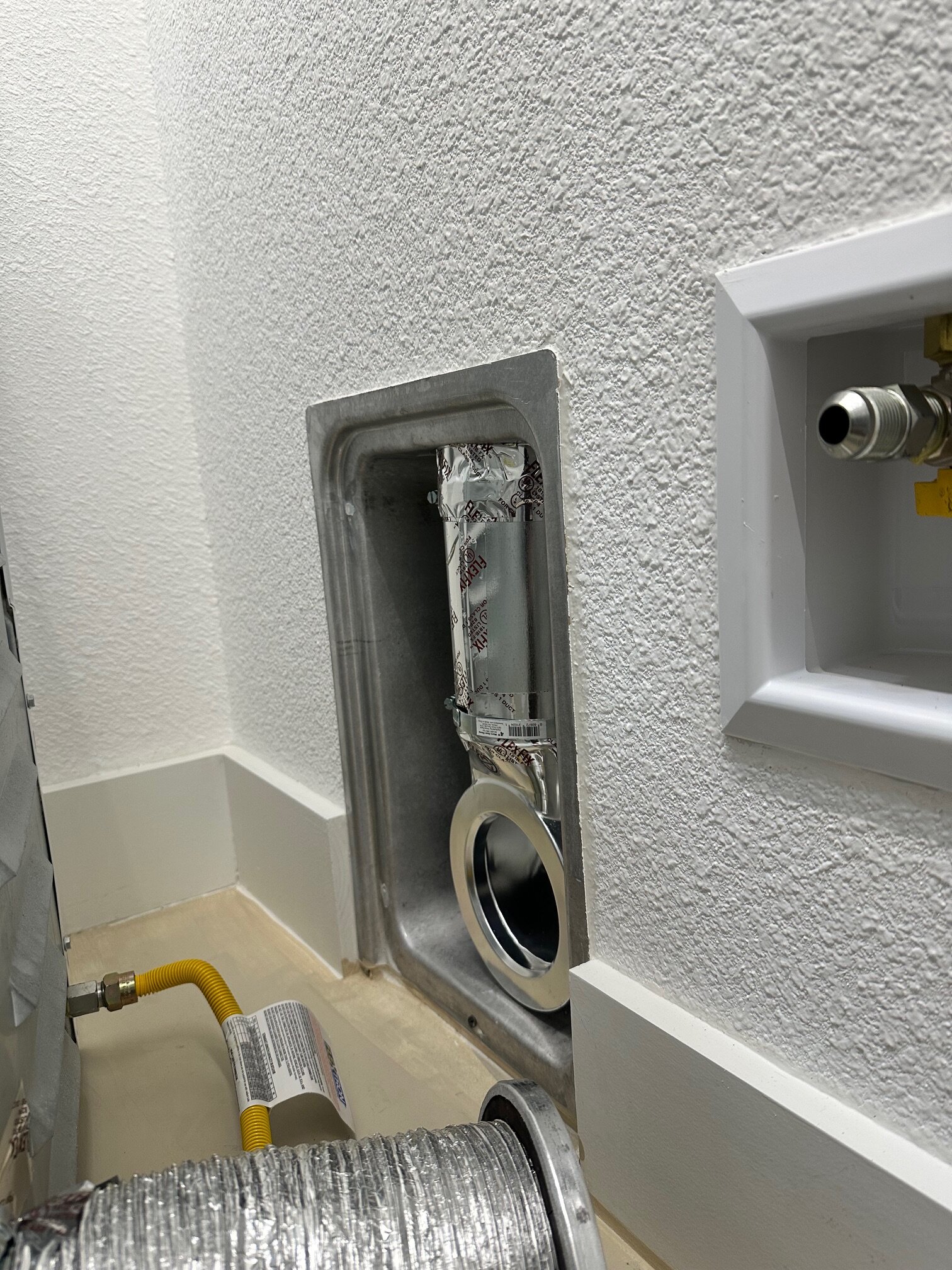

I tried a new (but expensive) way to hook up the dryer vent, the MagVent. It's a clever way to connect the vent with a strong circular magnet. Seems to have worked well, but they're $100 each. Supposed to make it way easier to disconnect and reconnect when cleaning lint out of the vent.

Really love the recessed dryer vent. Nice work man.
@scrapdaddy Those who take the time and energy to clean those vents fully understand your thinking…I just now thought about adding a recessed vent but it’s been 45+ years here doing that damn clamp
