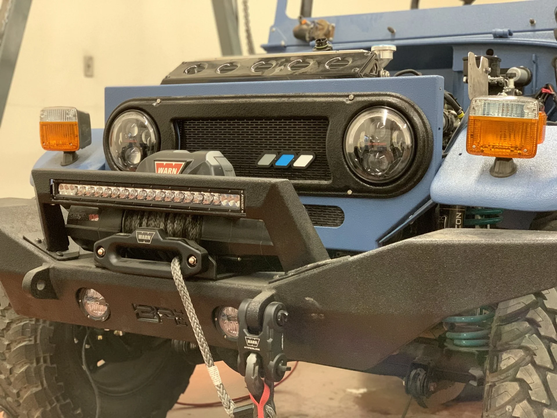

Been a while since I posted but slowly trying to get all the wiring done. Got the front end finished and put back together. Made a custom grill and I think it fits with the over all look. Really like the JW speaker lights. Thinking of painting the front signal light casing black instead of the plastic grey to flow with the rest of the black accents.
