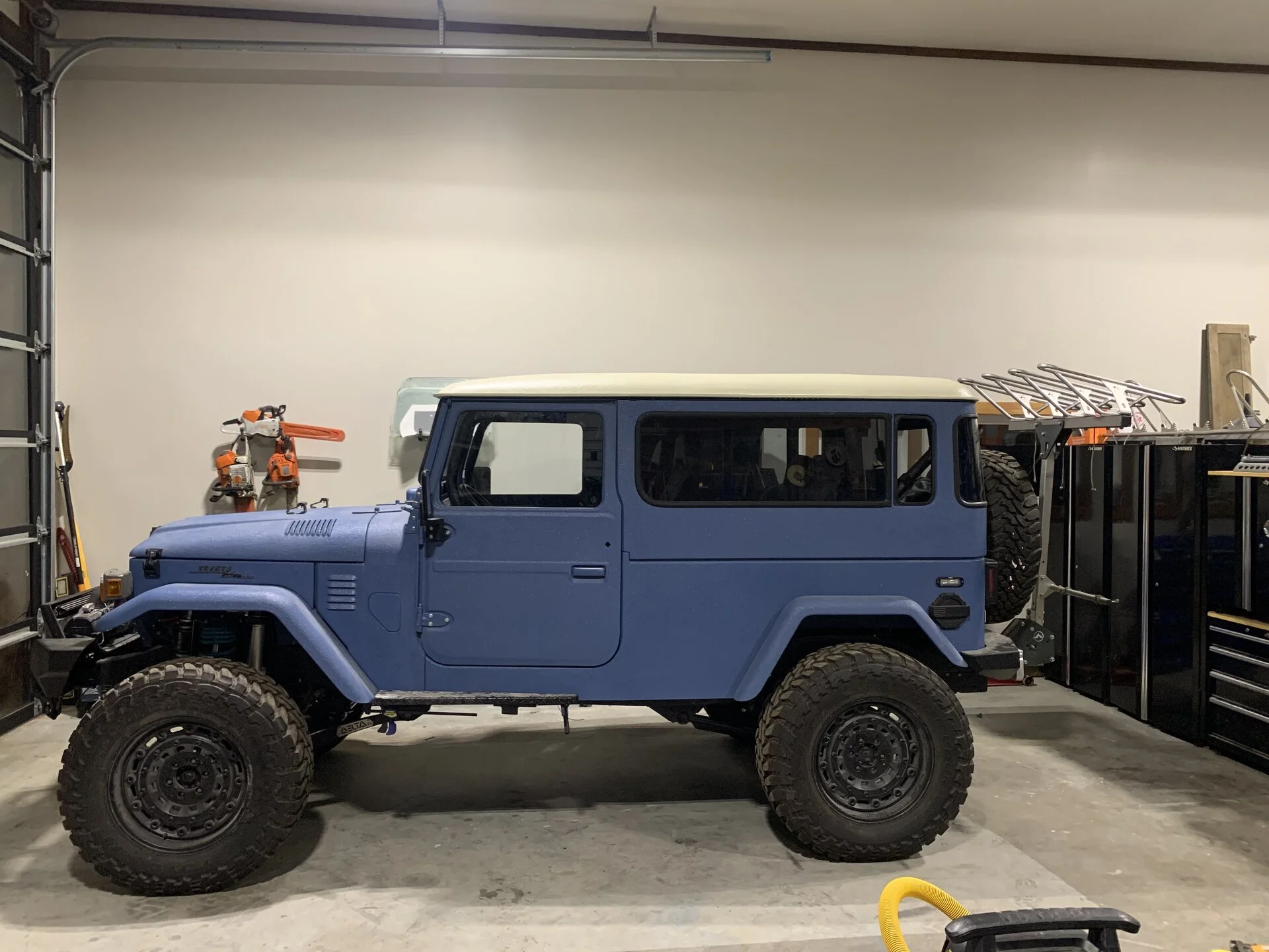

Have not had much time to work on over the summer but got the windows in and a few electrical bugs worked out. Waiting on the new axels from dynatrac for my winter project then hope to finally have this thing running in the spring!

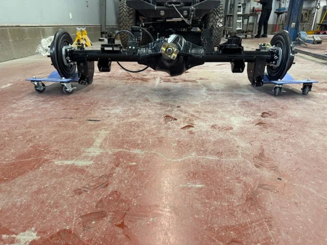

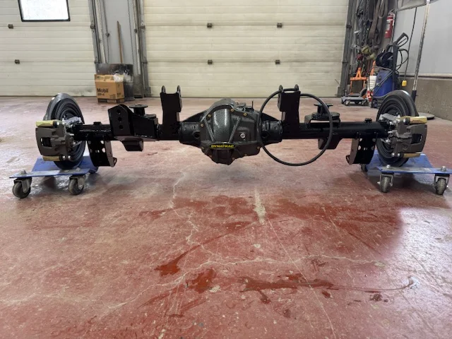

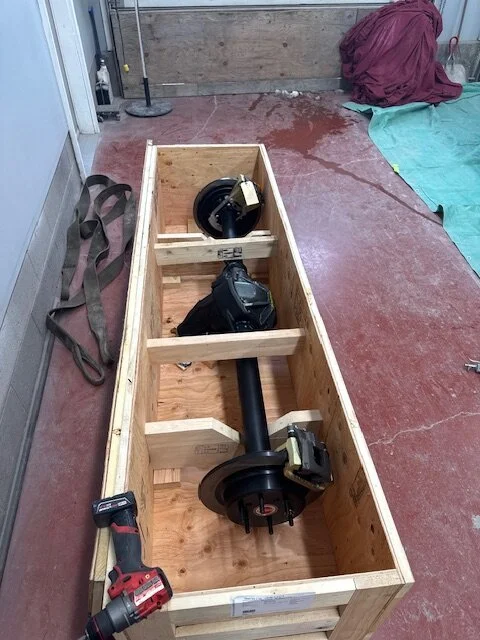

Finally got working on my rear axel. Ordered a Prorock 60 High Pinion axel from Dynatrac with blank tubes and axel brackets from Barnes 4x4. Had to do a few mods to the brackets but everything turned out great and was able to keep the geometry, linkage and suspension from the FJ80 with the new centered diff and everything fit perfectly. Transfer case was 5 degrees down so matched rear diff angle to 5 degrees up and now that everything is centred I should not have any issues with driveshaft angles. I did not weld any brackets on for the factory sway bar yet. Figured once I have the rig driving and If I notice to much body role I can always but on a Rock Jock if needed?
