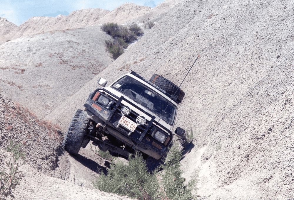

Here is us in the Badlands. Family of 5 tenting it across the US.

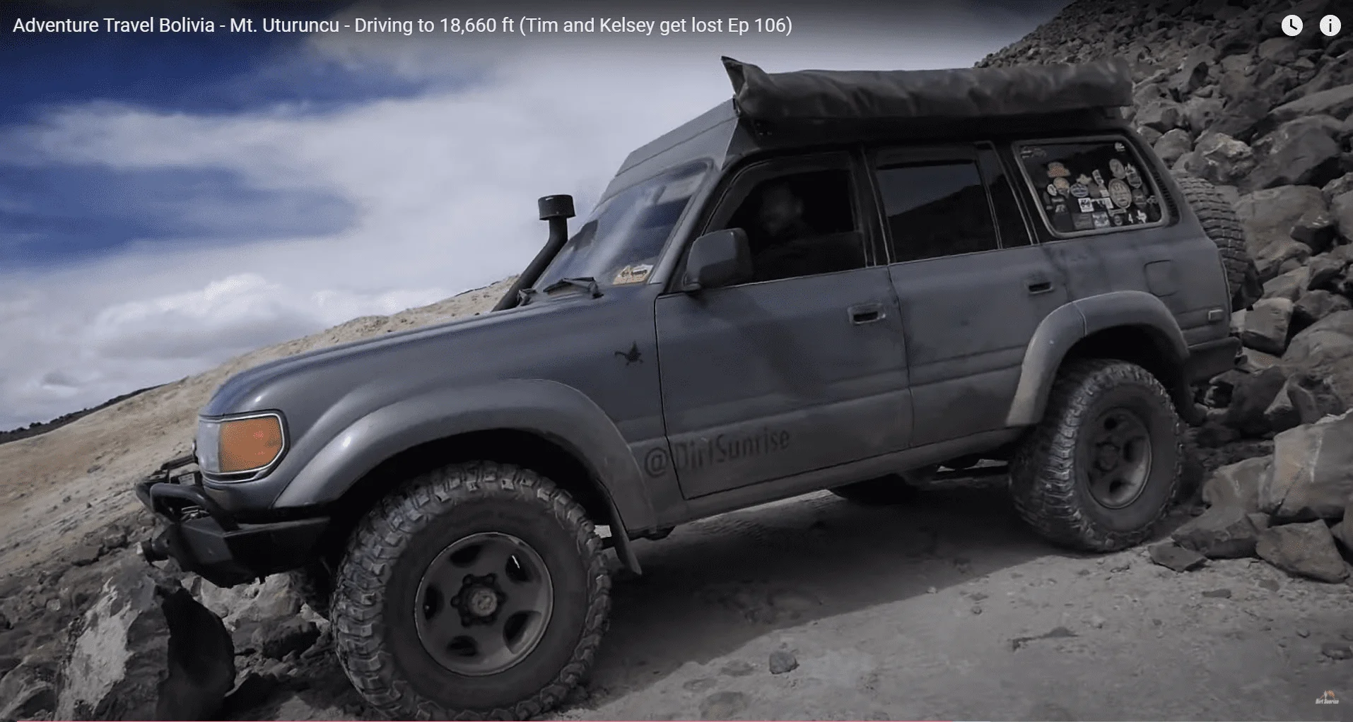

I agree, and same thought came to me when I was watching @SOAZtim video Mt. Uturuncu
Here they are doing a 1000 point turn at >18,600 ft above sea level.
I think a Tremor wouldn't able to go where they went. Tim and Kelsey video's are providing inspiration that an FJ80/LX450 can do it. I still have 100+ videos of theirs to watch.
