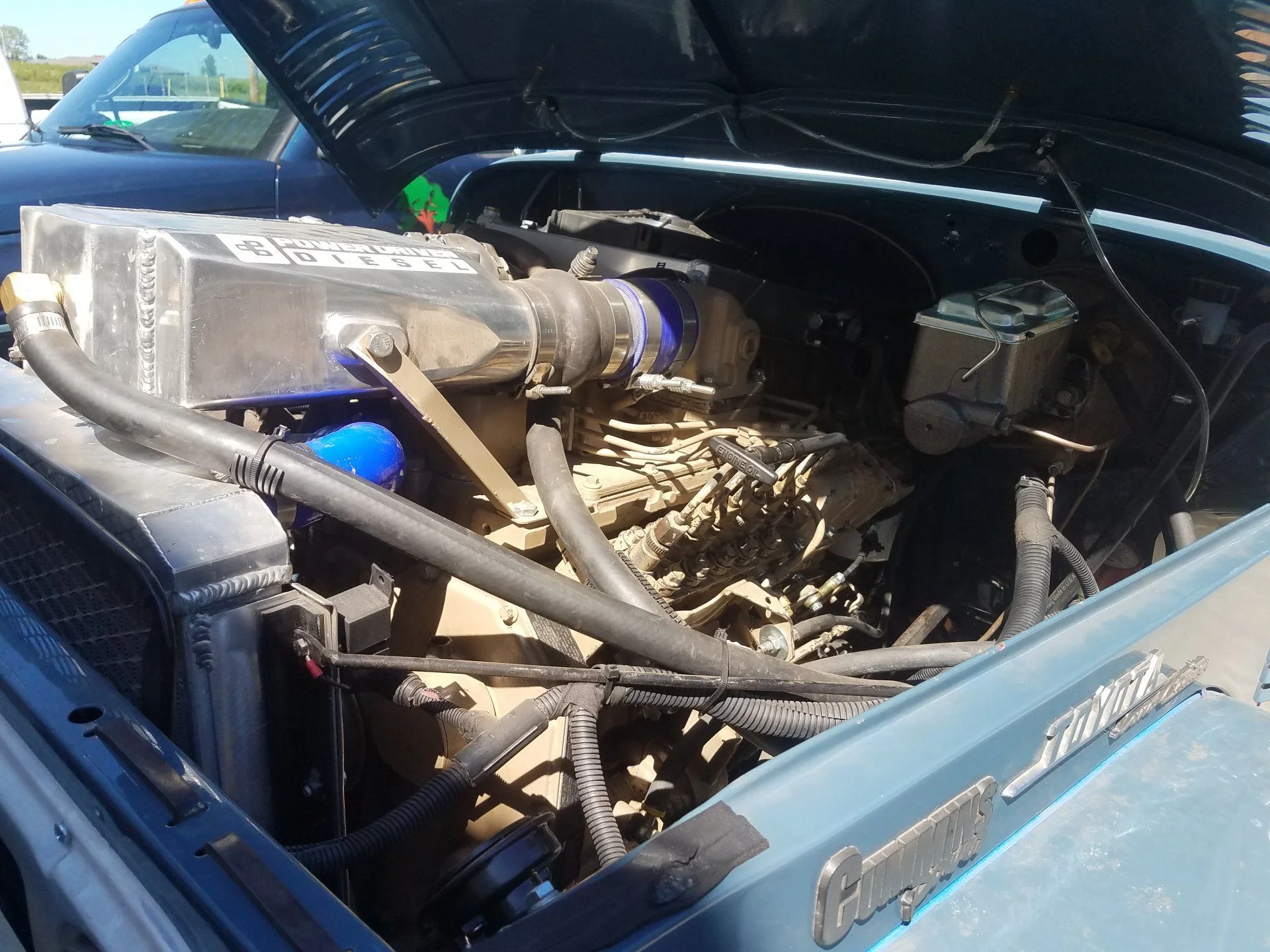

Pretty cool, I assume you have a vacuum pump for the brakes???
Yea the 6bt came with one on the LH of the engine. It connects to the power steering pump as well. I'm using a stock toyota brake booster (I'm not sure out of what) and it's adapted to a chevy master.

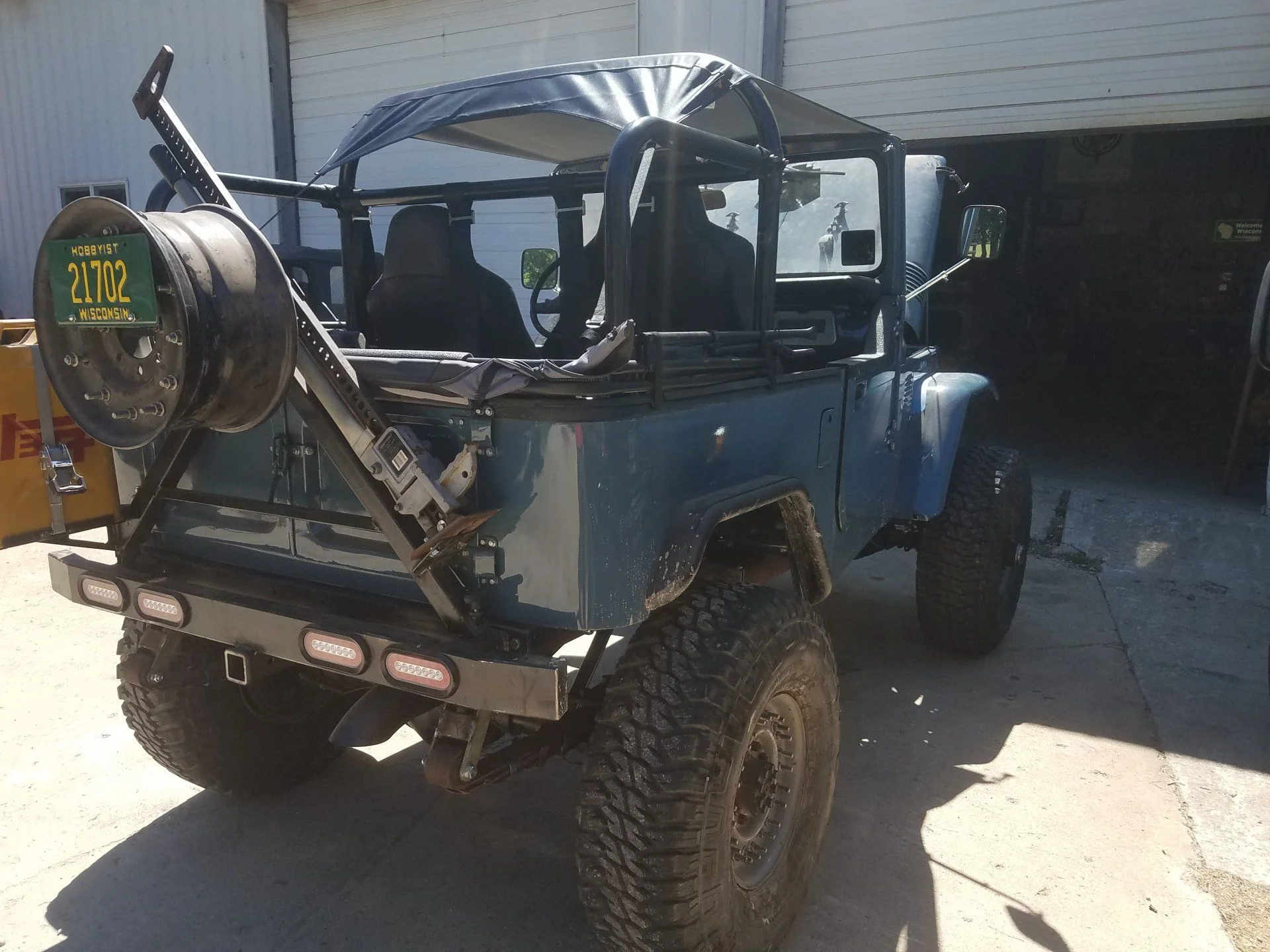

I've personally never driven a stock fj40 but... the ride quality isn't too bad. I have both the semi tractor batteries in the back which evens the weight out quite well and it should get better once I put on the spare tire. I also made the wheelbase longer. It's pretty quick for an fj, pulls hard to 70mph then I chicken out. It feels like it just wants to rip itself apart but the track bar in back keeps it in check. I boxed in the whole frame and made the roll bar integral to the frame as well which I'm sure stiffens up everything.

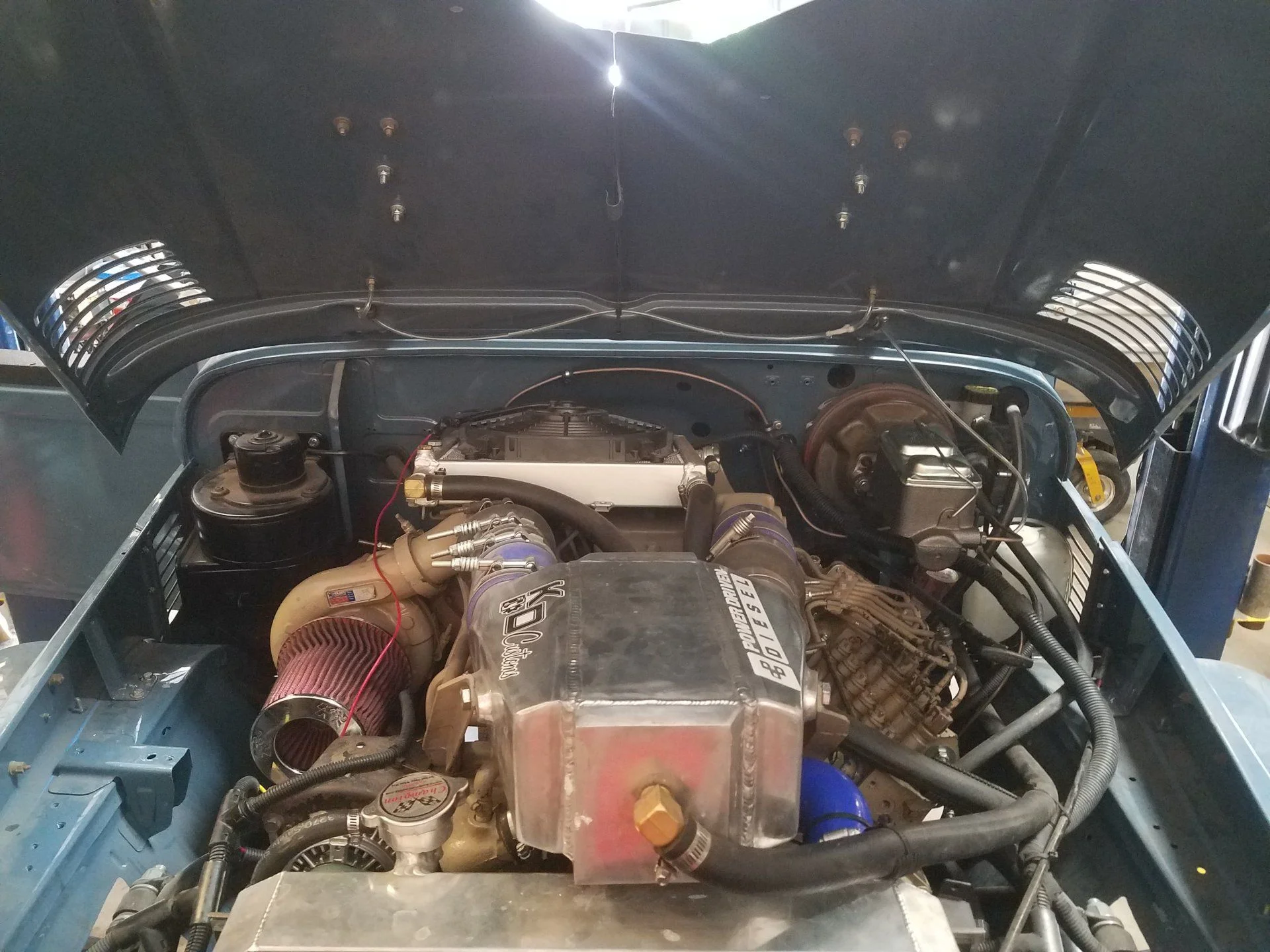

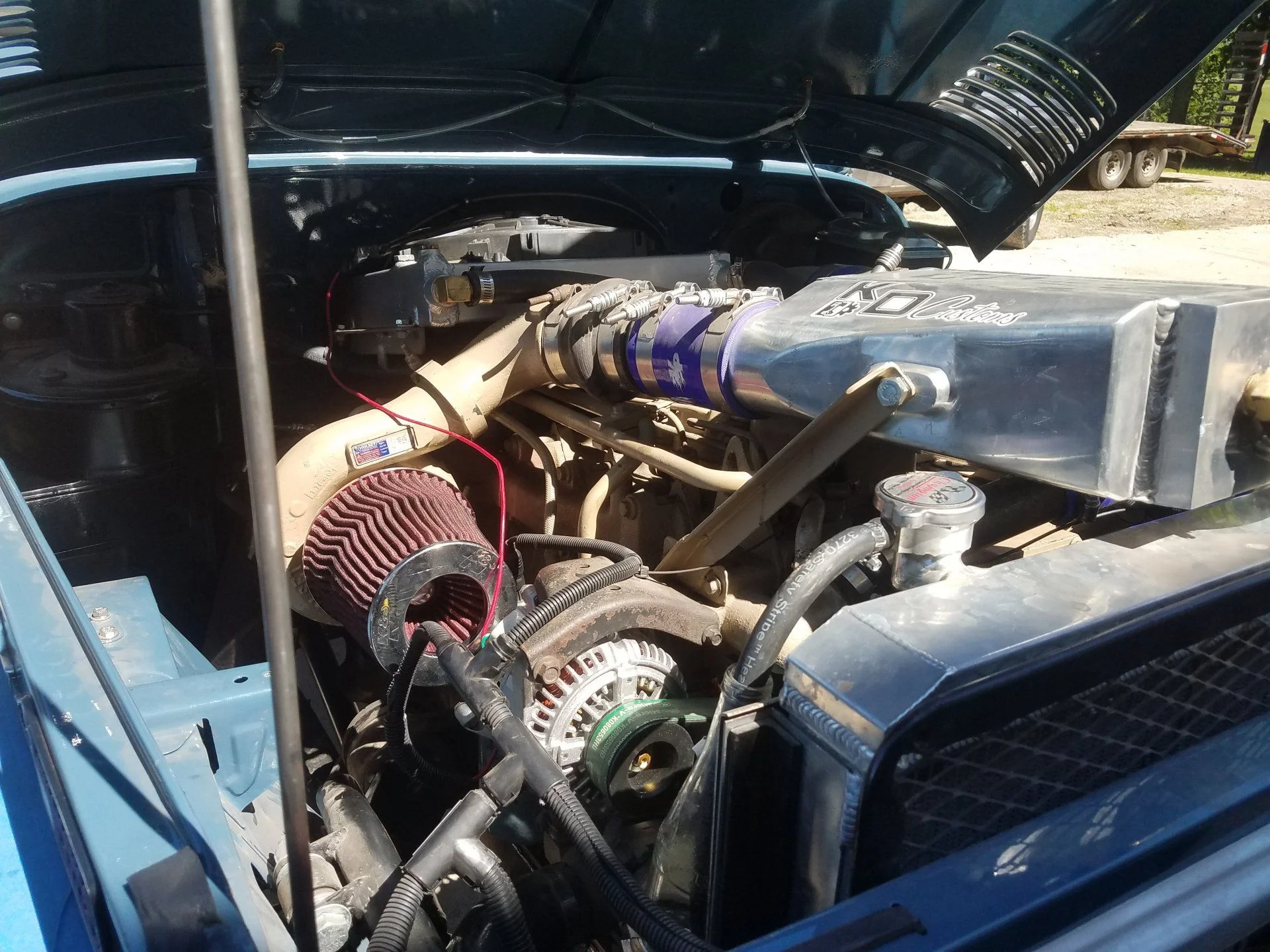

Did you have to modify the firewall much for the 6bt to fit? Would be interested in better pictures of the engine bay.
The only point which I cut into the firewall was for the exhaust manifold on the RH side. It was a very small cut and I just boxed it in.

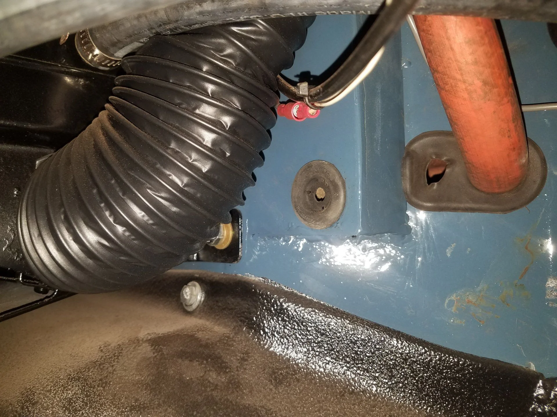

More pics and details of suspension. , frame. , engine and drivetrain

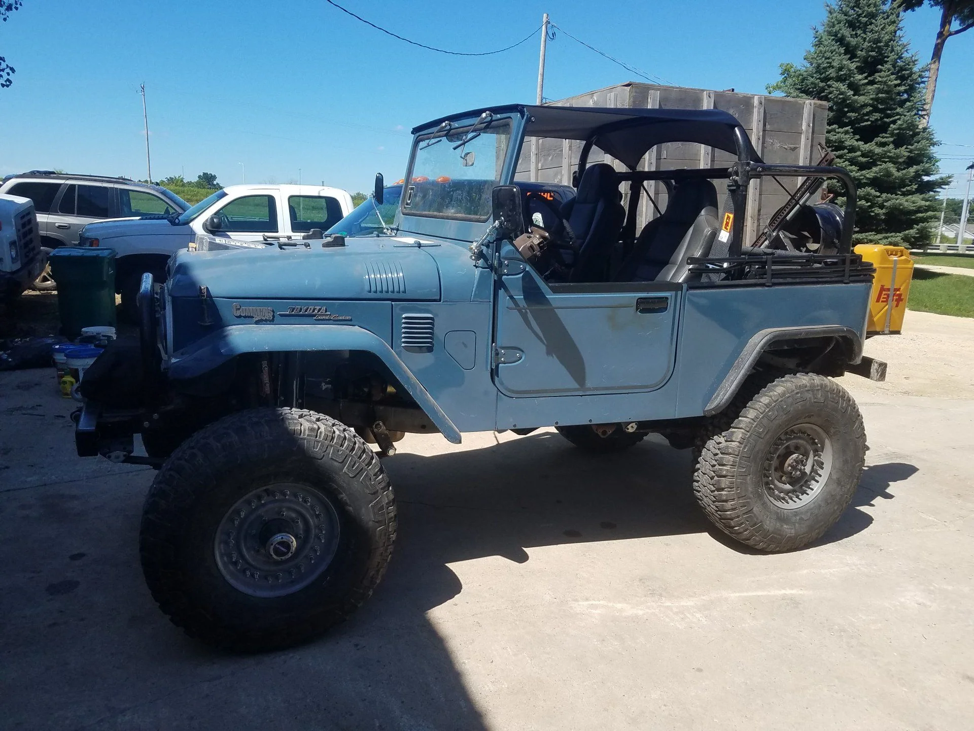

When I first took her out for the first few test runs she had pretty significant deathwobble. But I did some adjusting with the rear shackles on the front axle and took the run flats out which eliminated the problem all together.
I'm running a custom spring packs in all four corners. They're pretty much just two fj40 spring packs put together on either side to compensate for the weight. And in the back it's an fj60 spring pack that has a few added spring packs on either side.
I have a top mount steering linkage in the front with a steering box mounted on the side of the frame which I managed to plum into the dodge steering pump.
If you want any more pictures of something specific let me know. I've personally never seen a 6bt fj40 besides one (a tan fj40 bikini top with a rotary pump 12v) and there wasn't any info on it at all. All I know now is that it can be done, is it easy? Easier than I thought but still not a walk in the park.
