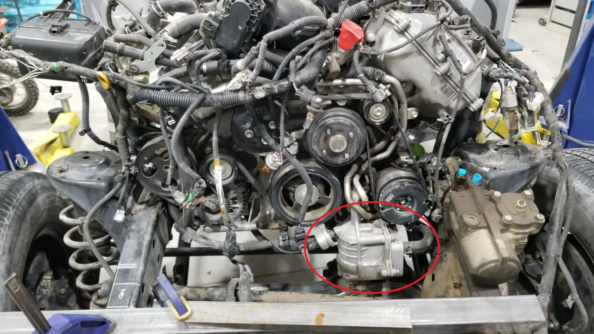

I took the front springs out and the the frame lower all they way to check clearance. The part circled in red is the oil filter/oil cooler/pressure relief valve. It did make contact with the front diff at full bump, so I knew I had to relocate it.
I thought about going with an aftermarket oil filter relocation kit, but I couldn't find one with a pressure relief valve build in, and I liked the idea of the OEM oil cooler, so I just decided to move this one.

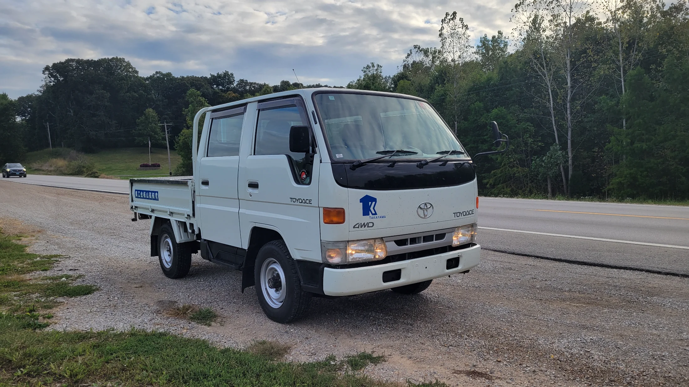

Also picked up a new daily driver last week. It was quite the adventure! Flew to Indianapolis IN and drove it all the way home. Ended up being about 30 hours of drive time.
1997 Toyota Toyoace
4x4
AC
5 Speed
Diesel 2.8L
Fits right in, and even the right color! It will get some light mods. Already got the windows tinted, and a few other small things.
