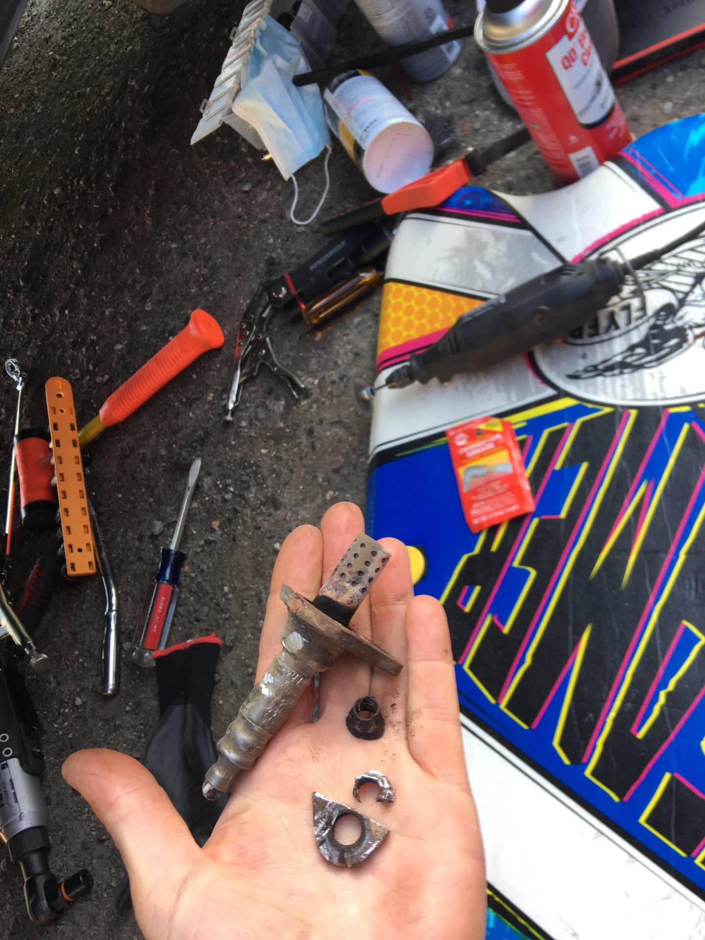

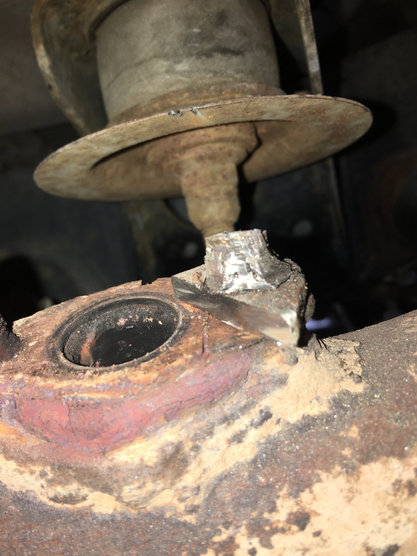

Looking for some advice on how to deal with a couple of rounded and stuck nuts. I need to replace the rear O2 sensor on a '97 and I can't break the nuts loose. Someone in the past rounded rounded them. I've tried an 11, 12 mm and 7/16 socket and none fit well enough. The 12 is too loose while the 11 and 7/16 just won't go on. I attempted to drive an 11 onto a nut but there's not enough space to swing a hammer. My final attempt was to sacrifice the shield to get vice grips on a nut. That worked but the nut tightness exceeded the grip of the vice grips.
At this point I'm looking at a nut splitter or Irwin bolt-grip extractors. Any guidance as to what may work well in this situation?

Mine were rusted and cone shaped, could not see a flat surface only round. A short pair of need nose vise grips worked well. Had to beat on them a bit (as well as a few magical words so no children please).
I just went down this road last week. I too had rusty nuts when replacing the O2 sensors. Go to the Home Dept and get the Irwin Bolt off tool kit, its $19. They fit on a ratchet and easily get the job done in the tight confines between the exhaust and body.

I tried (in this order): PBBlaster, sockets, wrenches, chisels, blowtorches, vice grips, a dremmel, more blowtorching, more chiselling, more vice gripping, and finally after taking a three-week breather because I was so pissed, got it off by spraying it with PBBlaster one more time, waiting ten minutes and then it just threaded off by hand.
make sure to get the correct ones when replacing them too after you get the old ones off. The studs/nuts on the exhaust should be 8x1.25 thread
If everything mentioned above fails, you can always cut the plate in two with a dremel and spin the plate with vise grips.
