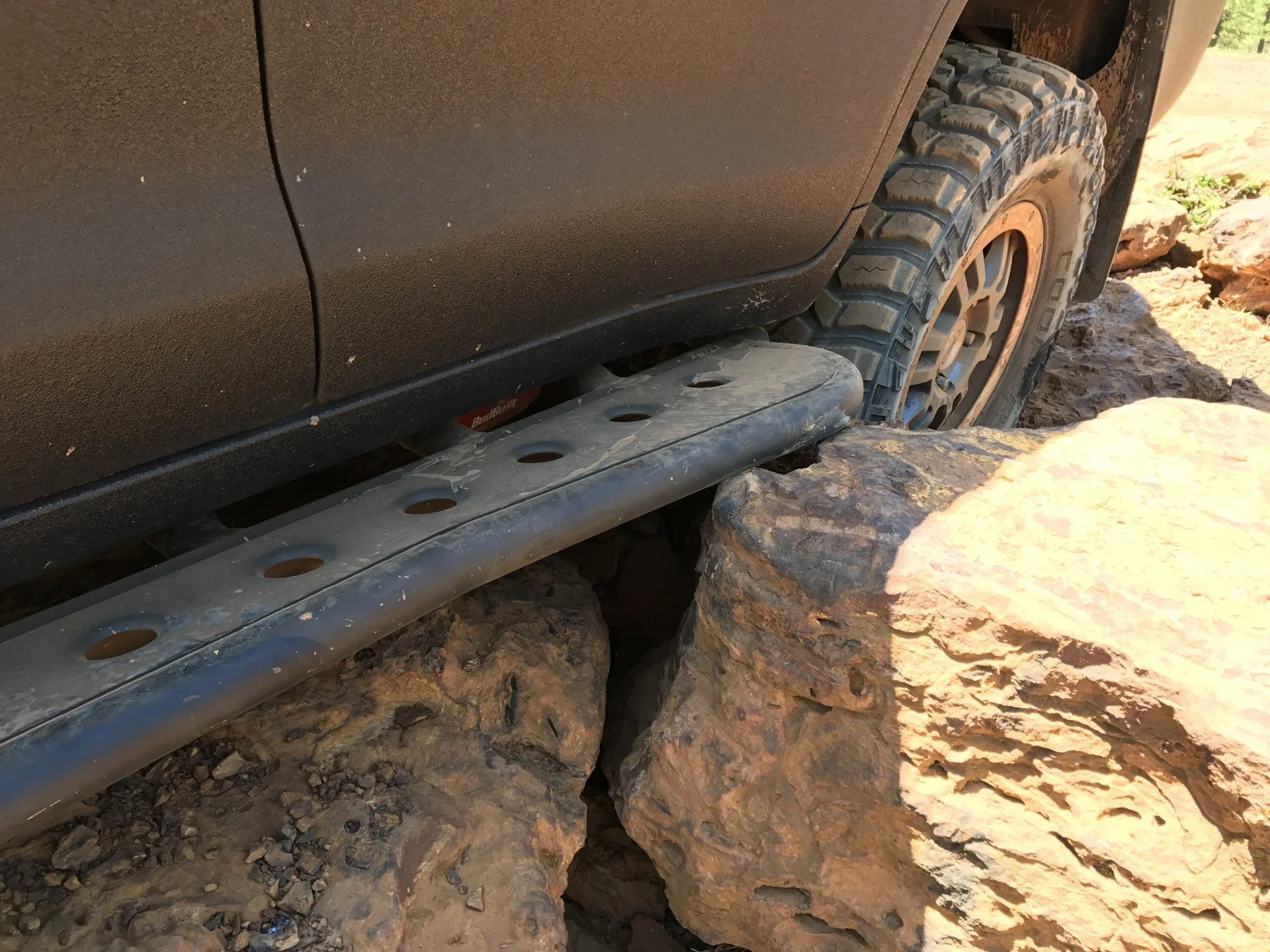

Bud's sliders are more than capable of lifting the whole truck and distributing the load over a much wider surface area than any other slider. I change my front tires by lifting with a hi lift jack on the front edge of the slider, it does absolutely nothing to the truck or the slider. These things are built to be beat like they owe you money, and keep your frame and body nice and safe.
He uses 6 frame to main tube legs in a different configuration, and those legs go much further to the ends of the main tube than any other slider in the industry. The outer tube is much stringer than required to handle hard rock impacts over and over with an incredibly small about of deflection.
That's a still image from a video where I was trying to bend the sliders. Couldn't even get a dent, if you are a rock crawler, definitely upgrade to .120 DOM, and if you want the one with a lifetime warranty, .188 DOM ultimate rock sliders are available , you won't destroy them.
Also, we lifted the whole truck by just the sliders in the lift, deflection is so minimal, it's just awesome. Frame was laser checked and was the same as before we did it.

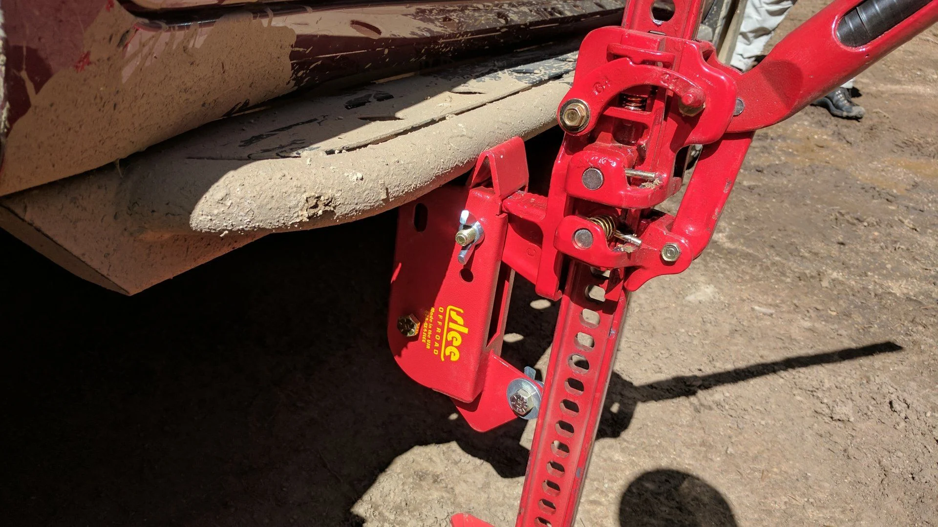

Will the outer tube of the rock sliders support lifting from a Hi Lift jack? is there a bracket or platform Bud makes to secure the jack?
I have heard of this being done but have not seen the end results or whats left of the tube or attach points when the load is applied so far away from the frame.
I have used Slee's jackoff adapter for use with a Hi-Lift. Should be compatible with Bud's sliders too, perhaps Taco can verify?
Slee - Recovery Gear
With BudBuilt Step sliders yes, but maybe not with the rock sliders with a full fill plate (rock sliders with partial or no fill plates will work). The rock sliders are on a pretty significant upward angle, which might make the fill plate run into the outer upward triangle of that adapter.
Now not to try and make excuses, but, you don't need any adapter for a hi-lift on a rock slider. Put the arm under the outer tube, no further out than the middle of the arm, and push the base toward the center of the truck as far as it will angle while still sitting the base completely flat on the ground. That angle gives you the straitest possible angle once the vehicle lifts one side off the ground.
When jacking, you kneel below and to the side of the handle, and pull down (not standing and pushing down), that keeps the jack from rotating and keeps you safe from the jack handle coming back up.
All that said, a hi-lift is the most dangerous tool out there, mine has been limited to my garage for over a decade, much better jacking, and winching devices out there these days.
