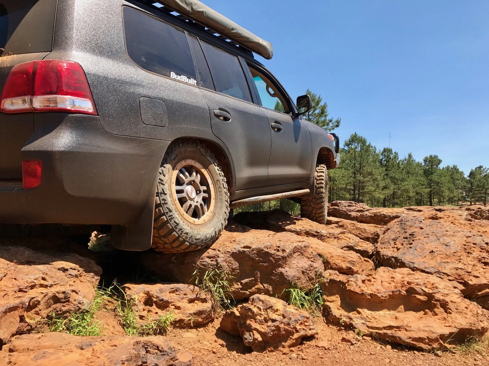

Right. You obviously don't want the sliders so close that they can flex into the body or so high that you can't open the door. I'm just curious if 20* is the angle where that starts happening, because from pics of @Taco2Cruiser 's truck that doesn't seem to be the case.
I know what you mean, from some angles they look like they could go higher. In fact I even mentioned that to Bud when I first saw them.
But the real angle interference is the rear of the rocker panel when angling up for rock sliders. The doors will never be the issue on a 200 because of the frame/body design. (Ever wonder why 200 Series door sills are lower than the footwell? It's because unlike every other car on the road, the frame is already tucked as high up into the body as possible. Next time you look at a wrangler, look at how much frame hangs below the rockers, then look at even Tacoma/4runners. The 200 was much better engineered from the get go to tuck stuff up high)
Back to rock sliders. While the main tube is about 3/4" to the body, anything less than 1/2" could deflect into the rocker. It doesn't matter how good you make the mounting design, even though BudBuilts are the most robust mounting design in the industry, and it's easy to see why. Running the main tube closer is doing to allow contact. So with that main tube where is needs to be for hard rock crawling, angling up to the max, but allowing for another 3/4" clearance to the side of the rocker came out to the angle it is.
You could make it angle further. Just some cuttting of the rocker panel cover, not the rocker itself could yield a few more degrees. But figured most people don't want to modify their trucks and just bolt on. Which is why his slider are no-drill, 100% bolt on.
Just like the upcoming rear bumper, that has both a 100% bolt on version, and a "not for the faint of heart" frame cutting version that really bumps up the clearance. And that is in 2 versions. Cut off some meaningless metal tabs that don't do anything structurally and just help with the plastic bumper cover, and version that is full blown frame cutting and welding that gives significant departure improvement. So maybe a small cutting for more clearance version could happen in the slider department in the future.
I think this picture shows best the angle can't go any higher, and safely maintain body clearance when falling off trail ledges and slamming into the outer tube. Notice the very back of the rocker panel and the outer tube clearance.
With that design, yeah I see what you mean. My Trail Tailors come straight out from the frame then angle up once it's past the rocker, in which case any more angle would interfere with the door as opposed to rocker.
Exactly. Trail Taylor is using longer legs and going less ground clearance under the main tube, but then that design could allow for them much higher outer tub angles.
Bud choose to keep the main tube as high as possible but also not go past the seam, and start angling up the outer tube sooner. Plus with the 6 leg design Bud does, the rear leg, which is behind the rear lower control arm bracket and second to the rear leg is ontop of the rear lower control arm bracket (yea, take that deflection!) makes it to where in Buds design, if you got the main tube out past the weld seam, then too much ground clearance was lost, and unnecessary hang ups start happening.
Got my sliders on order the other day! Essentially what @Taco2Cruiser is running in these photos. I have an irrational fear of crushing rocker panels.... Still working on that with my therapist!:coffee:
