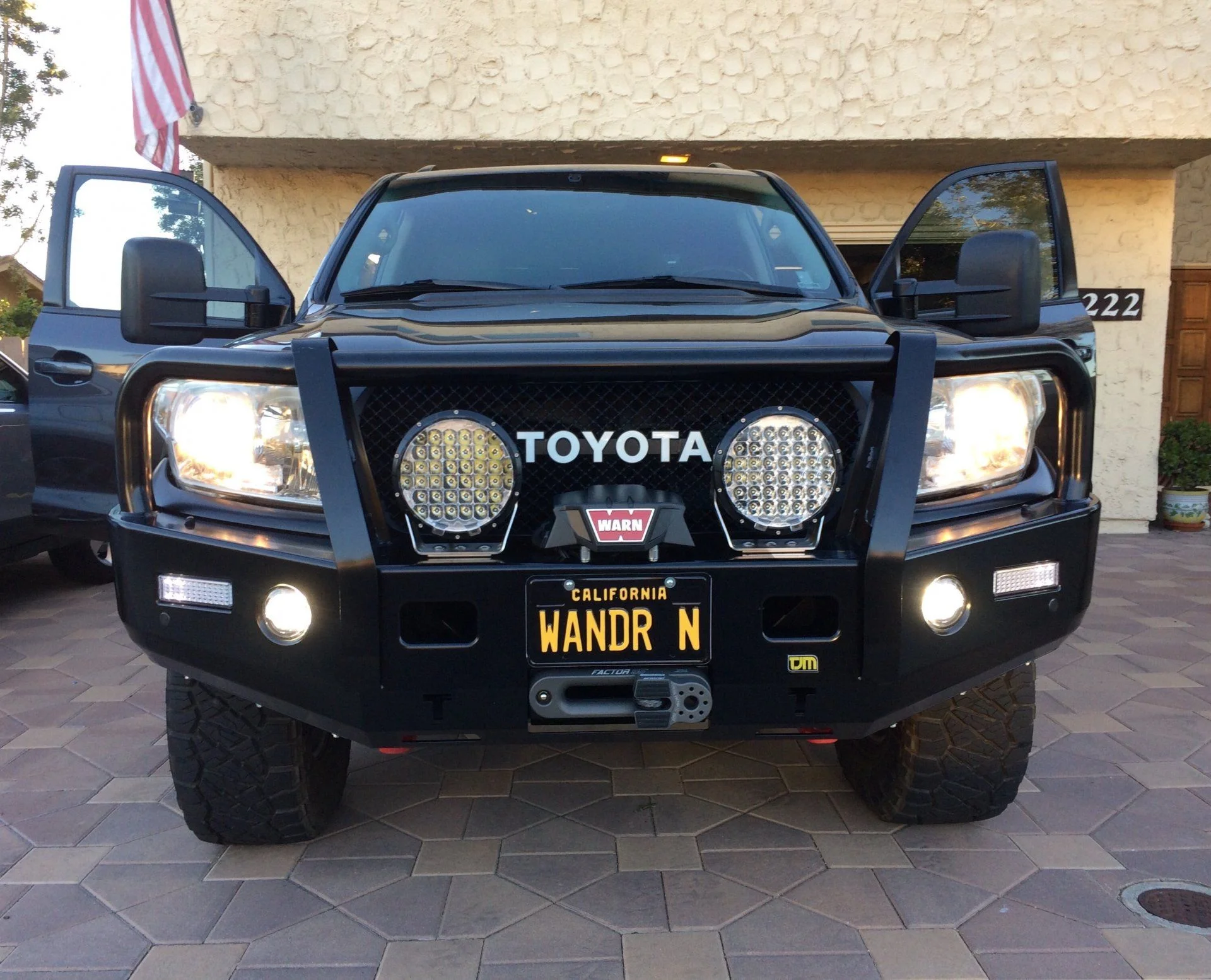

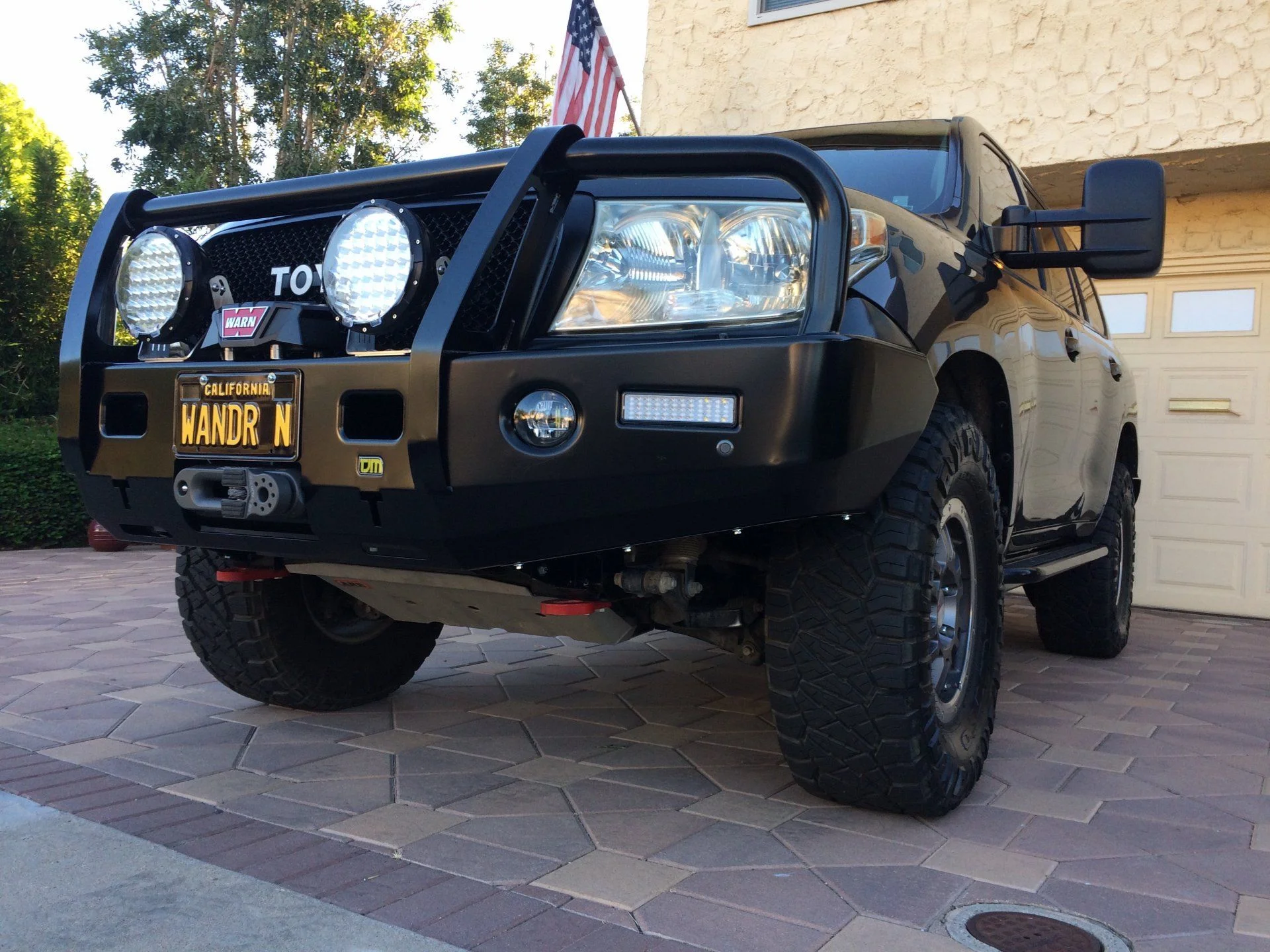

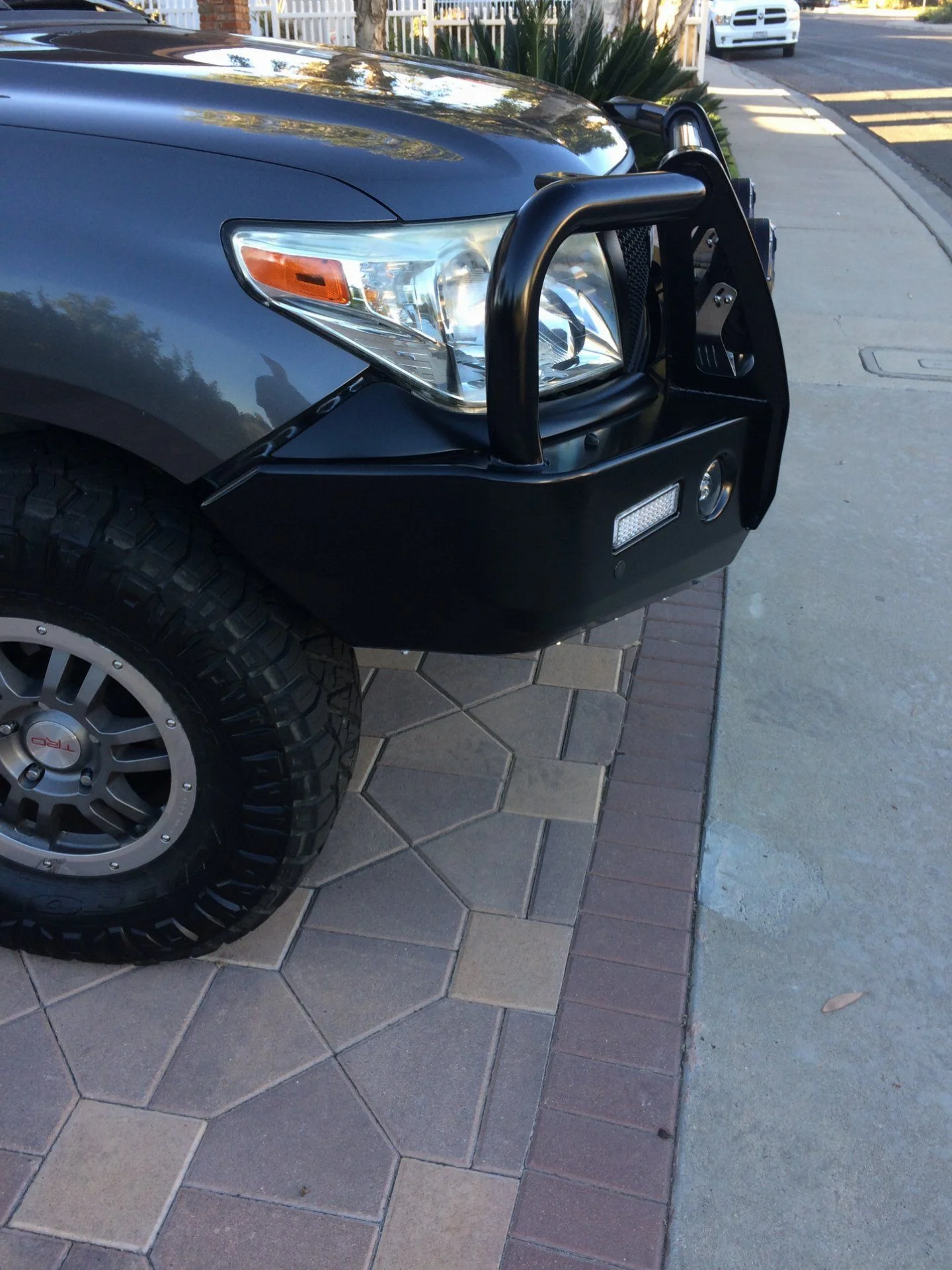

For those asking for front bumper extension side-shot... The TJM T13 is pretty compact in front for a full bull bar:

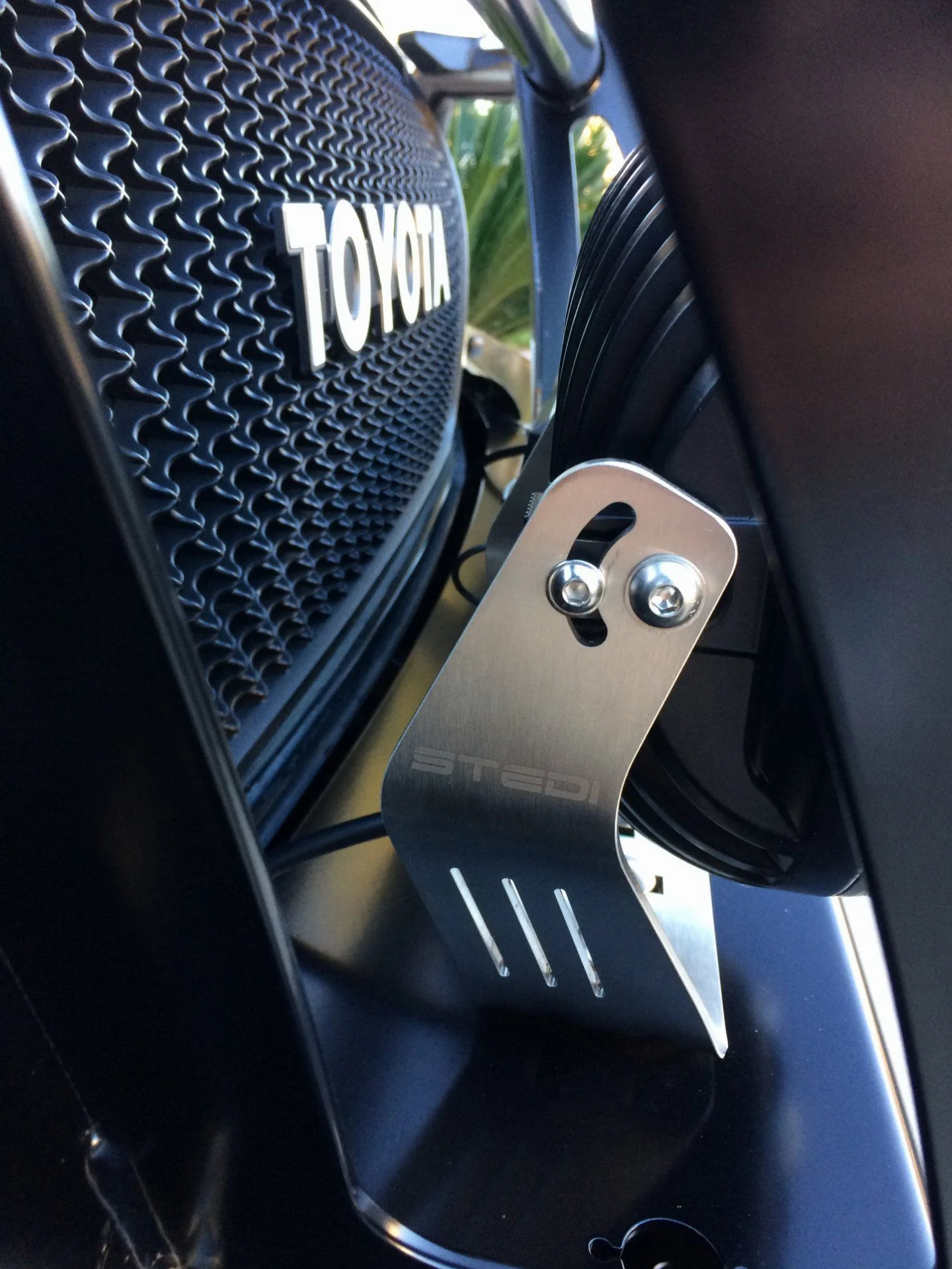

Here's a shot of the Type-X Driving Lights from Stedi in Australia. These are both combination spot and flood. Very happy with them...$600 shipped, complete with wiring and switching to tie to your brights when you activate an included switch. Here's a shot the the VERY stout mounts that come with them:
Few more Stedi shots:

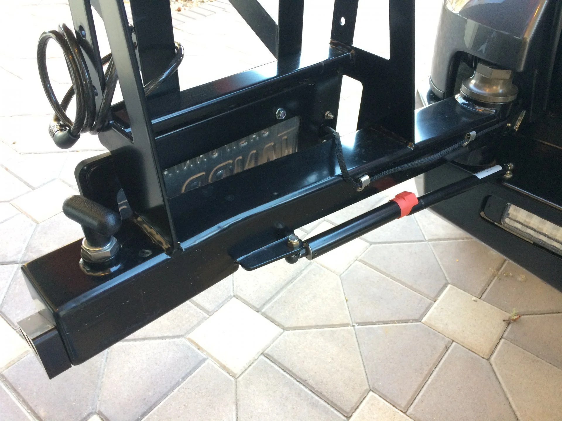

Some Slee Bumper Detail:
Locking struts hold arms open:
View of struts when closed:

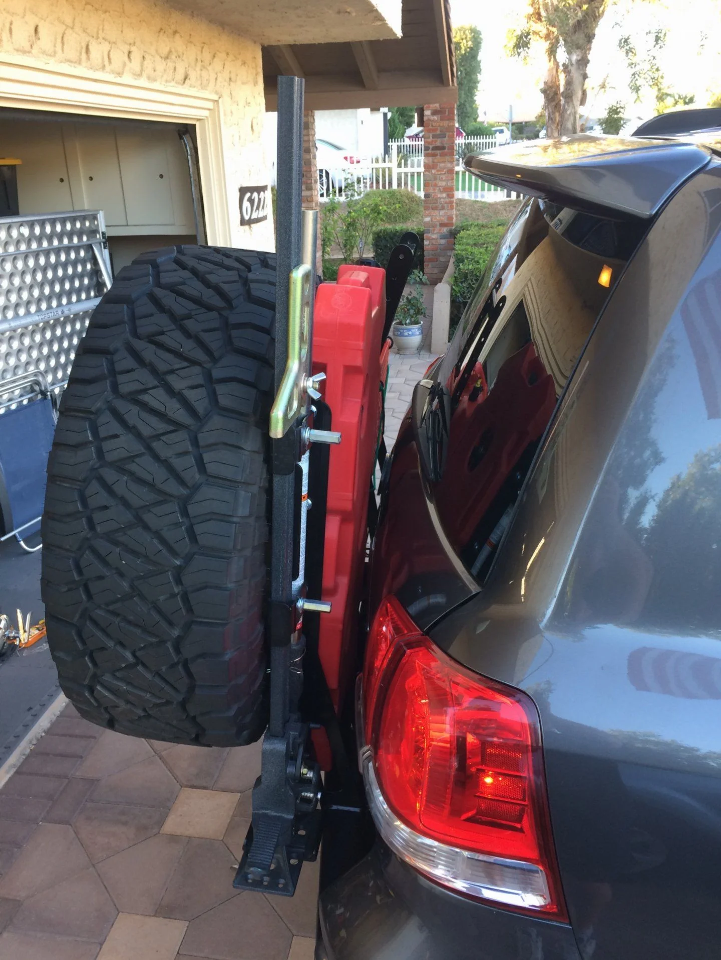

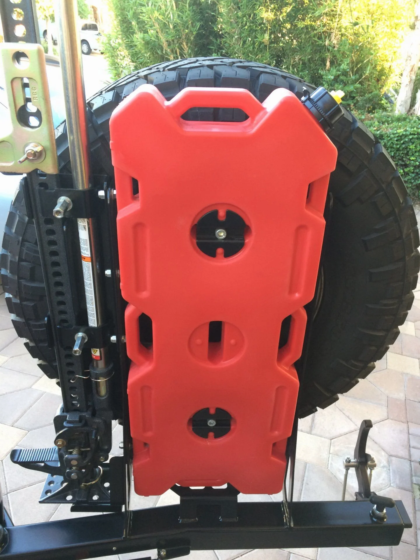

Heavy accessories kept as close to the hatch as possible:
Nicely Tucked when closed...almost zero movement over rough terrain:

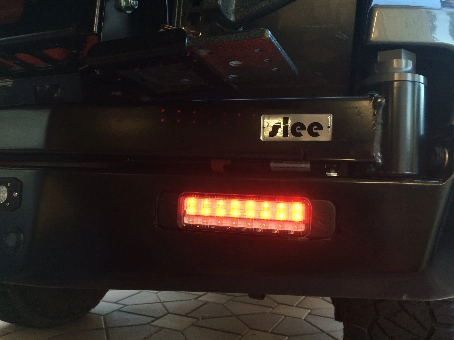

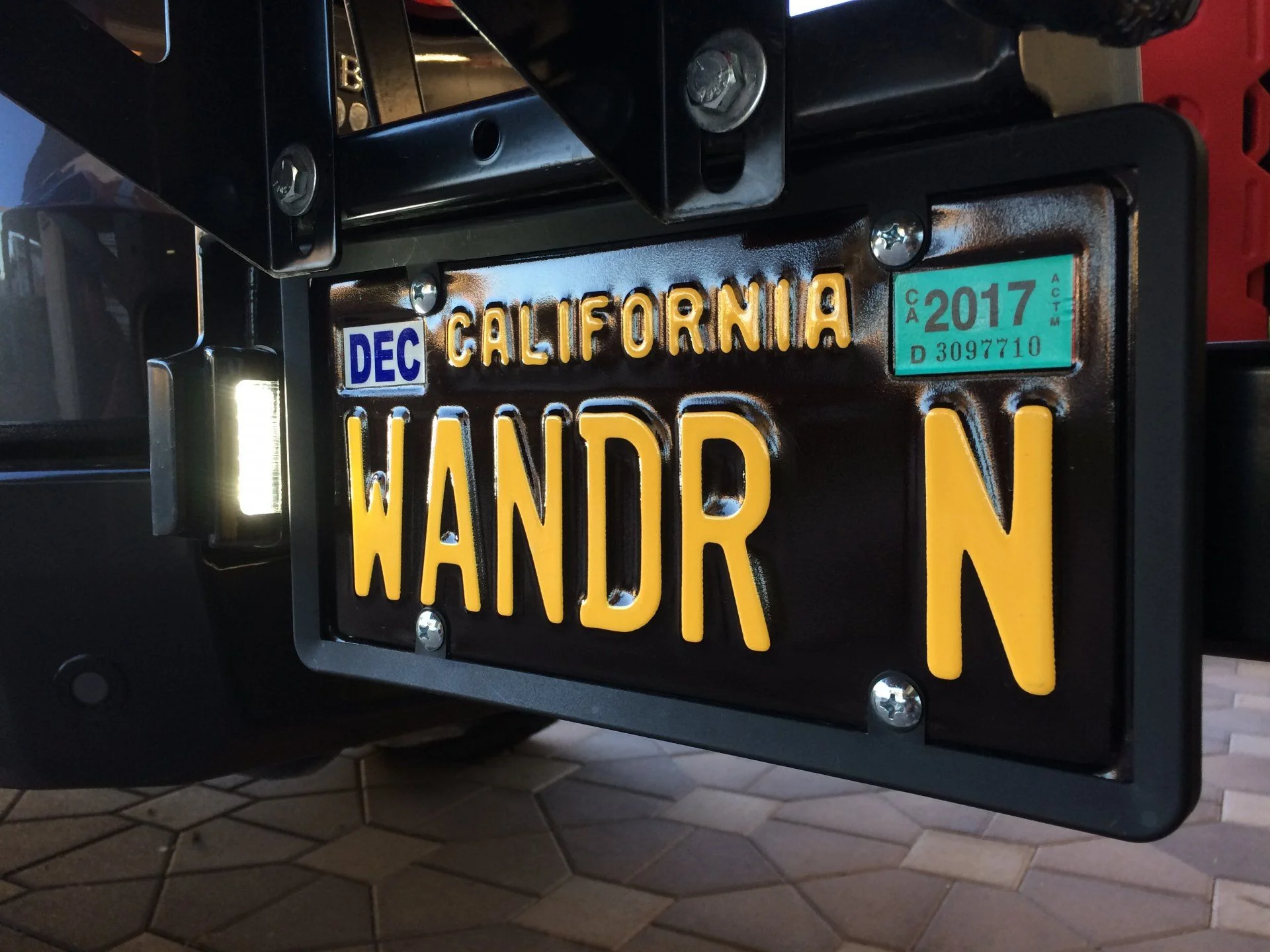

License Plate illumination swings with left arm:

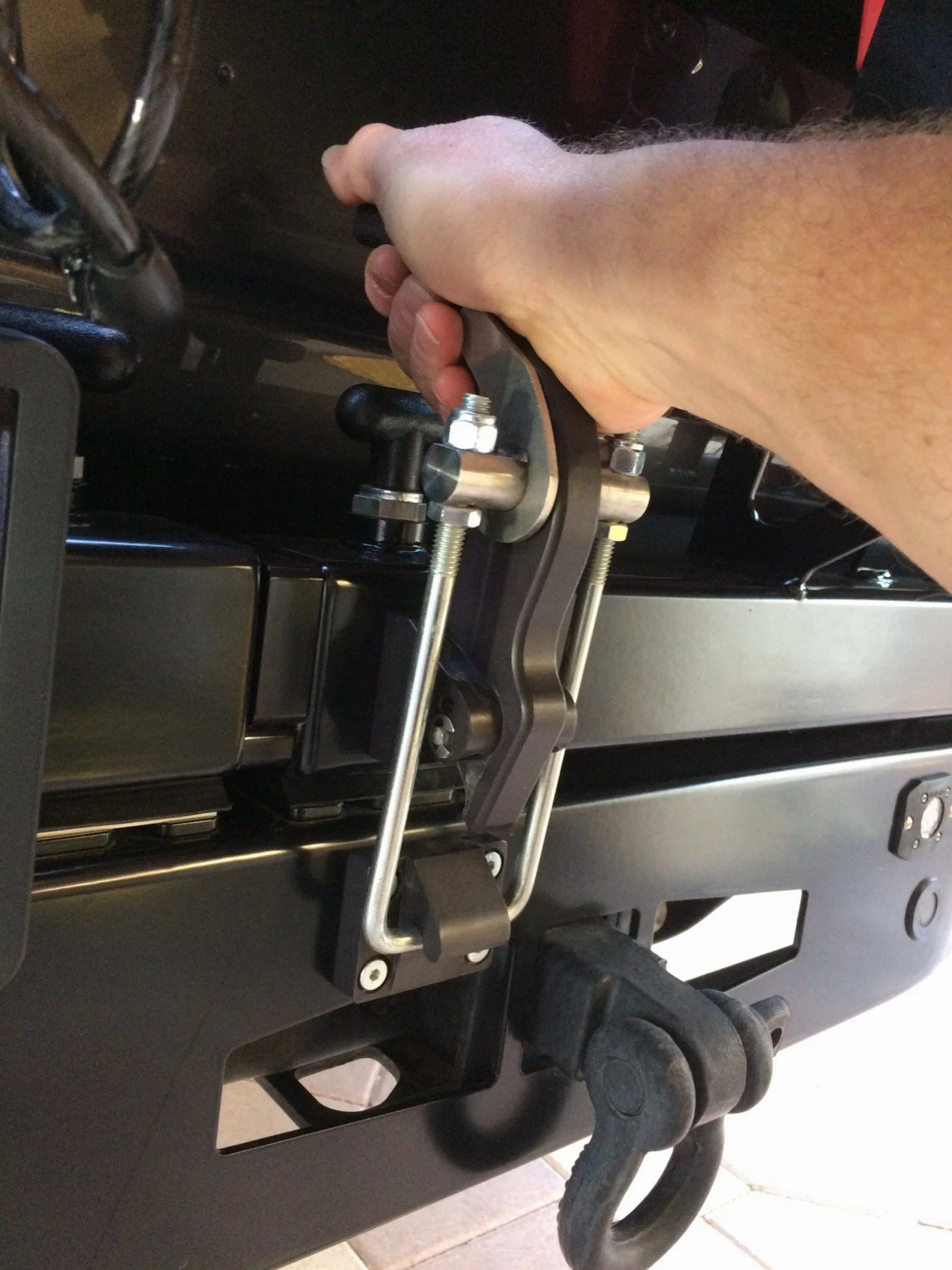

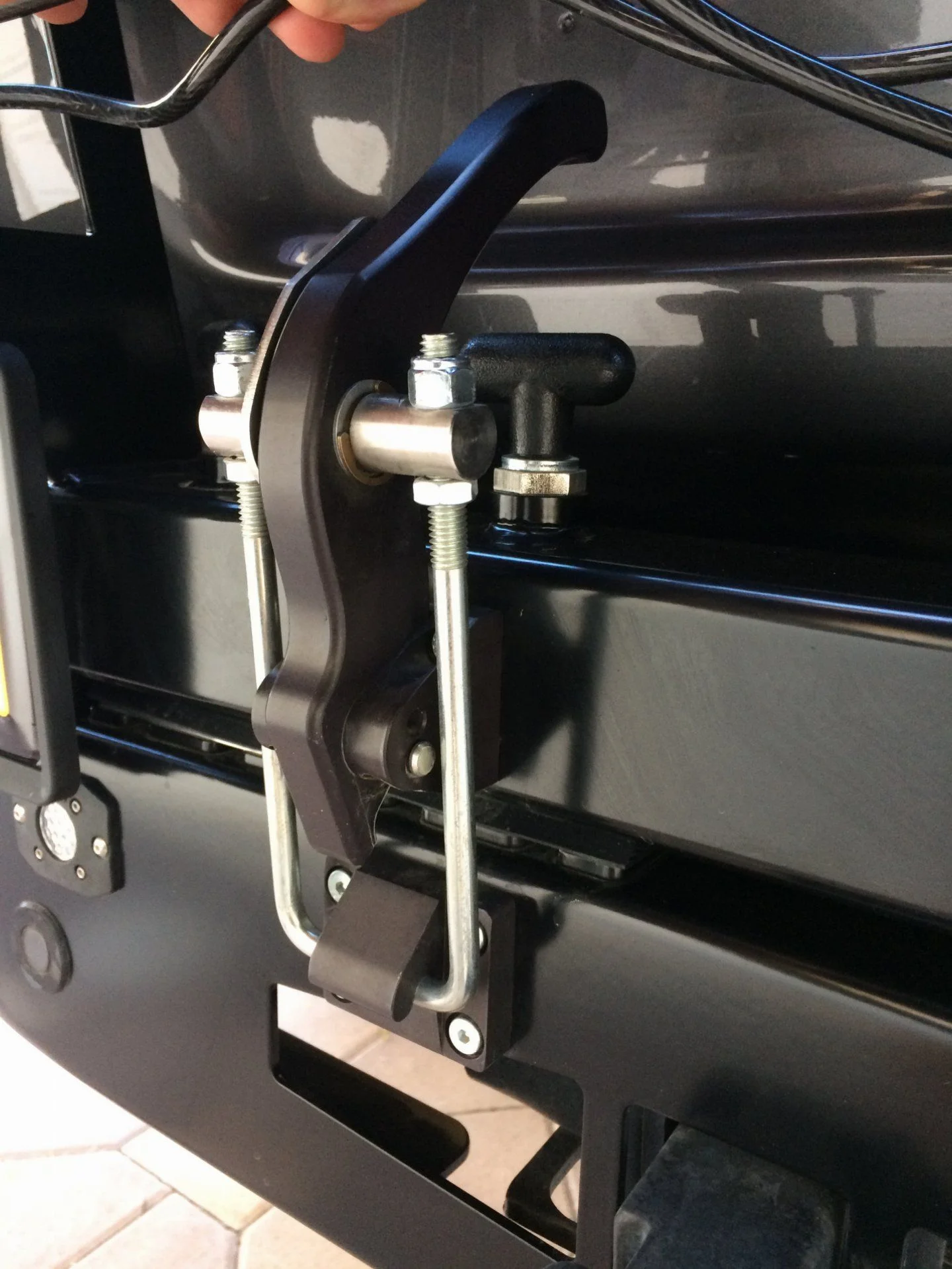

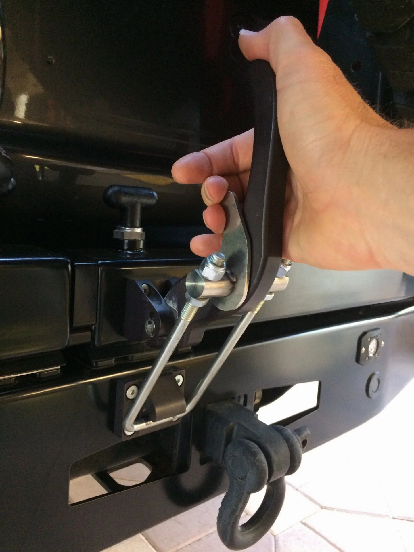

Custom lock-lever design is fantastic, and easy on the wrist (note angled handle, vs. standard upright handles on most bumpers)...
To close, a handy lever is added so that you can flip the hook upward with the same hand as you grab the main handle:
With the hook now engaged, you just push, and it's locked:

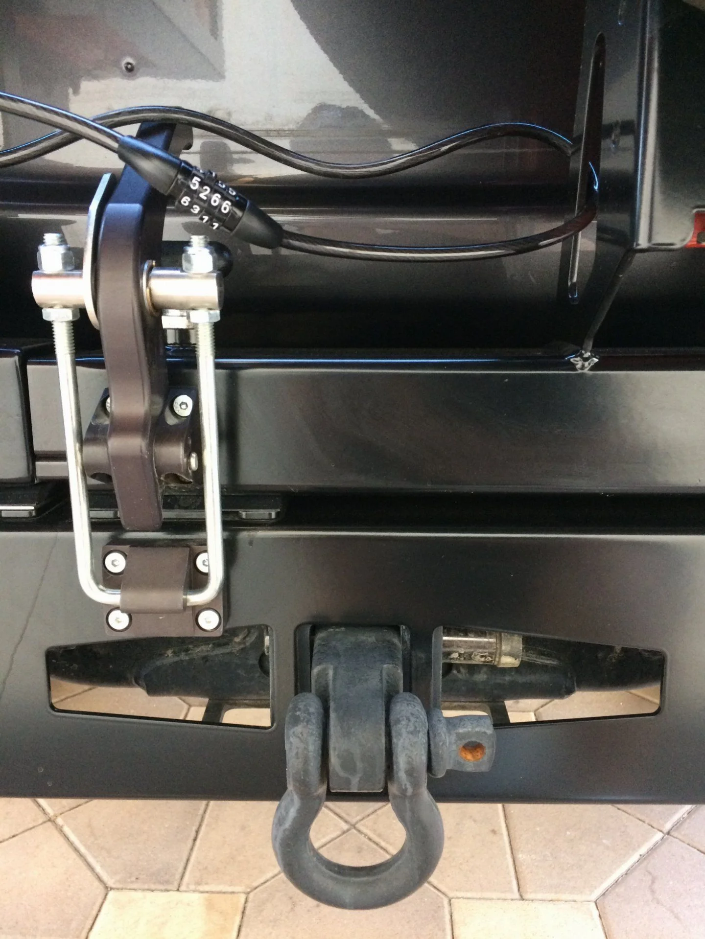

When turning in for service, or just for assurance no one messes with it while away for long periods, I simply wrap a bike lock between each arm...making it impossible to open, and also impossible to open my hatch, drawers, etc. Want added security? Add a bigger lock/cable.

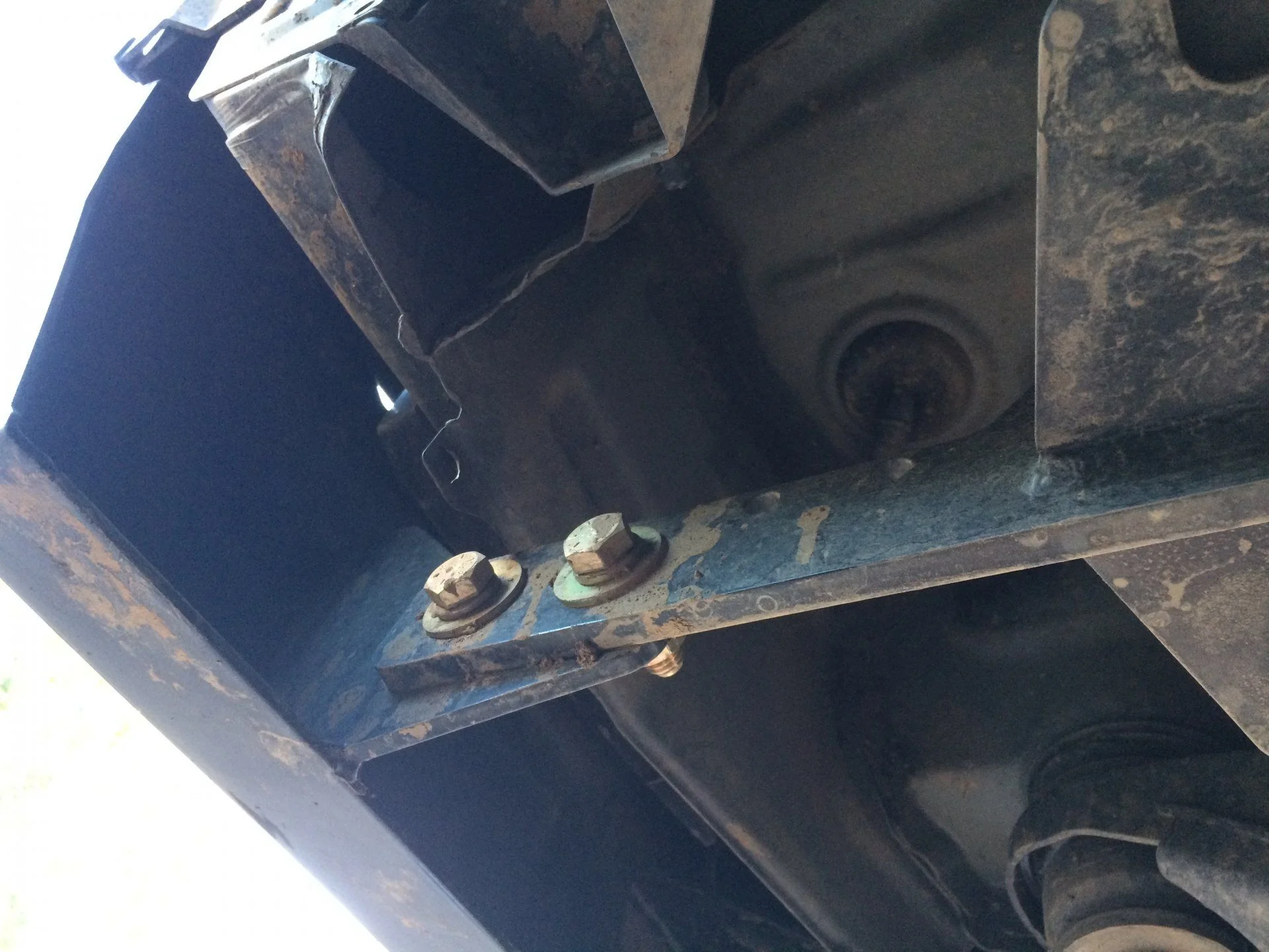

Wing braces are FAR more stout than some standard offerings I've seen. Serious thickness here. Hard to appreciate until you compare directly with some others:

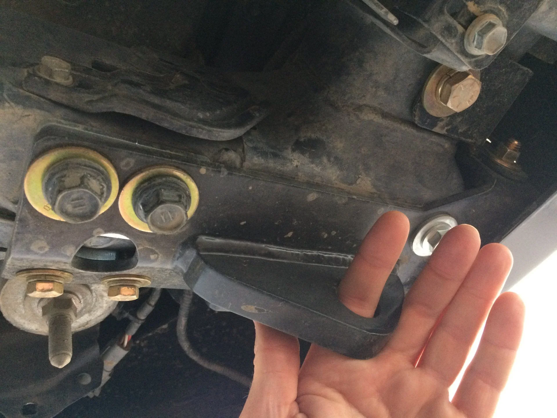

Also notice the rear recovery point replacements:
